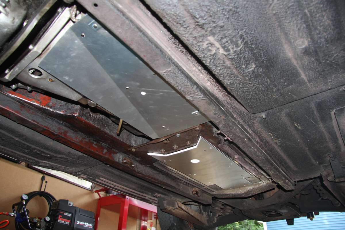

Make sure you have blanked off all the holes in the bulkhead. Also, the seal between the gearbox tunnel cover and body is crucial. It will let in huge amounts of heat if it isn't sealed. Make sure you have the heat defelctors fitted under the car. There is a lot you can do to help reduce heat.

Post by Bfastr » Thu Mar 28, 2019 4:32 pm
I second what Angus says, look around the openings where the AC hoses come into the cabin, pack them with something, anything to block heat. and then make sure this front deflector is there, mine was missing and after putting one back on it made a big difference. The exhaust is off in this photo, but you can get the front deflector in there if the pipes are on. with some patience and maneuvering.
