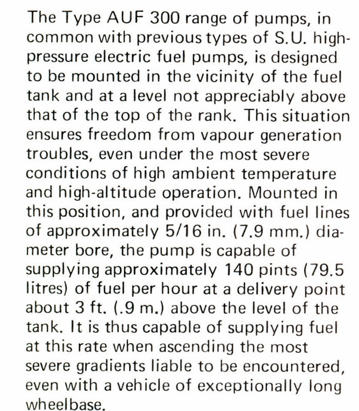

Post by Heuer » Tue Apr 16, 2019 1:13 pm
From the SU publication 'SU Carburetters Tuning Tips & Techniques':

Post by PeterCrespin » Tue Apr 16, 2019 1:40 pm
“..previous types of S.U. high pressure electric fuel pumps..” ???
I’ve never seen any pumps lower than SUs. Even American carb fuel pumps tend to be a pound or so higher.

Post by Heuer » Tue Apr 16, 2019 6:04 pm
1. The SU pumps run at a pressure of 4 psi or more (I measured 3.8 psi on my car)
2. The SU carbs require a pressure of 2.5 psi to work correctly
3. High pressure can cause the carbs to leak, increase fuel consumption and overly rich running at idle
4. The Filter King allows owners to easily adjust the fuel pressure delivered to the SU's
5. If you are happy to run your car with 50% over pressure then leave things as stock although there is the potential for problems to develop sooner than they might
6. It is just an option but many of us find it worthwhile as it removes a potential problem source when diagnosing issues
