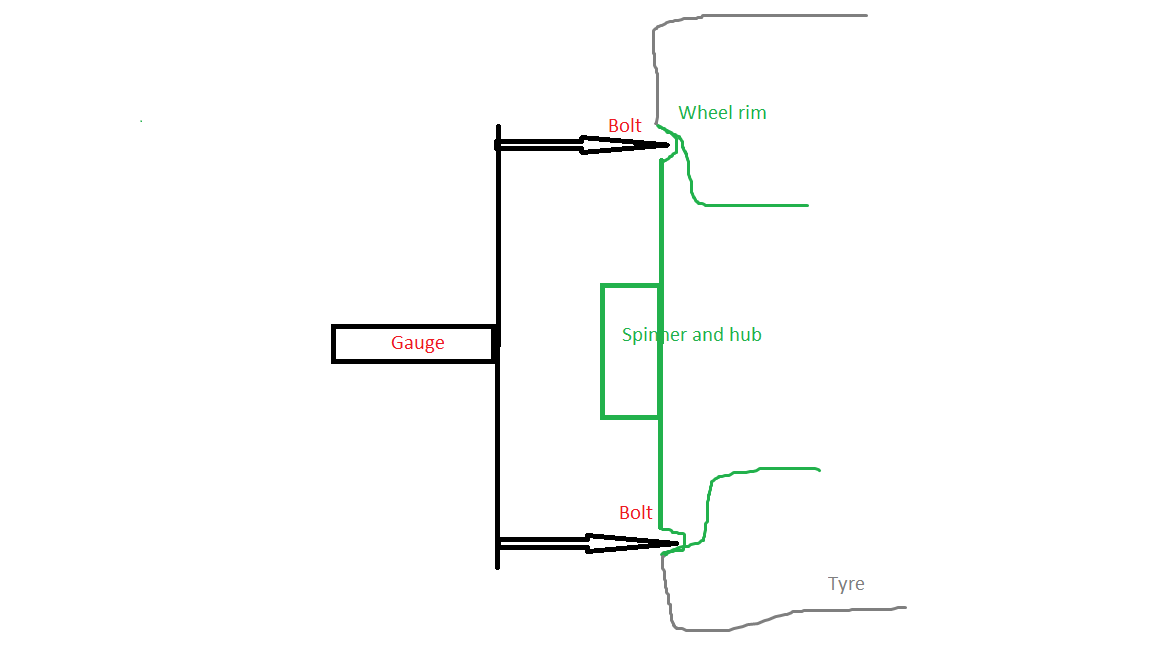

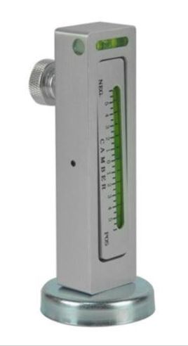

1. Buy one of these.
2. Using a piece of aluminium angle and a couple of fully threaded 15cm bolts with nuts, make a bracket to allow you to position the gauge accurately on the wheel. The bolt ends go in the groove for the wheel weights. Obviously make sure that the top and bottom bolts are exactly the same length and that the angle goes through the radius of the wheel. I have turned a point on my bolts. Remove the magnet from the gauge and bolt the gauge exactly between your two bolt holes so it sits exacttly over the centre of the hub and spinner.

I just bought the Gunson version - there are lots of 13 Euro chinese ones on ebay, I am not sure how precise they are. The first to look a bit better is Asta A-mcg, but this costs the same as the gunson „used as new from amazon“ version I bought, 31 Euros. Normally, the gunson one is 50 Euros.
So, lets see what I bought, and I‘ll try it the way you described.

Ok I made this today:
The bolts are a bit tipped on the end. I got an amazing result: 3 of 4 wheels are 0 or max 1 deg. Rear right is a tad flat tyre-wise, and is 3 or 4 degs, I have to take out one shim on the driveshaft. But I just went along after making it, so I have to do a real measurement afternoon soon.
Carsten
Carsten
#7 Re: How to set camber, caster and toe-in DIY ?
Looks good!

I now had a look at the values for camber for example - and it is very small. Like 1/4 deg positive with + - 1/2 as „error“.
Hence, is the Gunson gauge precise enough ? All I think I can set is „lower end between 0 and 1“, and leave it.
Carsten
Carsten
#10 Re: How to set camber, caster and toe-in DIY ?
I'm using the same gauge and it's more than accurate enough.
