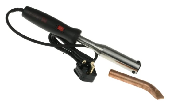

Cordless butane soldering iron should work although you might be better with using a small blow torch.
But if you cannot use a naked flame you could try a 300w electric soldering iron:
https://uk.rs-online.com/web/p/products/7719524/
