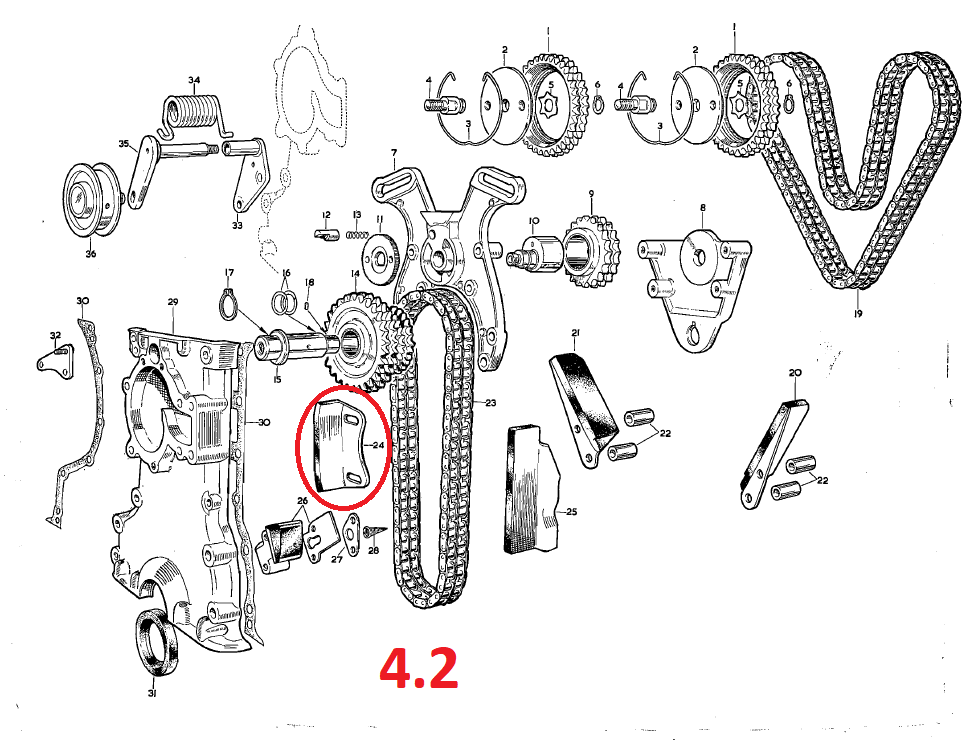

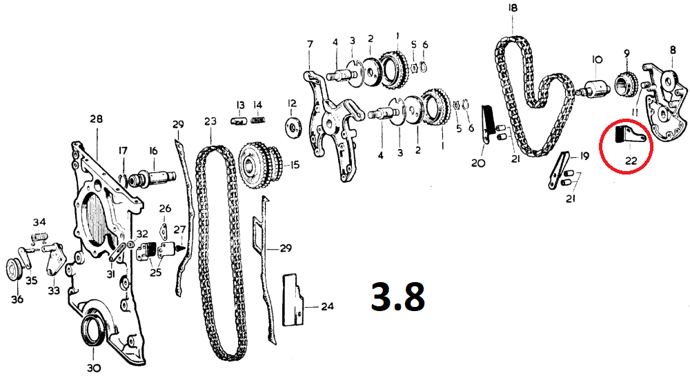

There are 2 different intermediate dampers used on the 3.8 and the 4.2 engines:
Is there any advantage of the 4.2 setup??
I am in the middle of my rebuild and I realized that my 3.8 engine must have been modified by the PO to suit the 4.2 damper. This means I can mount either one.
Any advice?

I actually called him yesterday.
The 4.2 setup is slightly better due to the size and position, however he also mentioned there is nothing wrong with the old design, provided the bend in the damper is strengthened by a pressed reinforcement.
