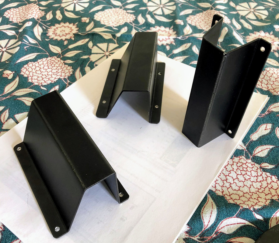

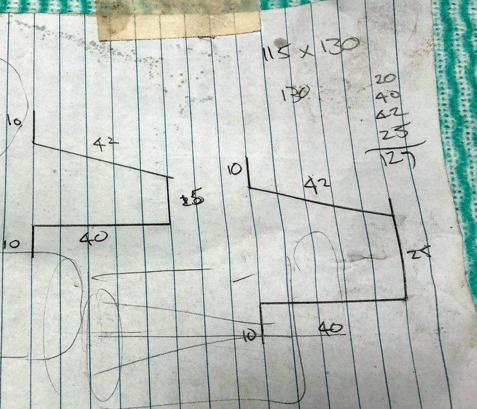

Thanks for the photos. Yes the car is LHD & will remain so. I don't have an original BD39516 but I've tried to fabricate a replica using the illustration from the parts manual. I've made 3 prototypes of different widths, 40, 45 & 50mm. I'll install the most suitable.

Neat metalworking Ross. One point, the PM shows it attached with three screws rather than via the four holes you have incorporated. The use of three might define where Jaguar intended it to fit when you look at the metalwork behind the trim.

Thanks Bob, however attention to detail isn't a strong point. Maybe when I remove the trim panel & see what lies beneath, I'll make a mk II version with 3 screw holes.
