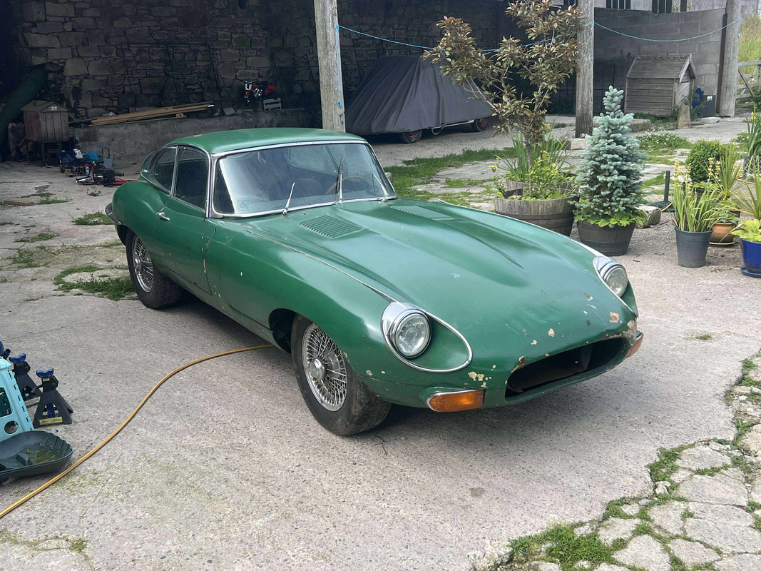

Hi I am Phil from Truro Cornwall and I have just taken delivery of my series 2 FHC American import. It's in a right state mechanically and looks overwhelming tbh but I am up fr the challenge. I am used to working on my old MG and familiar with where to go for parts etc. I guess I know nothing about this for the Jag beyond the internet.
With the MG I found the parts catalogue from Moss was both a great tool for ordering parts but also explaining the way to put things back together properly. Is there such a catalogue with exploded parts for the Jag ? If so how do I get hold of one ?

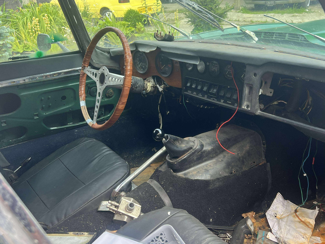

One interesting point. The car was owned by an engineer in Rhode Island and he appears to have constructed his own wiring loom, unfortunately the key to it is like long john silvers treasure map, more than a little care-worn ! Thing it'll be new loom time before long!
Thanks again I'll keep you all apprised!

New wiring looms are available from https://www.autosparks.co.uk/
Probably easiest to get a complete new harness and start from a clean sheet.

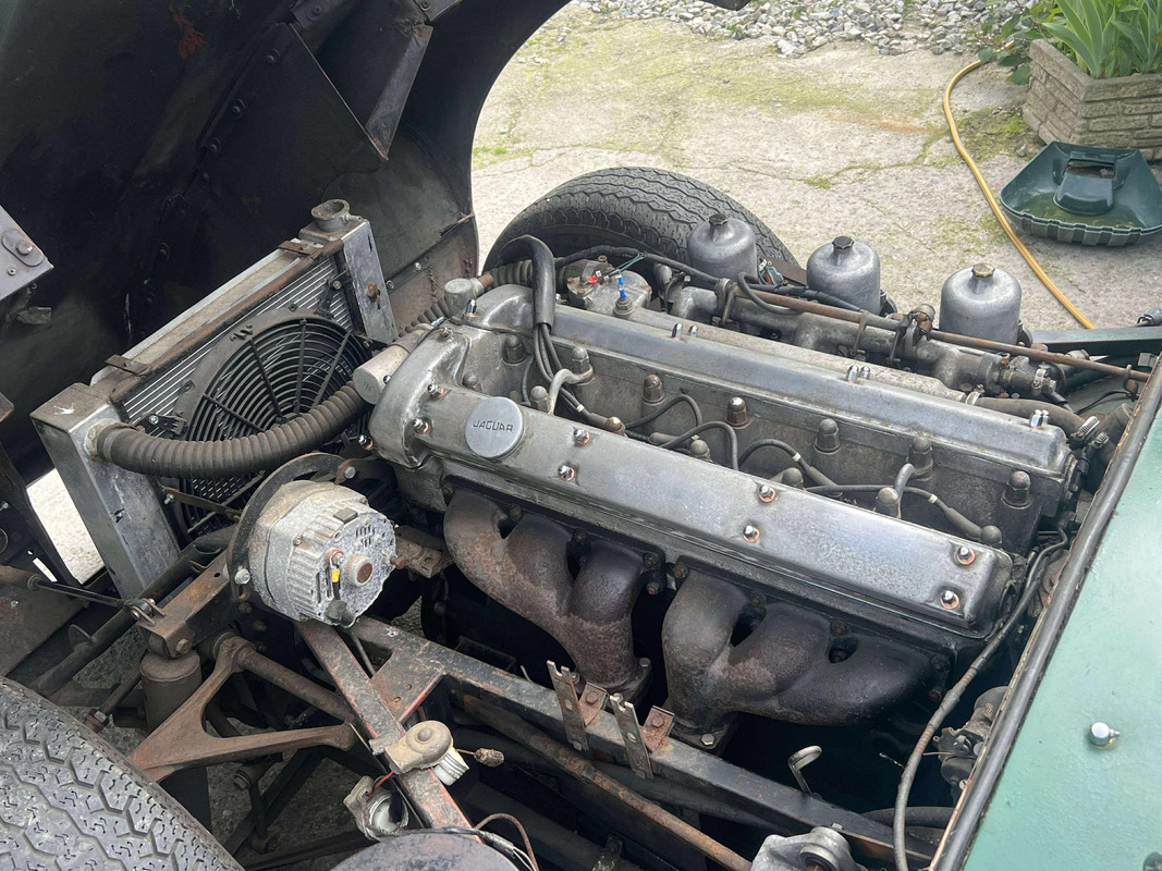

Also interesting is that it has triple SU carburettors and smooth cam covers where a USA specification Series 2 would have had twin Strombergs and ribbed cam covers. The previous engineer owner must have been tinkering with it. Did he make the wooden instrument panel too?
Yep you're right and what's even weirder is that it came with a spare set of triple SU's on a slightly different manifold !
Yes I think he or his 12 Yr old son made the wooden dash panels..... Will be replaced !

Yep I agree, I need certainty and some reference other than a wizards map. Might be an interesting job, or a nightmare !
It also appears to have a 3.8 L intake manifold.

One of the issues you are likely to come across is that the existing wiriring harness will not probaly reach the ignition switch when you have the column on the right hand side, so a new harness is a must. Secondly the upper column switch stalks will be on the wrong side. This can be altered but depending on what may have happened in the past will most likely require the help of a machine shop or someone with vertical drilling machine etc.
One very good book for wiring diagrams is the Coventry Auto Components book, they do a range of books covering all of the E Type variants, so check carefully when you order, as Jaguar seemed to carry over numerous bits and changes between the Series 1.5 and Series 2, so whilst the books are very good, you need to ensure you get the right one.
Time and patience will be required but it is not a difficult job, PM me if you wish to talk through any particular point

If you are going to completely replace the wiring I HIGHLY recommend the Moss Motors wiring manual. It contains schematics plus illustrations of where each of the dash wiring connects to its component.
