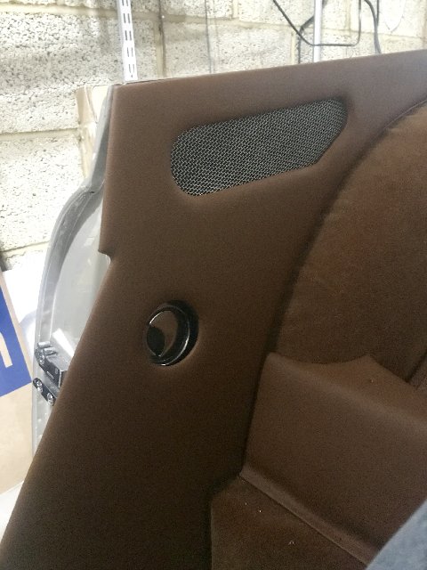

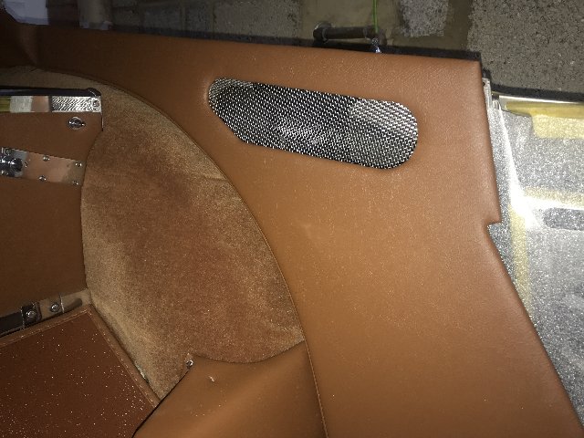

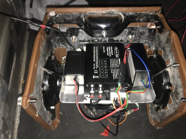

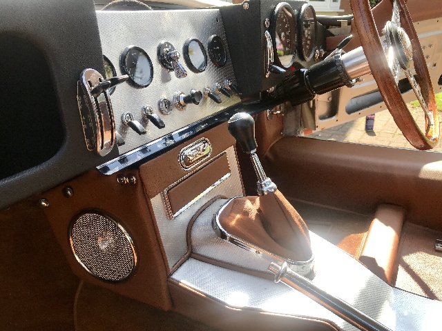

I have a hidden Bluetooth receiver/amp so I get my music direct from my IPhone - including radio. That way I don’t need an aerial or have to worry about re-setting stations!
I also hid two extra speakers in the ‘b’ post pocket voids, with chrome mesh to compliment the console speakers. The unit is small so allowed deeper speakers in the console. I needed a extra module as I’m still +ve Earth but I managed to make a tray to hold it all inside the radio console.
https://www.autoelectricsupplies.co.uk/ ... ategory/30

This is the 4 channel amp. I’m sure it will work with android Bluetooth....
https://www.classiccarstereo.co.uk/hidd ... amplifier/
The positive earth adapter (if you need it) is ...
https://www.classiccarstereo.co.uk/acce ... h-adaptor/
