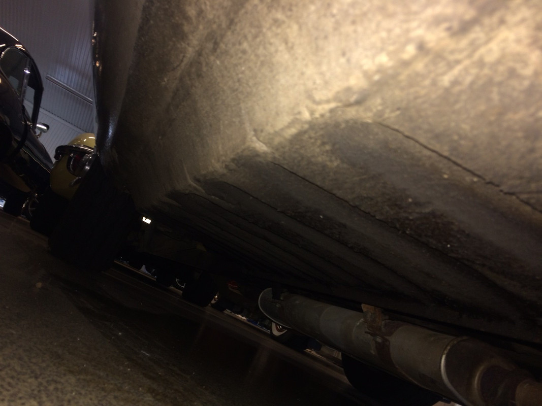

Here is a 1966 car, 4.2 liter, that I found and coud be a good exemple to start learning. I didn't see the car yet. I just chat with the seller and got some data about the car. I would like to have your comments and answers to my questions. As questions come from an idiot, I may accept stupid answers :bigrin:
Do you think this rust is critical or can be repared without disassembing the whole car ?

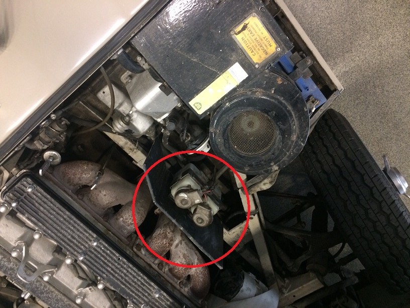

Which reservoir is missing in the picture below?

Post by mgcjag » Thu Nov 28, 2019 5:53 pm
Hi Partick....impossible to say how far rust has traveled without a thorough inspection by someone who knows what they are looking for..Has the car had a recent respray to hide things....ideally post the vehicle details....chassis/engine number someone here may know it or look it up here.... http://www.xkedata.com/ not usual but also not unusual to have mirrors or aerial in position shown.....Steve

Post by Patrick » Fri Nov 29, 2019 6:43 am
Thanks Steeve. I can't find this car in the web link you mentionned. Not suprised because it is a car initially sold in the north of Europe and lived there since then. You're right, I need to see her.
What about the small reservoir missing on the left, close to the inlet manifold?

Post by mgcjag » Fri Nov 29, 2019 8:56 am
Hi Patrick....fluid reservoirs.....i would expect to see 3 in that position but you never know whats been done till you inspect....also note the engine lifting eyes..oil filler cap.....ribbed cam covers...look like XJ6....is it an auto..i can see a dipstick.....so is it a relpacement engine?..Steve... Edit suggest you get this small booklet it is really good and packed with lots of info that will help you and its written by one if our regular forum contributers Peter Crespin

Post by Series1 Stu » Fri Nov 29, 2019 10:50 am
I assume it's the beige 2+2, not the primrose FHC, in which case if it's an automatic that would account for there being only 2 reservoirs.

Post by Patrick » Fri Nov 29, 2019 11:05 am
You're right Stuart. The beige is an automatic. Then the small missing reservoir is not missing in fact?

Post by mgcjag » Fri Nov 29, 2019 11:28 am
Yes Stuart....It didnt quite click..auto so no clutch reservoir.....i was consentrating to much on what could be an XJ6 engine....all the best...Steve
