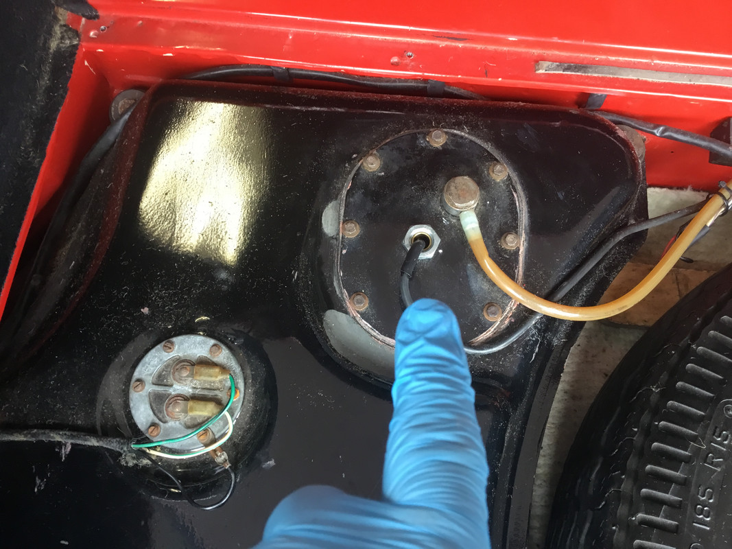

Managed to pick it up before the lockdown. Drove straight to a garage to fill it up. After a couple of miles I had a strong smell of petrol in the car. On investigation the fuel seems to be coming from the nut at the top of the submerged fuel pump where the electric leads come out. ( picture below ).
Is this a known issue if you fill up the tank?, Should there be some sort of seal in the nut?. I have since syphoned off some of the fuel, replaced the underfill and the smell has gone for now.
Any advice welcome.
Ian

Hi Ian
Welcome to the forum. Lovely looking car, looking forward to seeing more pics! What’s the history of the car?
In terms of your leak, take a look at this post viewtopic.php?f=4&t=13817&p=112517&hili ... ng#p112517
I suspect you would be better off getting a replacement from SNG or one of the other suppliers as it’s not worth the hassle of trying to seal it!

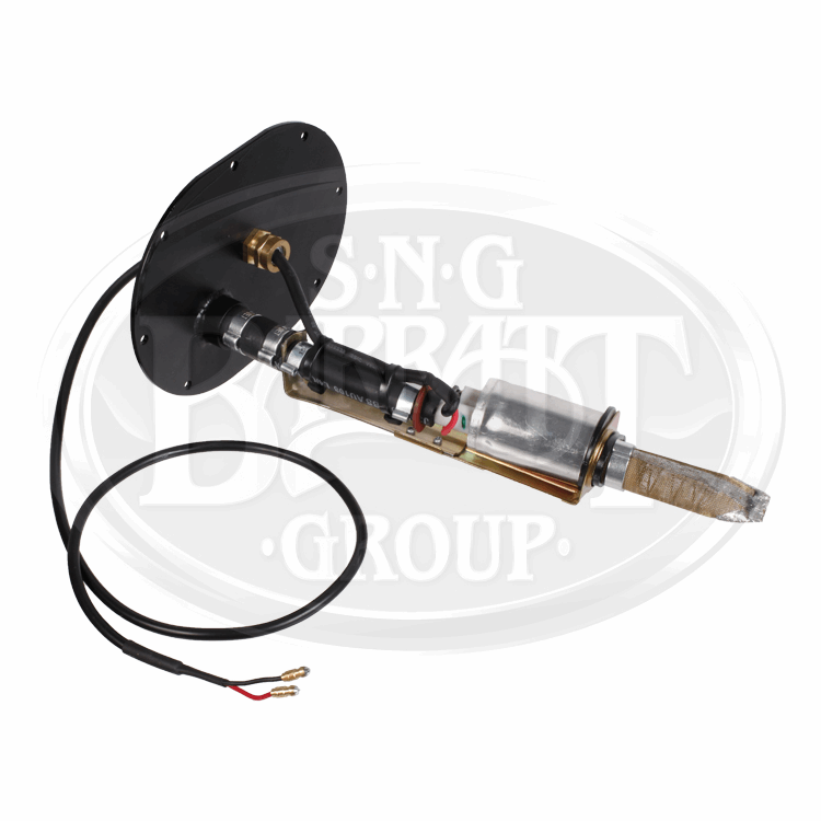

Agreed. You can't safely repair it and it will leak again as soon as you fill up. Buy a new design in-tank replacement from SNGB.

Thanks Guys, I suspected as much. SNG currently OOS, but I guess i have a bit of time with the lockdown and everything to source one.

Bit late to the table on this one - just in case anyone is still using the old D2FP pump (and I am one) the cause of fuel smells and subsequent leakage from the electric cable gland on the mounting plate is -- the armoured hose which contains the flex rots unseen inside the armourings allowing fuel into the tube.The gland at the top just has a rubber bush which is designed to grip the cable (to help stop it being pulled out).
To repair this you can carefully cut this off leaving the spigots top and bottom and substitute a piece of fuel hose of appropriate size. The armoured sheath does help to earth the pump - needed due to static electricity (although there is a special washer for that purpose on one of the mountings).So for piece of mind it would be better to fit a braided earth wire as a back up. The top of the pump is sealed against fuel leakage and this is not likely to fail - just the pipe above.

Looking at the OP's picture I think that he has one of the SNGB replacement pumps fitted, which leaked around the gland.
I've had 2, the first leaked and so did the replacement. I stripped them down and sealed them properly.
The problem in part was the use of some heat shrink on the cables which made a nice conduit for fuel to exit.
