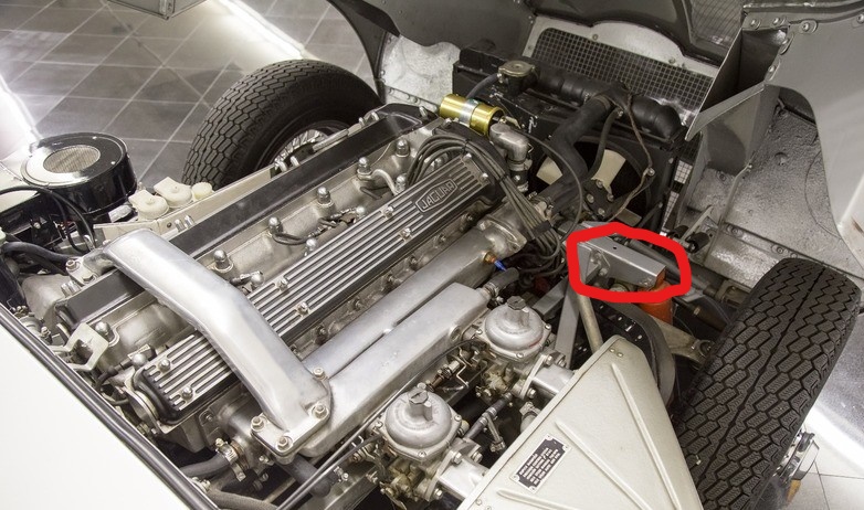

Hi...you will only find the chassis number if you lift the bonnet.....there should be a large data plate with all info stamped on it....also the chassis number is stamped on the front top cross member above the driver side shock absorber. ....Steve

I find it hard to believe that the police are not interested . Most forces have a permanent unit which investigates stolen vehicle rings . If you are meeting with no response, you should immediately demand to see a Superintendent, and if you still meet with no response then an immediate letter to the Police Commissioner for the force involved is needed. However, how do you know the car is on false plates ? Do you know the identity of the people who have deposited the car in the garage ? As has already been said, the apparent chassis number would help - to get under the bonnet you twist and pull two catches, one above the forward end of the door sill on each side, and then lift the bonnet forward releasing a safety catch at the rear end of the bonnet centre
In addition to a punched in number as shown in the picture above, there should also be a dataplate on the flat portion of the forward sill just in front of the bulkhead. On rhd cars it is on the right driver's side, and vice versa for lhd cars

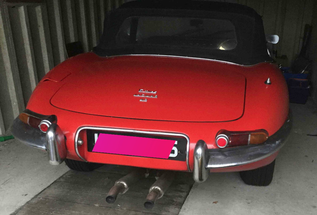

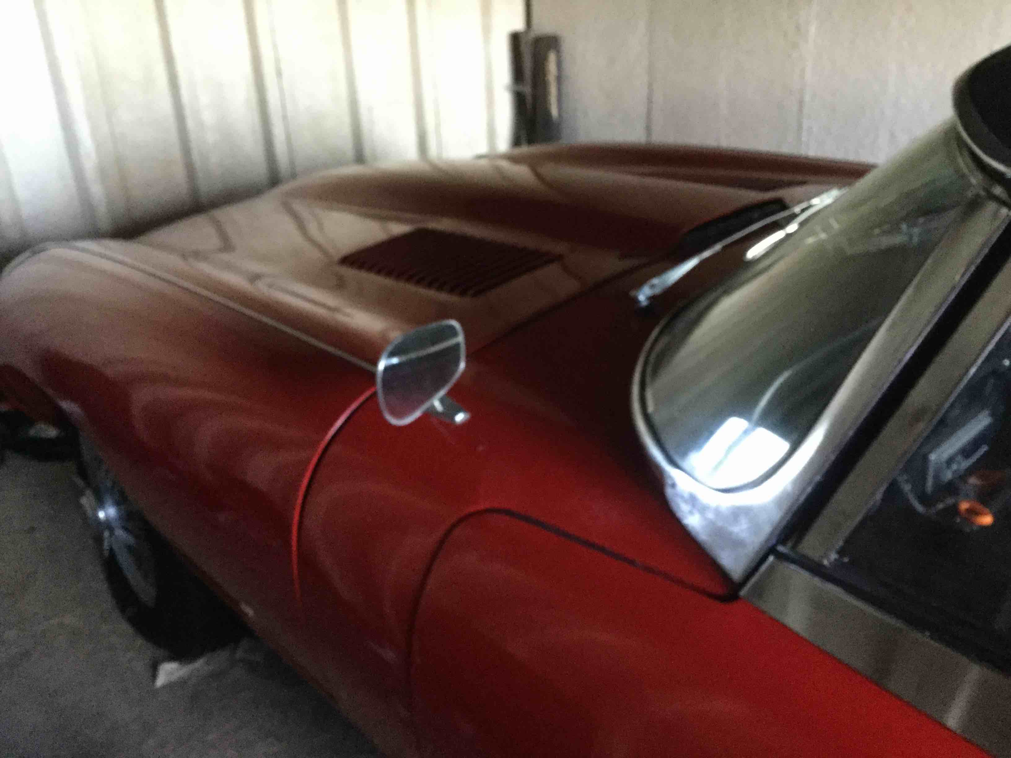

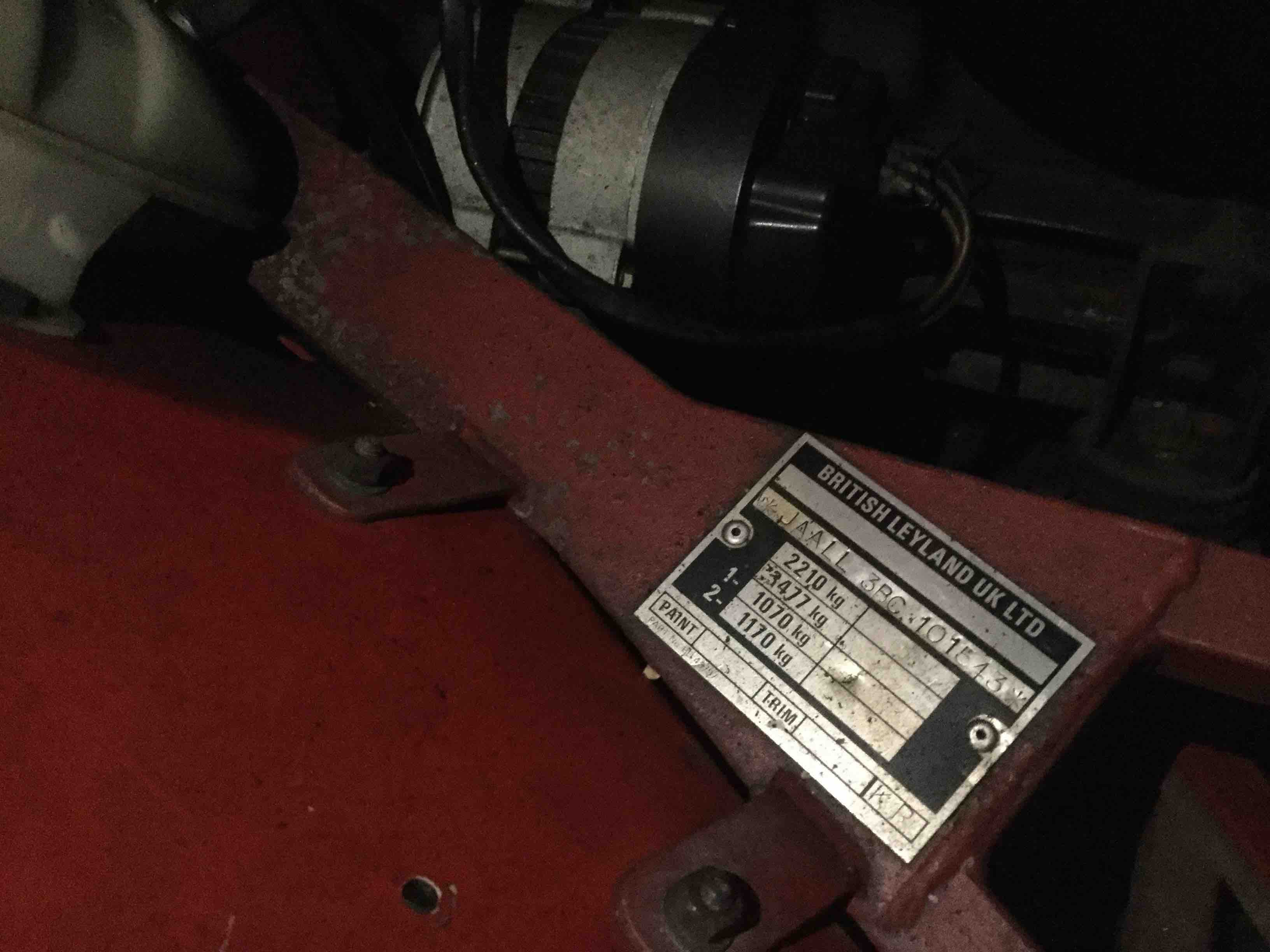

Again, great tips thank you everyone.
We managed to get some photos, but unfortunately did not see the recent posts before we did so.
We also did not see the post about the possibility of the car being a replica in time to check if was grp, which makes a lot of sense.
My money is now on it being a kit car, but hopefully one of you will be able to confirm this from the attachments.
We look forward to hearing your thoughts.

- Jag side.jpg (230.65 KiB) Viewed 18710 times
- Jag.jpg (163.55 KiB) Viewed 18710 times
- Data plate.jpg (232.04 KiB) Viewed 18710 times

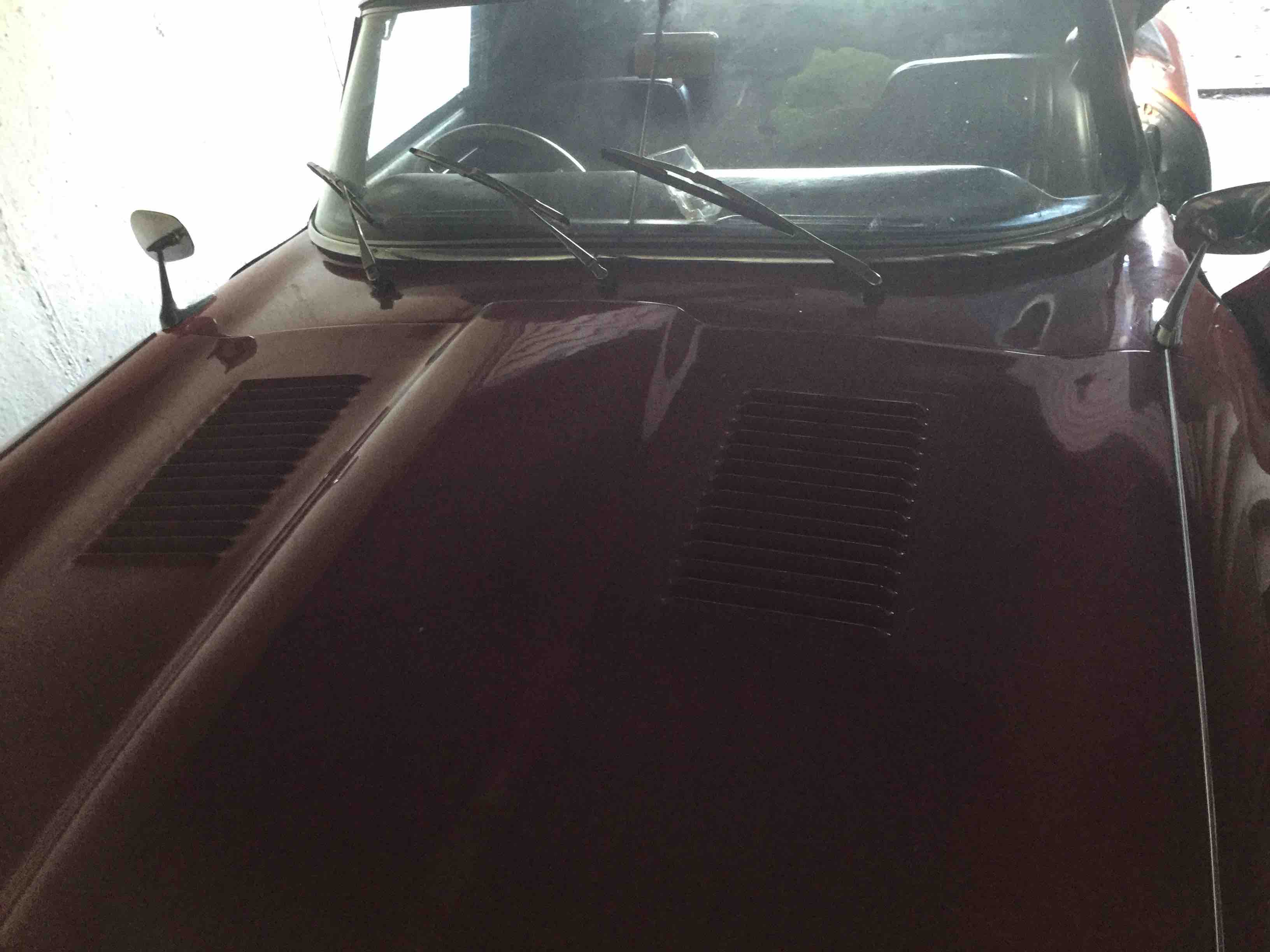

More photos...
- Attachments
- Jag front.jpg (208.9 KiB) Viewed 18709 times

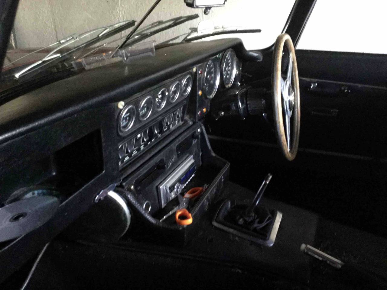

- Jag interior.jpg (115.48 KiB) Viewed 18709 times

That looks like a kit car to me. Dashboard area is a giveaway, along with the xj6 vin plate, the windscreen surround and many other non-etype features!

I will lay long odds that it is a Challenger, and there's probably nothing false about the reg at all. The broad transmission tunnel is the clearest indication of this . The dataplate is a bit of a puzzle though as it does not appear to be from an XJ6
