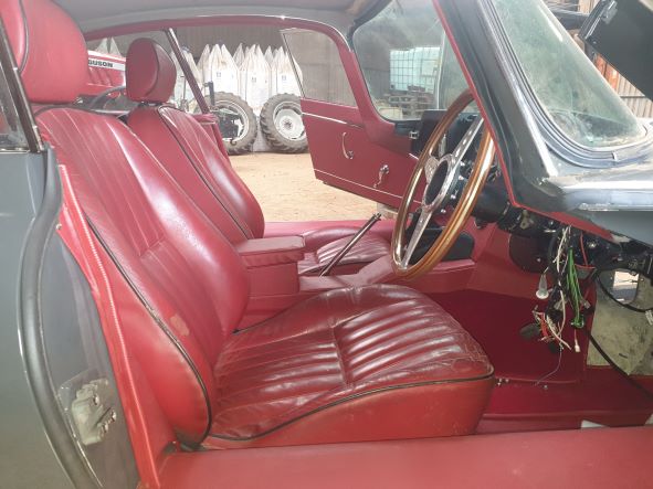

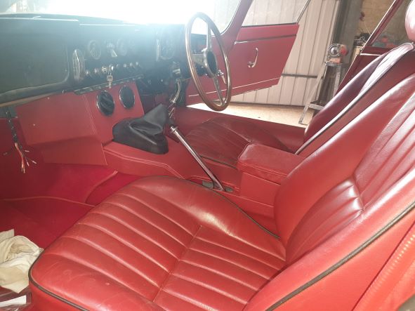

I have fitted Tombstones. They are quite tall and only just clear the headliner on a Coupe.
These are MGTF seats, bolted directly though the floor on the original seat captives. The bottom cushion is removable to allow fitment.
They have been positioned as far back as possible and as low as possible to allow those who are 6ft. The MG red is the same a Jaguar red by the way. The black would match too.
MGTF Seats.jpg (48.96 KiB) Viewed 6876 times
chadly_t
Posts: 2
Joined: Mon Nov 25, 2019 2:58 pm
#7 Re: New member here with project and front seat question
Post by chadly_t » Mon Oct 18, 2021 2:20 pm
Wow, those MGTF seats look great to me. Just what I was thinking. Did you use the Jaguar adjusters or the MG adjusters?
I will look to see if its easier to import a pair of these seats instead.
Chad
1967 E-Type S1.25 2+2
1989 Porsche 911 Targa
Posts: 1388
Location: Boston UK
#8 Re: New member here with project and front seat question
Post by politeperson » Mon Oct 18, 2021 4:53 pm
I didn't use any runners. I removed them.
This is because the seats had to be adjusted all the way back and down to the max for me at 6ft tall, so no point.
I just extended the seat base with the runners removed and drilled holes to match the spacing on the captive nuts in the floor pressing.
The foam and base lift off the frame so you fit the 4 bolts with the cover off then add the seat covers after the frame is secure.
The seats are so far back they are touching the rear bulkhead. That is still only just enough for me to be comfortable.
They are also now so so far down the cushion is below the height of the sill.
That gives enough clearance between the bottom of the steering wheel and the seat base so I can get in and out easily.
Of course it doesn't matter so much where the passenger seat is as they dont have to negotiate a steering wheel or reach the pedals.
They were all Hobbits in the 1960's. 50 years of steroids in your beef and we have all grown somewhat, I am sure.
I fitted new seat covers on stock Series 1 seats 2 months ago on another car. They made the seat base so high I could only just get in and out. My head was only an inch off the roof lining as well which is very dangerous.
I had to remove the seats, remove the cover, remove the foam and take 3 inches off then refit it all. II is now easy to get in and out, I dont bang my head and it is a much more natural seating position with loads of room inside the cockpit.
It is amazing how much difference these small adjustments make.
