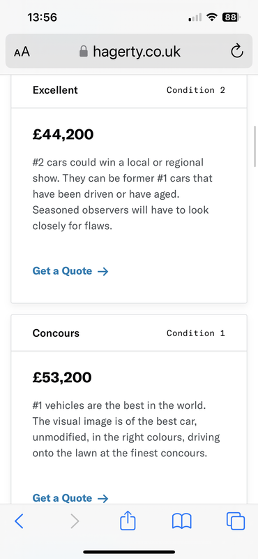

Welcome. It’s definitely a buyers market at the moment and 90k is a huge sum to pay for 2+2. As per above, this is Hegerty’s view:
If it’s a S1 2+2 you’ve got your heart set on, then I would definitely get an inspection done. Have you had E-Types before? How many have you looked at already?

Thanks Richard and Bob, agree it’s a buyers market but those numbers look a bit low, I am buying from a dealer so would expect to pay a bit more but that’s a big difference
