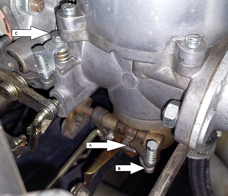

I am re-looking at this before I start my engine after some 2 months sleep. This is because of the article and letter in the latest E-type club magazine. Article by Darren Hughes, letter by Bob Alexander which got me thinking and wondering if my choke is working properly when I pull the lever on the dash. I suspect it is not but find no write-up I can properly understand telling me what I need to know. So, some questions here:
With the choke lever fully in, what should be the gaps at A and B. On my centre carb I get about 2.42mm at A and I cannot get a 2 thou feeler in B.
Finally, with the choke lever pulled right up/out, how much should the pushrod (item 17 in the manual diagram page C.5) at arrow C drop. On my car, from rear to front carbs I get 0.05mm, 1.72mm, 0.87mm.
Seems likely to me that the carb jets are not all dropping the same or even enough maybe for proper cold start enrichment. What sort of amount should these drop?
Advice appreciated, thanks.

Hi Jerome,
The gaps at A and B have nothing to do with choke adjustment directly. The screw at B is the mixture adjustment and shouldn’t be touch (unless you need to adjust mixture!)
The only real choke adjustment is the silver screw NEXT to C in your picture. It should be adjusted to be just clear from contact when the choke is off.
The choke on an Etype (with triple carbs) is a two stage choke - when you first start to move the choke lever, it should slightly open the butterflies allowing the engine revs to rise - via item C in your picture. More application of the choke lever will then push down the jets via A and B in your picture, allowing the mixture to enrichen and help cold starting.
The workshop Service Manual has a very good adjustment procedure.
