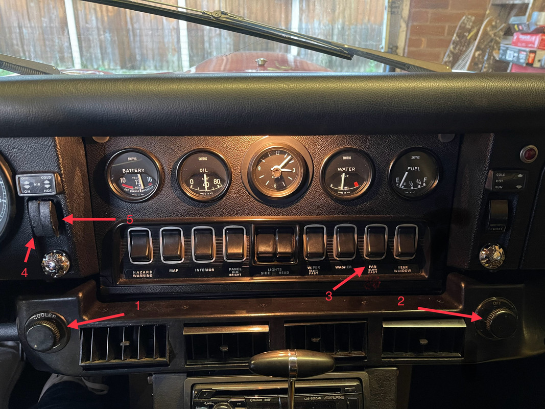

I thought I knew my way around an e type but I am struggling with how the heating & ventilation works from the dashboard….can anyone help? I have added a photo which I have marked up and I am just trying to understand how they all work together. Thank you.

4 and 5 are the confusing ones! "4" is on when pushed in, off when out. "5" is hot when in, cold when out. The other controls are different to mine so don't know.

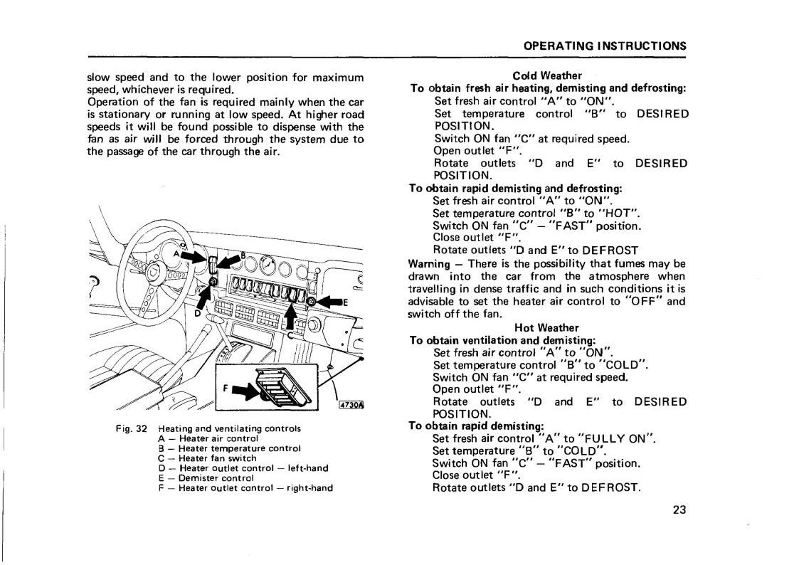

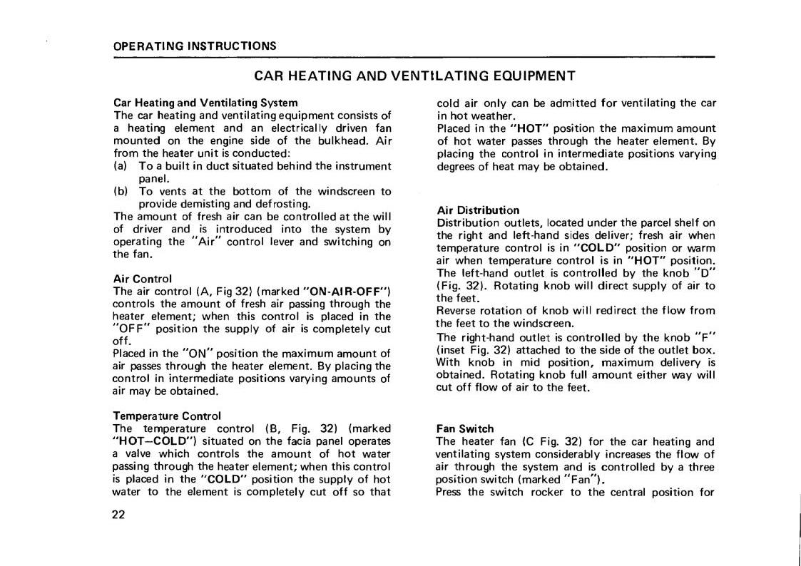

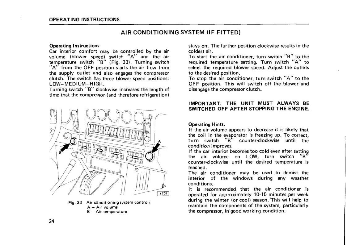

Congratulations on getting your S3. It appears to be a 1971or 72 LHD 2+2 auto with A/C and if ex USA may still have all the emissions kit under the bonnet. This kit is only covered in the US versions of the handbook (red or tan colored covers) so would be the best version to go for. If you don't want that information then the ROW blue cover version will do and also covers A/C in the H&V section. To get you going here are the relevant pages - although how helpful they will be I am not sure.
