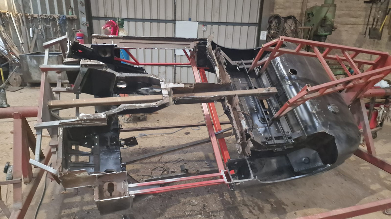

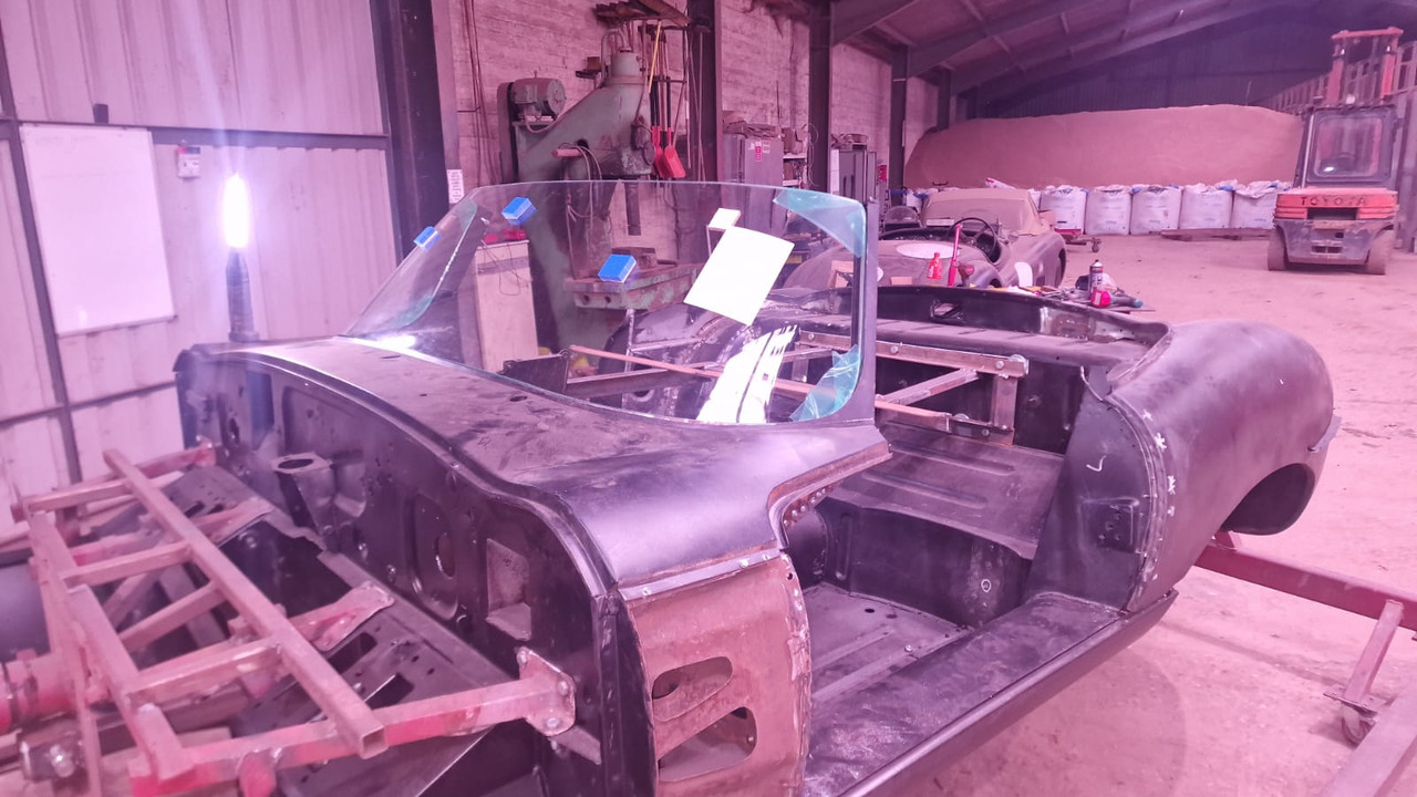

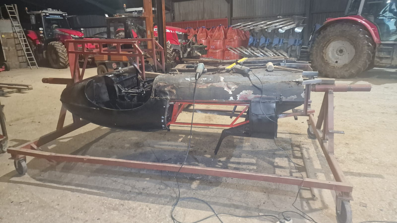

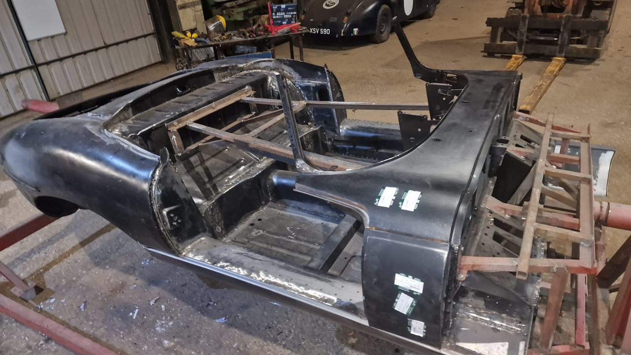

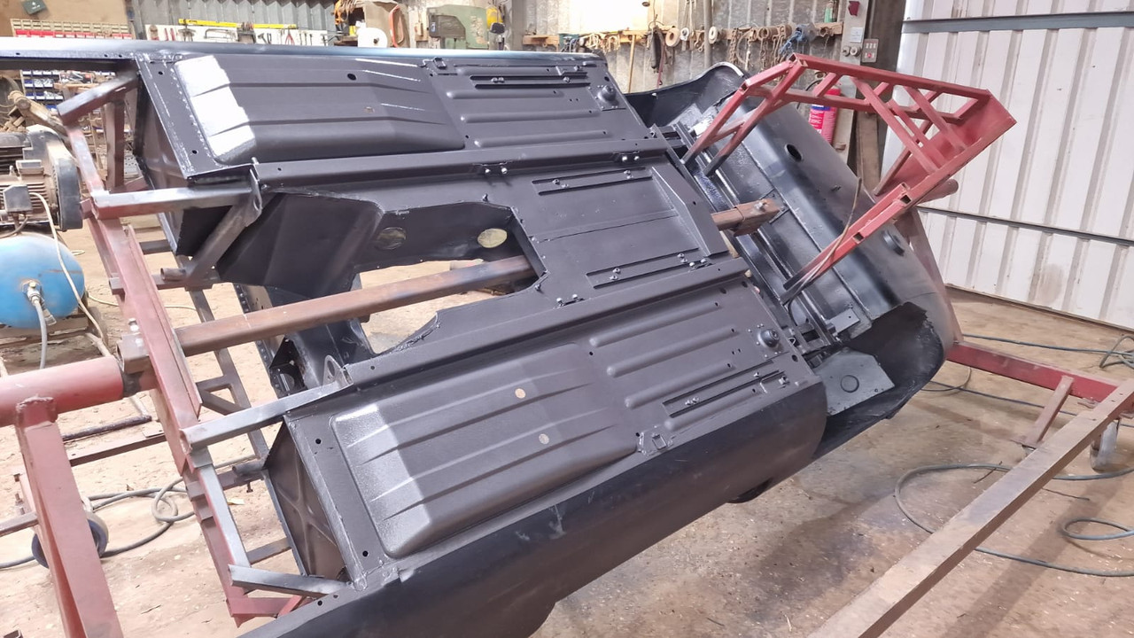

#4 Re: USA cars
This is what I developed. It comprises so much steel that even broken down it is difficult to fit in a large van. Weighs well over a tonne.
If you have good door gaps, then there is a pretty good chance your shell is not twisted, so you want to keep it that way and brace it all before you start cutting. The frames need to come off.
If you have no jig, you really need to brace the rotisserie to stop everything collapsing inwards. That is not easy, as it can try and twist in a few different planes.
You need to set the door gaps and the width of the cockpit, using the hood frame mounts in the case of a roadster.
Also set the distance between the front and rear bulkheads. I use the steering column captives.
You may notice a straight beam connecting the front section of the rotisserie to the rear section of the rotisserie through the transmission tunnel. It is essential.
This stops the body collapsing inwards and is removable through a hole in the front section after floor welding is complete and the tub is strong again.
E-type tubs are very strong if they are not rusty.
I use a windscreen to get the pillars in the correct place. and a brace between them for distance prior to removing one.
