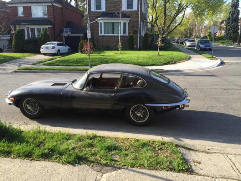

Attached you can find a picture of the car, which was taken by the PO.

The bodywork is, I would describe it as “ok”. New floors were fitted in former times. On the body itself is nearly no rust. When you look at the picture above you can see black stains on the bonnet and rear wheel arch, there was rust before it was removed and primed. Left and right bonnet wing, front wing (not the middle section) are already replacement parts and where fitted by a company, but I do not know which it was. Works were all performed by a workshop not the PO itself. I will see during the project if this is good or bad.
First big step is that the car should be technical in very good condition, everything working as it should, wired right etc.
I already removed the bonnet and did a compression test. Maybe I do not have the most exact gauge but it says on all 6 cylinders between 160-163psi.

You are getting on already. I would say the compressions are fine. Even balance and good pressures. My electrics were useless when I bought mine but time and patience has brought everything back to life....in my view Lucas electrics, while maybe not rolls Royce quality, are unfairly maligned....after 50 years they are bound to need a bit of tlc....

3 points : 1. removing the picture frame is a very major operation involving dismantling of the entire front suspension and should be avoided if all you really want to do is remove engine/gearbox and generally clean up the under bonnet area . Apart from anything else, the car loses its front wheels and effectively is immobile
2.to remove the engine the general consensus seems to be that it is best to lower it downwards and then lift the car's front up, wheel engine/box out from underneath, and lower the car again . I have taken them out upwards, and this is not terribly difficult, but it does require strong nerves with 330kgs up in the air!
3.Your fluid leak is not to do with the tachometer drive , which is electrical on all E types and ignition driven on an S2. The drive to which you refer is that for the speedo cable
