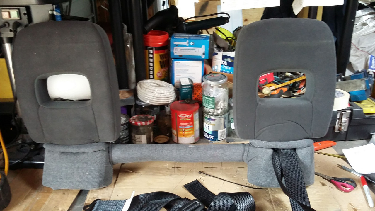

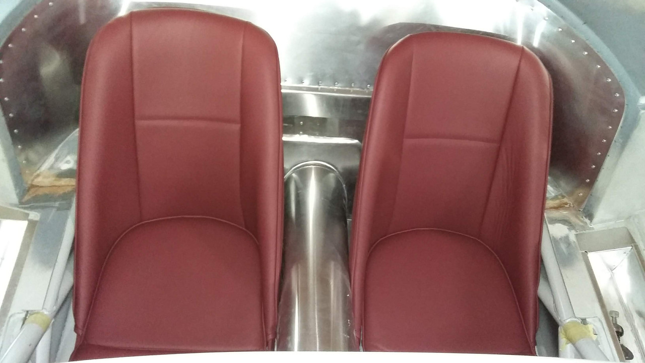

Steve, are the seats from the original car and hence you had to use them? They look more like barn doors that’ll increase the drag dramatically. Could you fit MX5 seats instead?
Posts: 8658
#25 Re: Building a Realm C type
Post by mgcjag » Sat Nov 11, 2023 7:26 pm
Hi Geoff....original Car? ...I used a doner xj6 for engine. suspension. Diff. brakes.....seats are very similar to original C type seats...Steve
Posts: 3569
#26 Re: Building a Realm C type
Post by Gfhug » Sat Nov 11, 2023 8:19 pm
Ok, Steve, but what are those two high lumps sticking up above the cockpit in your earlier photo? Post no. 20
Posts: 8658
#27 Re: Building a Realm C type
Post by mgcjag » Sat Nov 11, 2023 8:36 pm
Hi Geoff....iva requires head restraints....either as part of the seat or mounted behind the seat....made up this to fix into the harness mount just above the top of the seat backs...you have to get creative :bigrin: ...will they stay on after the test :shock: .Steve

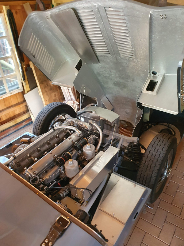

Quick update....IVA passed and now fully registered with DVLA....and at the painters..Steve
Ok edited to 3 photos

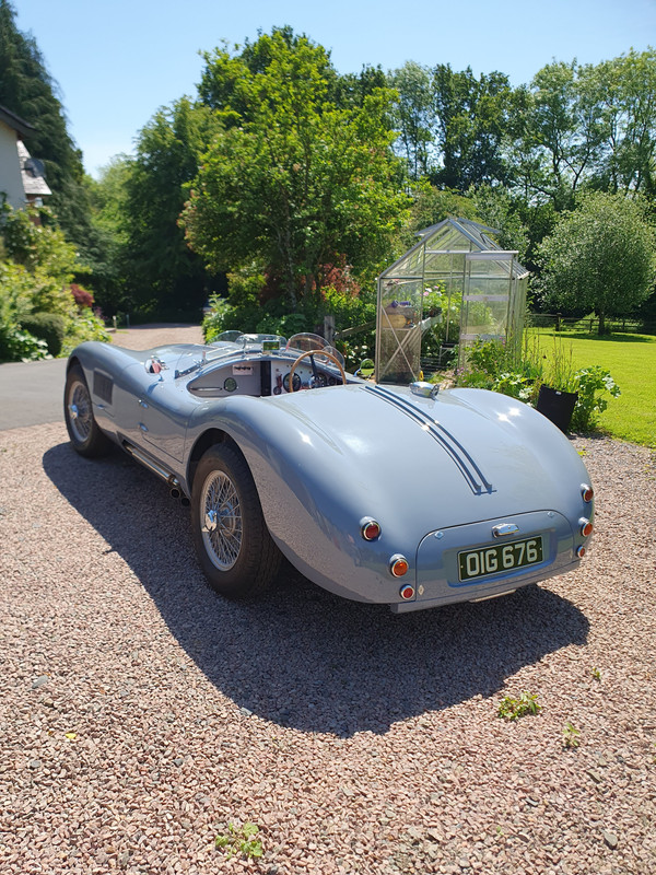

Finally completed and road legal
Posts: 3569
#38 Re: Building a Realm C type
Post by Gfhug » Sun Jun 02, 2024 4:40 pm
Steve, that’s looking great. The bonnet looks almost bare metal underneath, it that’s just a trick of the light?
Certainly the colour looks much better when the car is outdoors, it has a nice blue hint.
Just one job left for the winter, getting the heater working :wink:
That and getting the 150 on the road. A two car family!
Posts: 8658
#39 Re: Building a Realm C type
Post by mgcjag » Sun Jun 02, 2024 4:44 pm
Hi Geoff...some bare ali but it's a Grp bonnet iv painted it silver..might help reflecting some of the engine heat :shrug:

Post by Simonpfhc » Sun Jun 02, 2024 6:22 pm
That looks totally stunning Steve, congratulations :drinkingcheers:
Are those ribs down the centre of the rear end a normal C-type feature? Never noticed them before.
