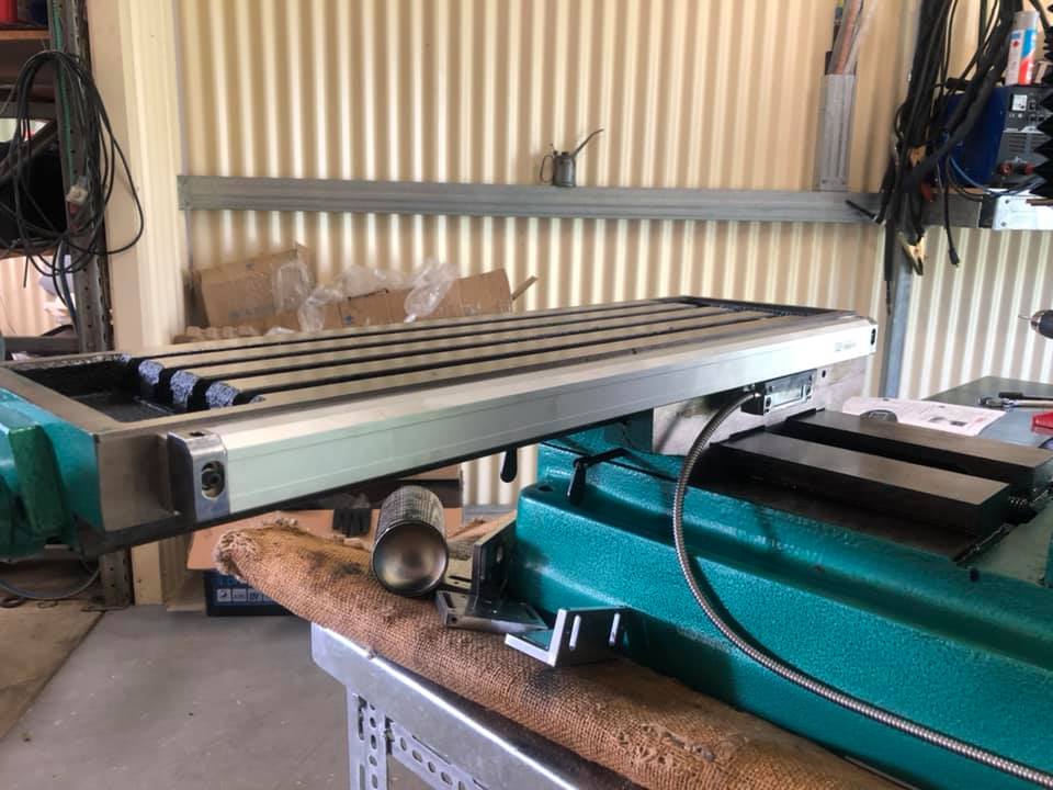

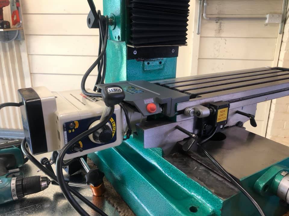

Post by abowie » Thu Sep 12, 2019 8:38 am
Progress.
3 axis DRO kit to install.
X axis installed.
X axis power feed installed.
Next! Y axis DRO. This is the tricky one. Watch this space!

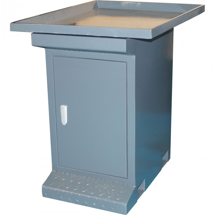

The bench can just be moved by 2 strong men. So maybe 100kg?
This is a commercially available mill stand. It's made of 3mm steel and weighs 50kg. The slots in the bottom are for fitting adjustable feet to level it.
What I have is bigger heavier and as rigid. I think it will be OK. I plan to bolt the mill down to it.
