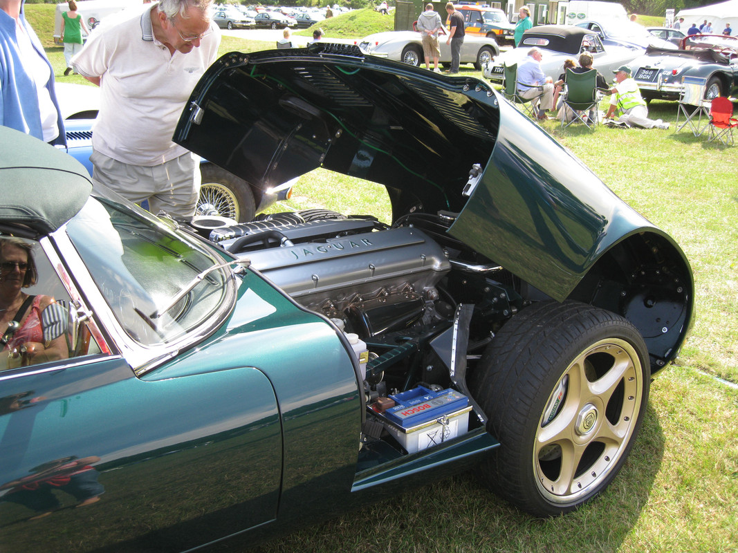

Couple of issues with the more modern Jag engines. The AJ6 and AJ16 are slant sixes and might require the wider V12 engine frames. As none of the Yank Lumps will fit without engine frame surgery I imagine neither will the Jag V8. The modern sixes are oriented differently, exhaust and inlet are on the opposite sides to the XK engine. There exists at least one E with a Jaguar AJ16 transplant.
It, and its creator are well known on this site.

BTW I took that photo over ten years ago. Time flies when you've been having fun.
