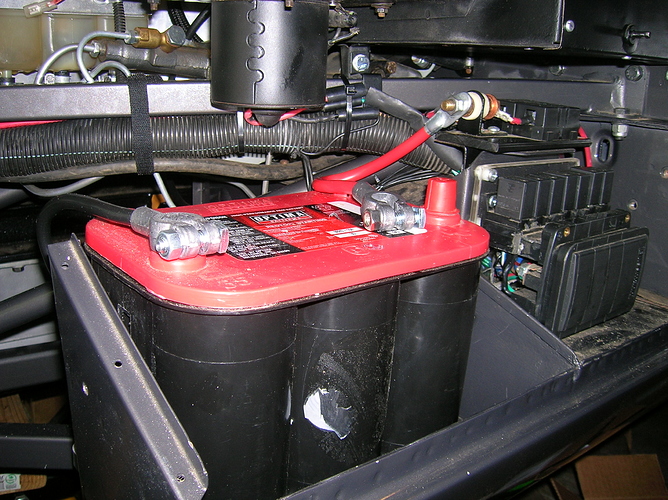

I have an Optima. Excellent performance for churning and starting the big lump on a car that is not on the road. I haven't quite worked out how to secure it in the car, but it does just fit in the space available.
#13 Re: New battery recommendation
Some of us have used the tray type shown in the link below. I had to relieve the perimeter of the tray very slightly in a couple of spots with a grinder and it dropped right into the opening. To affix the tray to car drill holes in the bottom in appropriate locations (there are voids between the cells if you look at the bottom). The battery obviously drops into the machined aluminum tray and is locked in by the brackets at the bottom flange of the battery. There are other manufacturers using the same design. I don't know if the external dimensions are the same as the Wieland kit. There are also different part numbers depending on the Optima model number. I believe my battery is a 34, but can't recall for sure and the car is not accessible at the moment.Monkeyfinger wrote: ↑Tue Mar 12, 2019 12:51 pmI have an Optima. Excellent performance for churning and starting the big lump on a car that is not on the road. I haven't quite worked out how to secure it in the car, but it does just fit in the space available.
https://www.ebay.com/itm/34-78-BHD-Bill ... Swa-dWkwXx
Eric

Neat fit. Only thing I would observe is it does not seem to be strapped in or secured by a clamp etc....in the UK (technically at least) an unsecured battery would fail an mot....if of course you submitted your car for one and I know we no longer have to.....
#15 Re: New battery recommendation
Hi Julian...have another read of the post above...and look at the link.....battery is clamed and held at the bottom..Steve
#16 Re: New battery recommendation
Missed that bit
Monkeyfinger
- Posts: 308
#17 Re: New battery recommendation
That's a smart solution and somewhat better than the central strap I was planning to work on.
