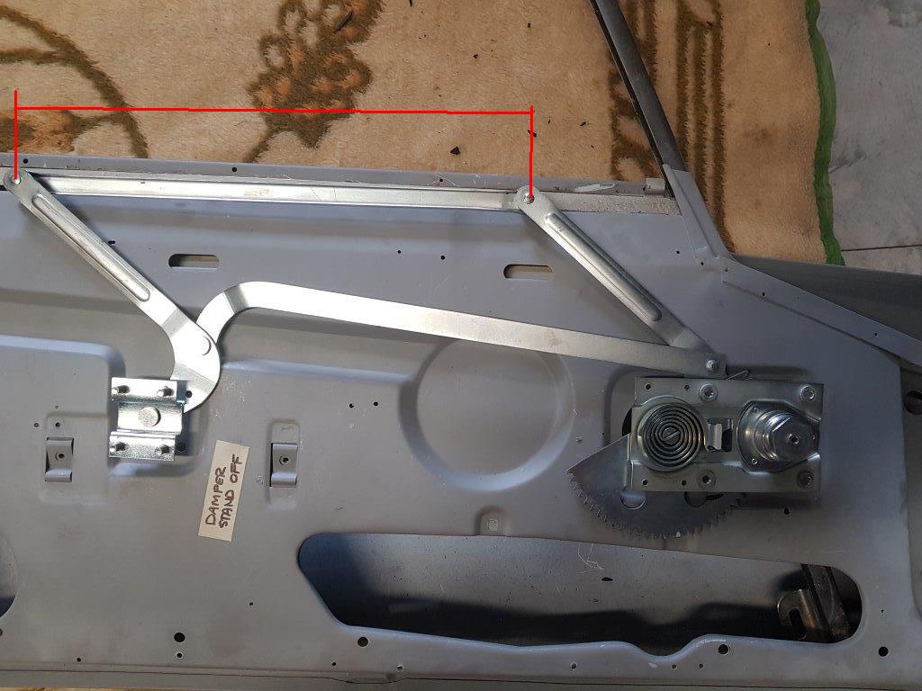

With regards to BD32616 assembly fitting perfectly (in a RH Door) until the remote catch is fitted, I suspect that the Vibration Damper Bracket and Guide (for the remote catch bar) is missing from your door. With the Vibration Damper Bracket in place, its simply impossible to do. The following picture shows the extent to which the threaded studs of the four threaded stud bracket of a BD32616 Window Regulator, pass through the door shell when attempting to fit it to a RH Door with the Vibration Damping Bracket in place.
This is due to the lower horizontal arm interfering with the Vibration Damping Bracket. The nut in the picture is only engaged by a couple of threads and was there only to hold the bracket in place so I could take a picture as there was quite firm pressure against the interference with the Vibration Damping Bracket to get the engagement that far.
With respect your fitting of the BD32617 to a RH Door, the correct assembly, notwithstanding the LH Part Number, and having interference with the Glass Channel member of the Window Regulator as it passes from Window Up to Window Down position, I suspect that your work around may have made it work, but not for the actual reason for the interference.
The following picture is of a BD32616 (RH Part Number) superimposed on a Left Hand Door so that the correct configuration of the Window Regulator can be seen when in the Window Up position and with no possible interference with the location of the Vibration Damping Bracket. The dimension of the top, horizontal member of all the After Market assemblies I've measured is slightly longer than original equipment and as that member moves from the Up to the Down position it passes the point where it transitions from being above the members fixed to the door shell to below them. At this point, the centre distance of the pivots of the horizontal member of the Window Regulator, that interfaces with the Window Channel, is too long to pass without the moving mechanism distorting and moving sideways.
