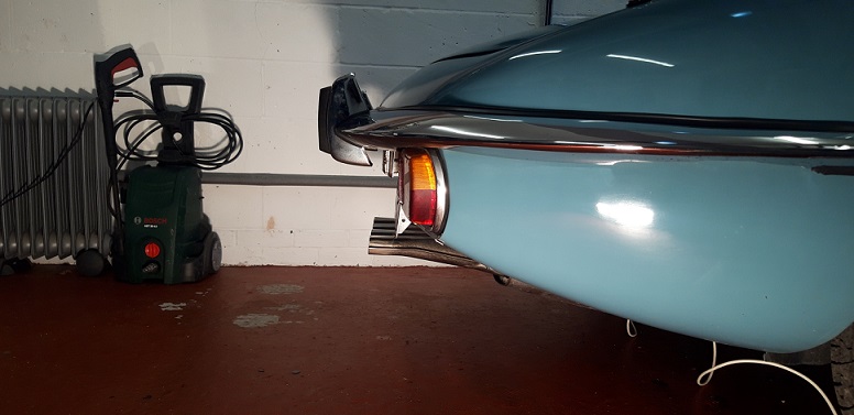

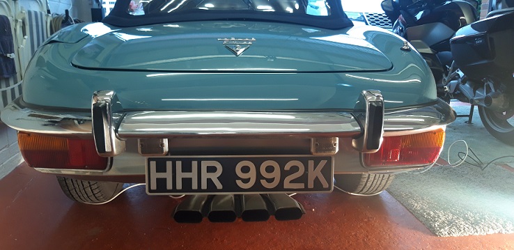

Could anyone give me a dimension of how far a exhaust should protrude or not beyond the bumper???
I ask as a health report i got mentioned the exhaust should be extended a bit to stop fumes coming into the car, and indeed they do a little.
Ta
