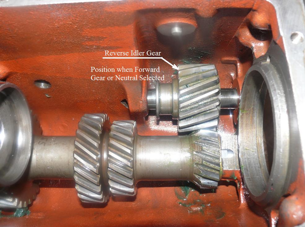

First idler gear. They're straight cut and get damaged in all the boxes.SimonBrown wrote: ↑Wed Nov 27, 2019 8:38 pmThere is a noise when the clutch pedal is released in neutral (disappears when depressed)
#13 Re: Gearbox noise
Andrew Wrote:
There are no Straight Cut gears in a Jaguar 4 speed, all synchro gearbox, they are all helical. However, the noise Simon referred to is caused by the Reverse Idler Gear. When the Reverse Idler Gear is in the forward position, when Neutral, or a Forward Gear is selected, the Gear on the Lay Shaft Cluster is engaged with the part of the Reverse Idler that engages with Reverse Gear when its being driven. In this position, as shown in the first picture below, the noise Simon referred to is heard.
Move the Reverse Idler Gear to the rear position, as shown in the second picture below, where it would be when engaged with Reverse Gear, the noise disappears
I have a rig, whereby the gears can be spun up for diagnostic purposes. In the test performed on the gearbox shown in the above pictures, the Main Shaft and all its gears were removed from the gearbox so that the Reverse Idler Gear was isolated. At a glance and without the benefit of the above test, one would say that there was nothing wrong with the Reverse Idler Gear, but under close examination, wear on the flanks of the tooth form in the area that engages with Reverse Gear can be detected; rather surprising given the relative low mileage traveled in Reverse compared to any Forward Gear.

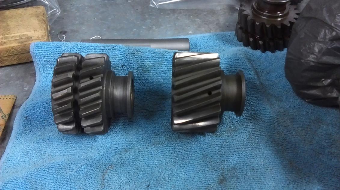

The picture following show two versions of Reverse Idler Gears used. The gear on the left is from an S3 gearbox, the one on the right, from an S2. I'm not sure when the change was made, as the parts are identical except for the annular groove and I've seen S2 Gearboxes with the annular grooved Reverse Idler Gear, that clearly hasn't been a replacement. I suspect that this groove was introduced so that the sides of the groove acted like Oil Slingers. I doubt this extra operation was added just for the Hell of It, or as the fishermen say, "just for the Halibut", and I can see no other purpose for it.

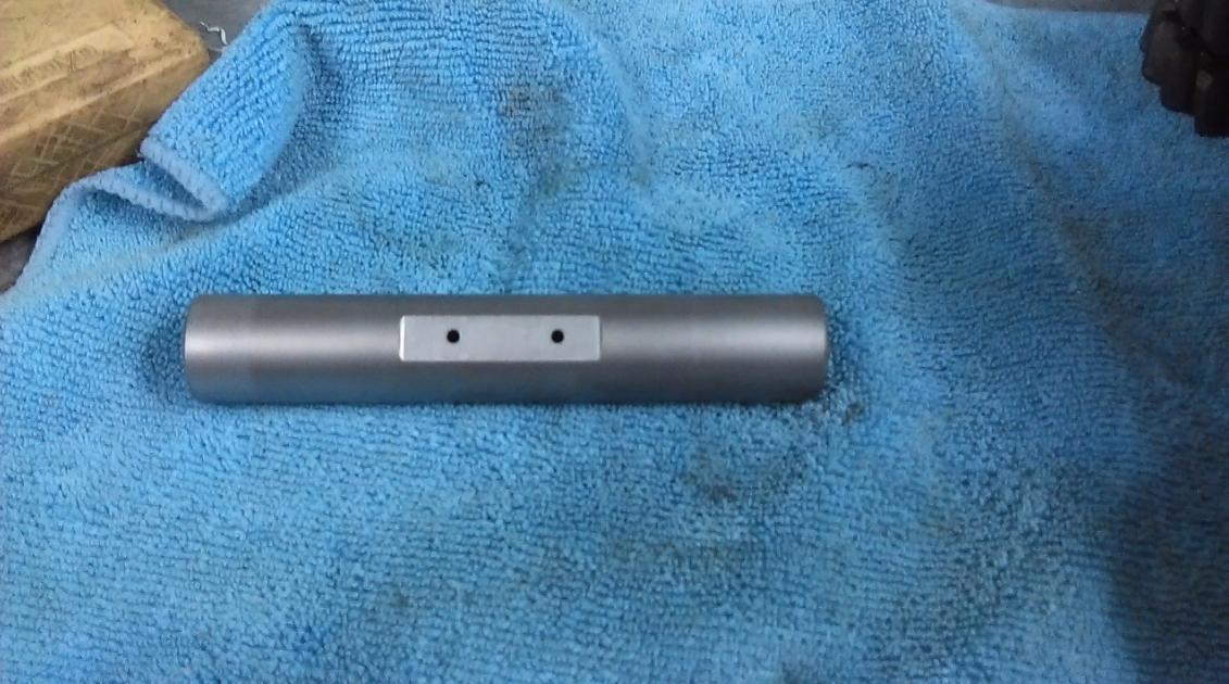

The shaft that the Reverse Idler Gear runs on is nearly always worn considerably in the area where the Reverse Idler Gear would be when engaged with Reverse Gear. Once this shaft is worn in this area, wear of the tooth form in the area of the gear that engages with Reverse Gear is exacerbated. I now make my own shafts out of better material than that used in the original. See the part in the picture below.

No. Once the Reverse Idler Gear is worn/damaged, the only remedy is to replace it. The typical wear that you see with the shaft that the Reverse Idler Gear runs on, changes the mesh of the gears slightly and usually results in accelerated wear of the gear form. I should have added that comment to my previous Post and that, if the Reverse Idler Gear is replaced, the shaft (if worn) should also, so as to avoid rapid wear of the new gear.
Hello David,Bill, are you saying that changing that shaft will reduce/cure the noise and that using your improved shaft will do so for longer?
