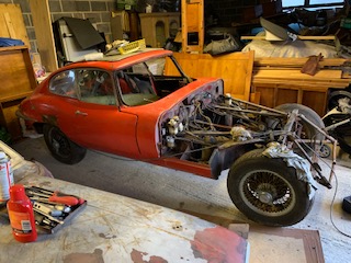

e type.jpg (42.33 KiB) Viewed 10820 times
e ypee.jpg (68.95 KiB) Viewed 10820 times
Thought I would add pictures to give general idea of the condition of the car
I do have the bonnet but its rusty in places. I have most of trim but its very poor
I need a screen if anyone has one kicking around
I've put up a picture of bulkhead to show the original colour
Many thanks

From your photo's the external bulkhead servo pipes also date this to an early 4.2 , do you have the pedal box ? it should have the steel folded plate but with the later 4.2 master cylinder.
There are many other relevant features noted in the reference books.
Electrical items could also help date the car ---wiper motor etc and smaller items like flasher units .

Cant see a mounting for the rad fan motor which would be on the frame.
So I think it’s either a differing frame or a later car.
External vacuum pipes were later I think.
Flat hub wheels - again nothing definitive but maybe builds a picture
