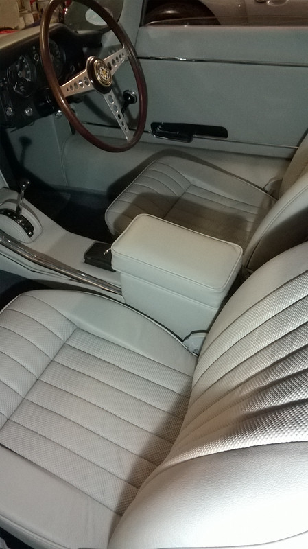

As requested, here are some pictures:-
The 1st pic shows my car as it was, with the "biscuit" interior, before I had it converted to right hand drive.

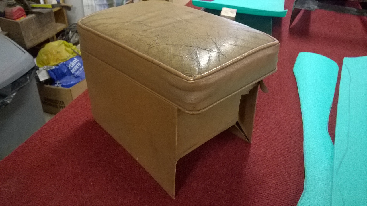

The 2nd pic shows the cubby box, as it was.

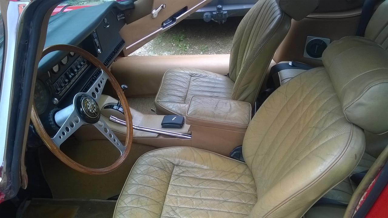

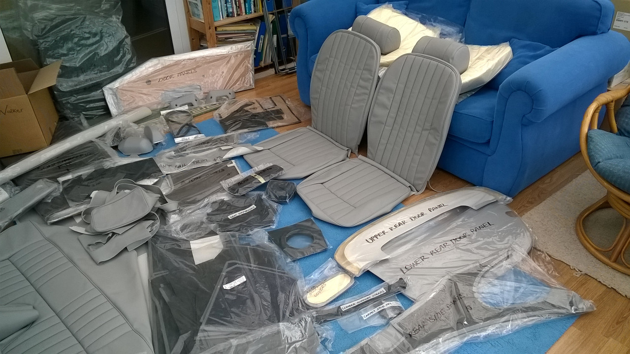

The 3rd pic shows some of the kit for the new grey trim........you can probably just about make out the cubby box top, just to the left of centre. The top itself is leather and comes preformed from Aldridge Trimming with the piping already done, seam at the back. The sides are in matching vinyl. I found, from experience, that leather is very forgiving if you happen to slip with a scalpel, but with vinyl this is not the case! I made a false bottom to the cubby box from thin mdf and covered it with some spare vinyl. You will probably notice that the top is a bit deeper than standard...........this is because I added some extra foam!

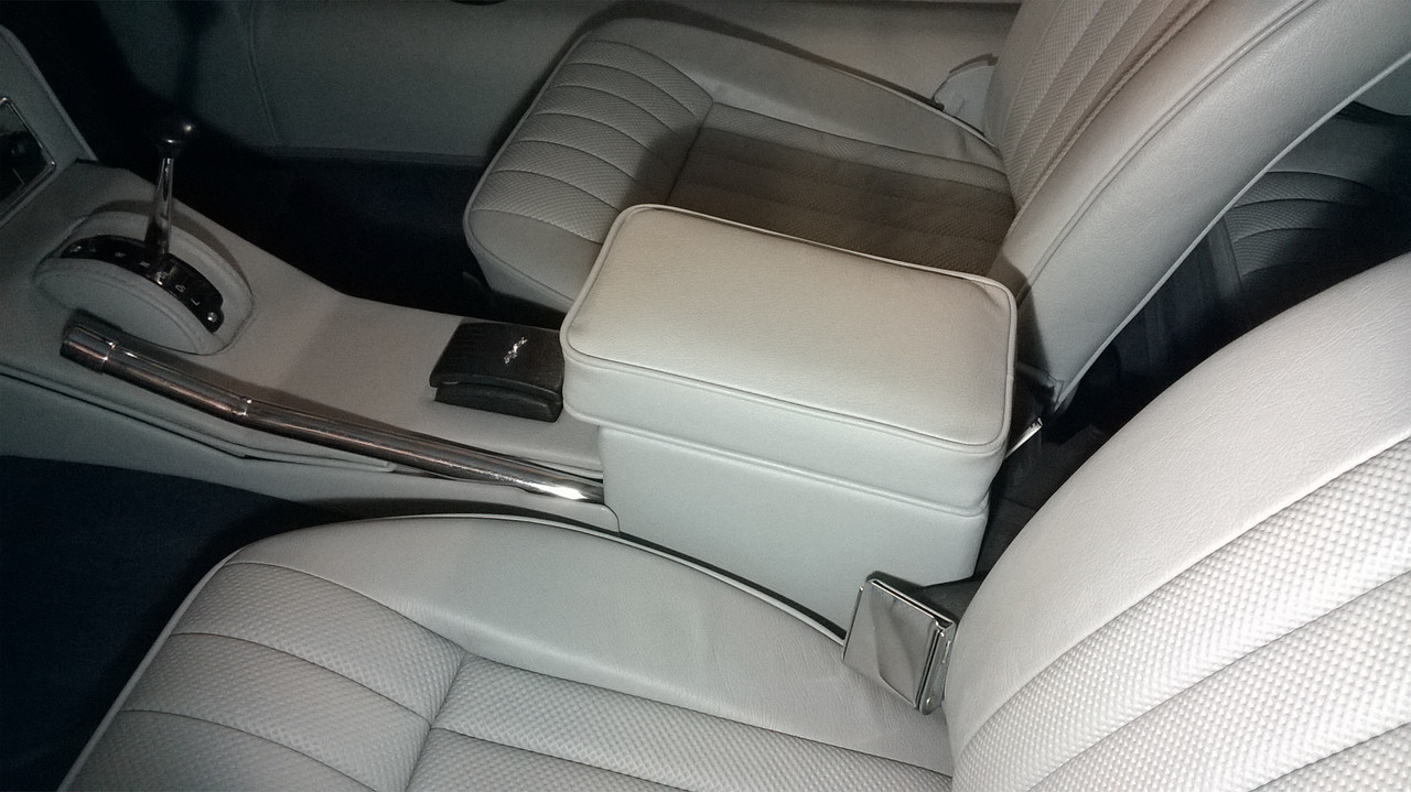

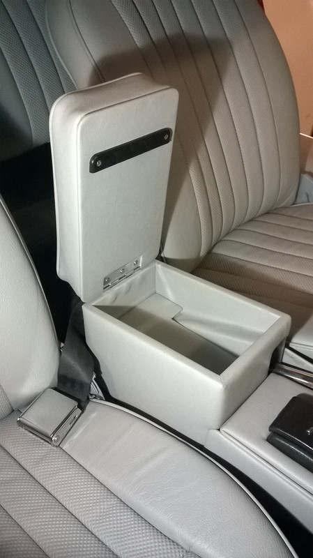

The final photo's show the retrimmed cubby box in position.
