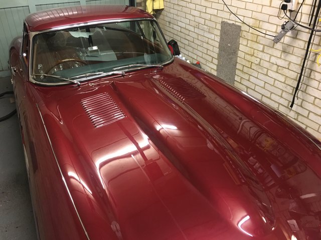

Many thanks to Angus and everyone at Moss Jaguar for being the salvation of my car. Some may recall that the first time I started my fully overhauled VSE engine, it failed. Weak cylinder head stud thread in the bottom of the block. Engine out again. Got very lucky with a local engine rebuilder who had done this thread repair before. Engine back in again. Start the engine again, and as the engine fires, there is a slight rattle from what appears to be the front of the engine, but the rattle is not there once the engine is running. Retighten the top chain. Very slight rattle as before. Drive the car 500 metres and the brand new clutch [fitted by VSE] fails. Looking through the bell housing hole, the boss in the centre of the diaphragm is obviously loose. I'm starting to despise the car which has become like the Sword of Damocles and I cannot stomach replacing the clutch. Despite being extremely busy, Angus agrees to take the car, and sure enough, once the engine is out again, the boss in the centre of the diaphragm has in fact become completely detached. Another really good spot by Angus was that the oil pressure sender was 90% held in place in the filter head with loctite as the thread was virtually stripped. Again, VSE's work !! Anyway, I collected the car yesterday and drove it 100 miles home and it is quite sublime to drive, with the engine running silky smooth thanks to Angus's tuning. But keeping it below 2500 RPM for the next 400 miles? Hmmm! And lo and behold, the rattle has gone. Obviously the noise was caused by the loose boss clattering just as the engine fired. As well as the clutch and engine tuning, and a number of other bits and pieces, it was great to have my nut and bolt restoration thoroughly scrutinised by a heavyweight Moss inspection. But why have Angus and Murray really ascended to legendary status? Because they fitted my brand new gutter trims for me. No seriously, what a great bunch carrying out fastidious work. And I can thoroughly recommend the Victoria sponge!

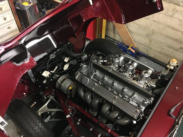

The exhaust manifolds look good - are they ceramic coated ?

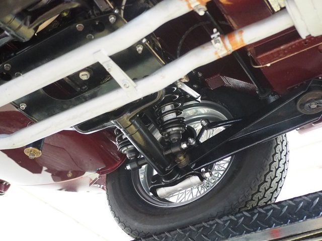

mach2andy

The exhaust manifolds are, I believe, originals. They were on the car when I bought it, and are in remarkably good original condition. Or to be more precise they were in one of the many boxes of bits that came with the car including a pair of NOS manifolds the I eventually identified as S Type which I sold to a guy in Sweden.

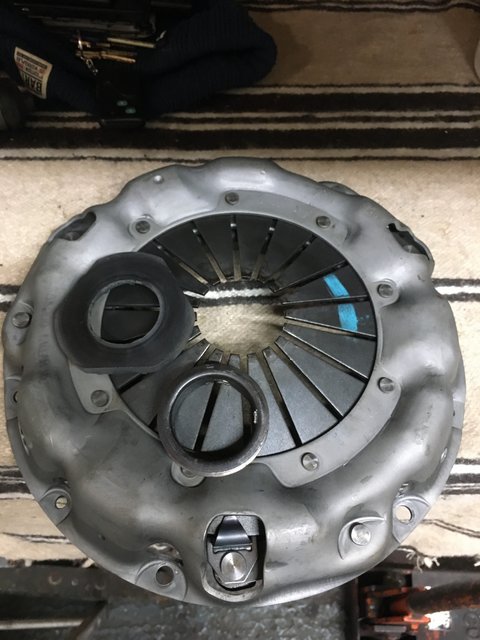

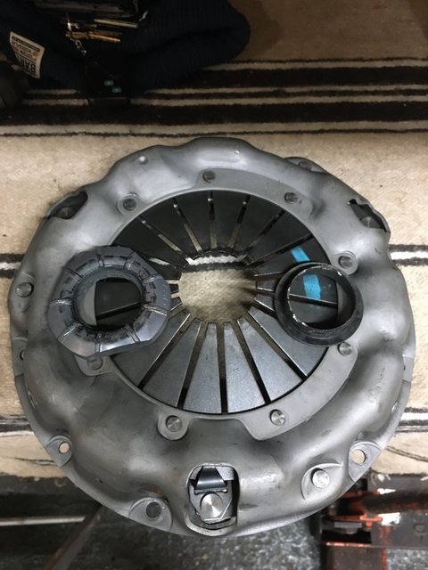

I thought I'd just post a couple of pics of the clutch cover from my car that failed after less than a mile. The manufacturer appears to be AP. I sincerely hope that nobody else reading this has had a similar failure, but if they have perhaps contact me?

I have an AP clutch cover in storage awaiting the arrival of a new 5 speed box which looks exactly the same as the pictures above, I have some numbers stenciled on the cover as follows;
M49A40,
09L7E05000,
in an AP box identified as CA4562 240mm,
Please tell me this is not the same batch of cover that failed as above?
Chris

Chris....i would call the manufacturer...tech support and see if they can help......Steve
