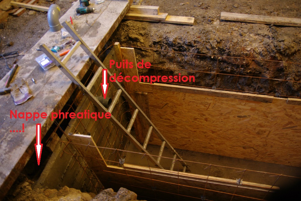

I dug a pit in the Buxton workshop I built into a raised bank.
Wood is extremely stiff for its weight (on a par with steel depending on grades). It was a comparatively narrow pit to accommodate old narrow vehicles. The unsupported span was of course considerably shorter than the timber length, and you’d only ever have one wheel supported If its narrower than the track.
My problem was slow seepage at the joint between the bottom poured membrane slab and the water resistant concrete walls. Because the pit wasn’t used all the time it was a pain to find a couple inches of water and drop a spanner if you tried working on raised wood. If I ever did one again I’d use a one-piece fibreglass liner.

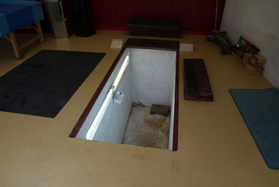

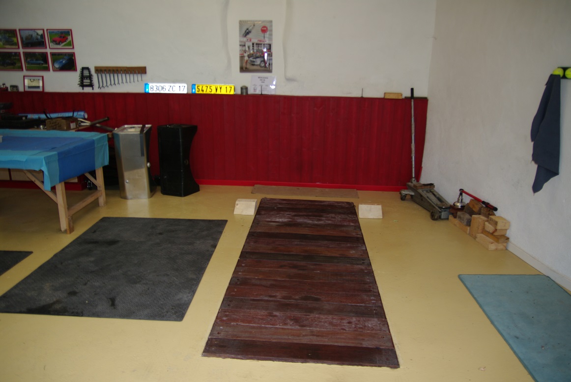

Hi Alan , if you are on the pit: make a good ladder with flat steps it's so easy to use when you have tools , oil pan, or beer in the hands...!
Yes the timbers are quite heavy but i take off only some of them when i use the pit . Drill at each end 2 holes for your fingers and at each edge timber i fitted a solid string more easy and quick for the first move
I also have fixed two solid wheel stop on the ground so no problem with the wall .... just in case ! and i know what timber i have to move for acces for oil or wheels ETC...
