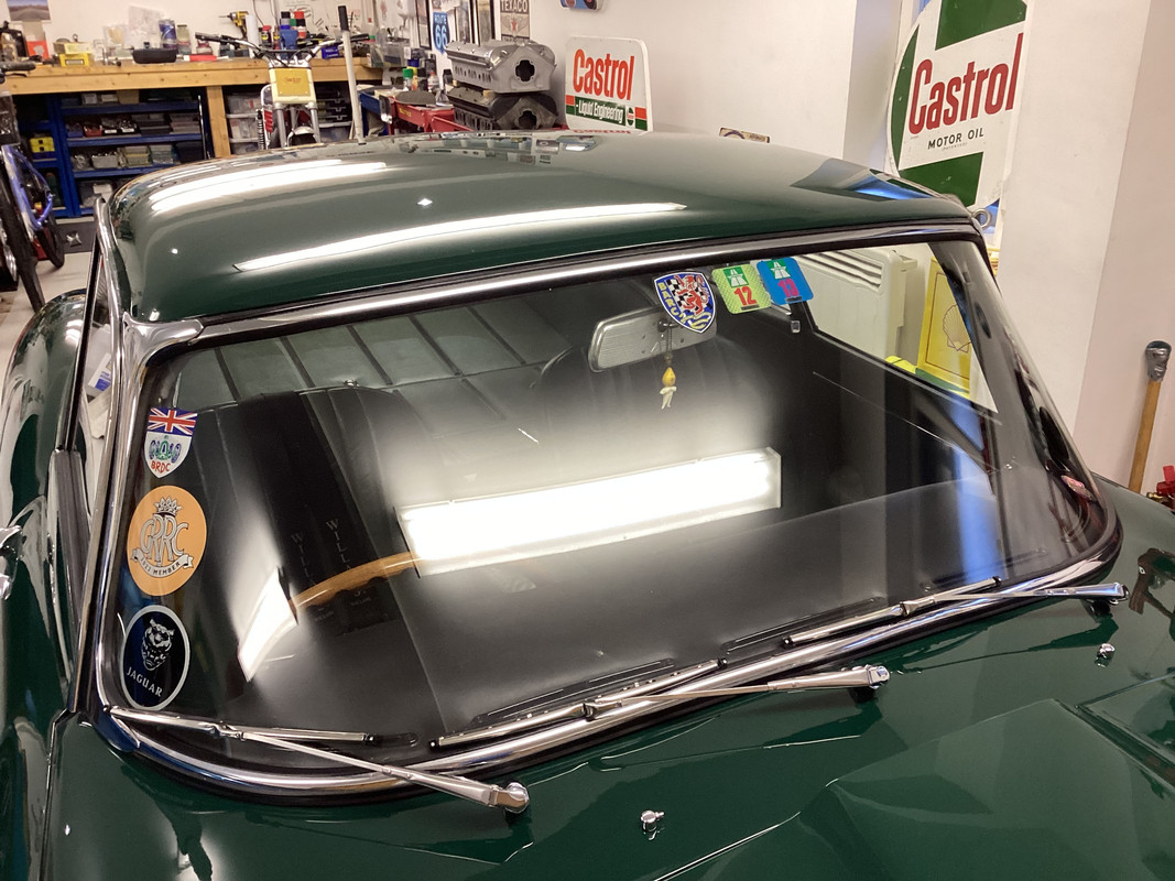

Post by caveman » Mon Nov 28, 2022 8:17 pm
Here’s mine Danny, I’m not a fan of arms/blades too high up.

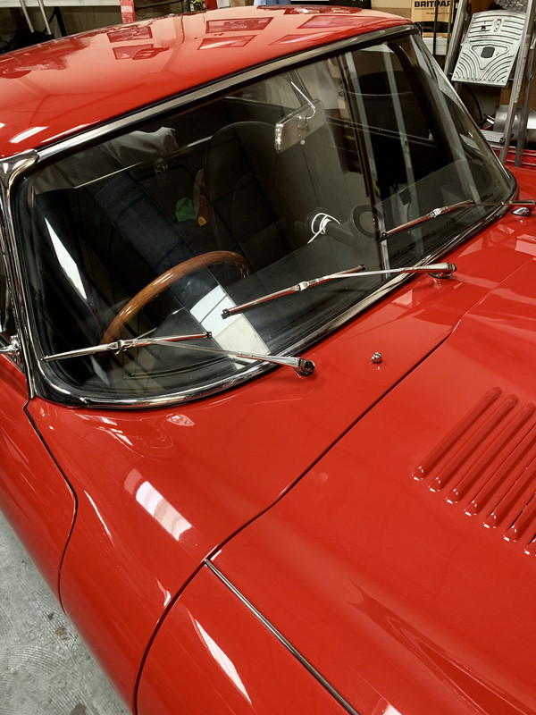

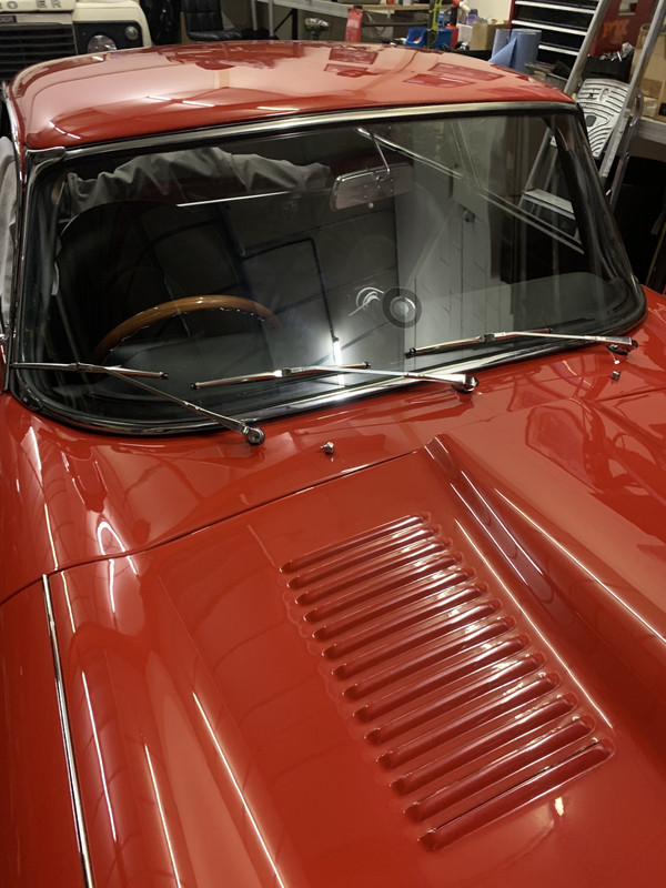

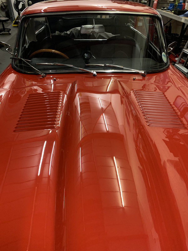

I find any make of cars with wipers way too high up the windscreen just don’t look right.
Here are mine :-

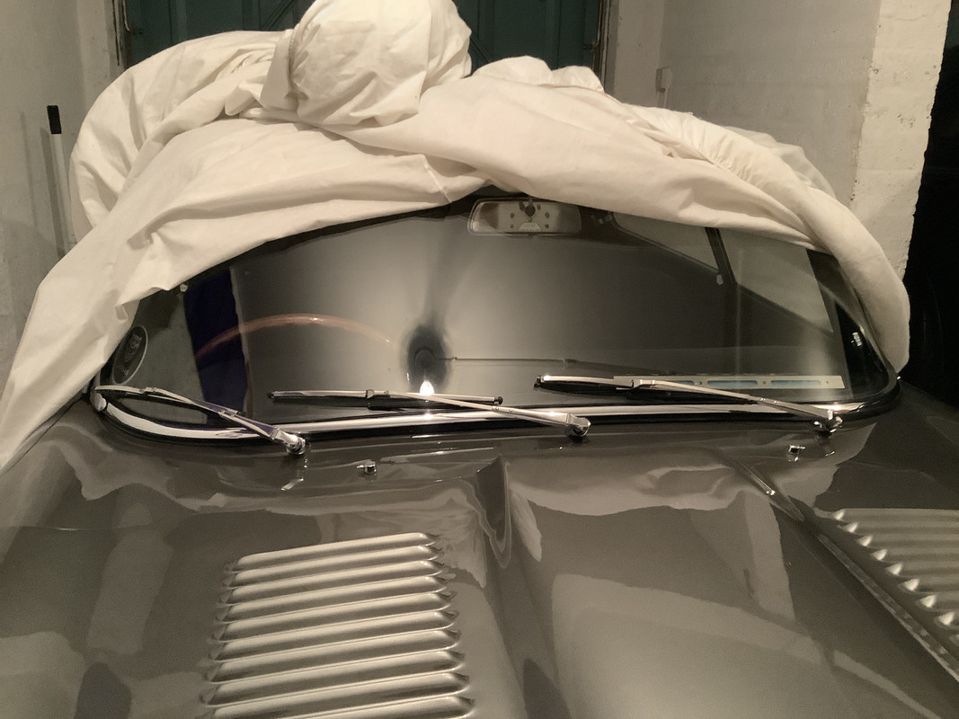

Post by Allrand » Mon Dec 05, 2022 6:08 am
Very difficult to get the driver side one to look right, I don't like the position over the bottom trim. I straightened the kink in the arm a bit, looks & lies better.
