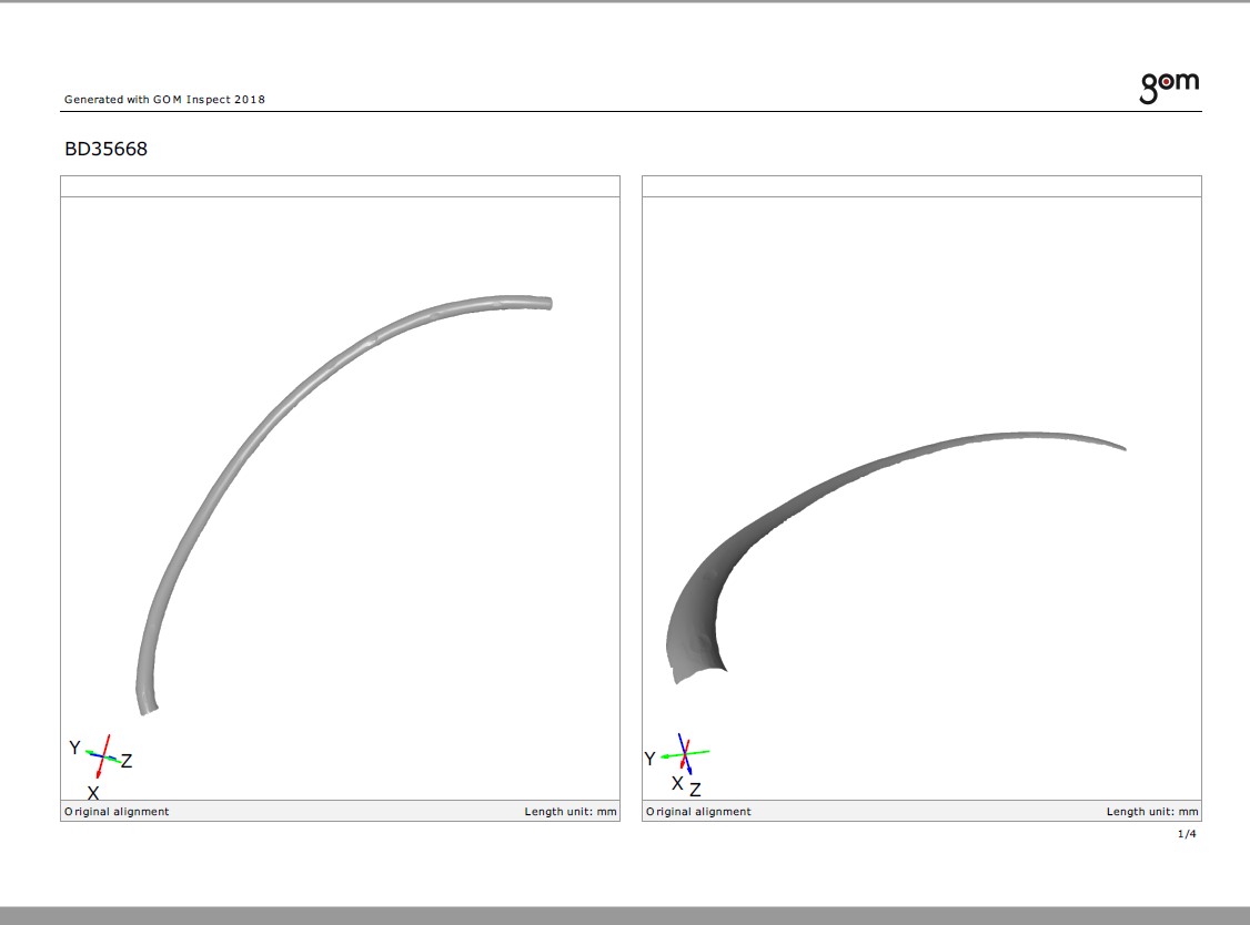

Hi Julian,
You were looking into the fitment issues on the S2 and S3 headlamp chromes last year and said you would post some pics up of them on your S3. I just wondered how you had gone on?
To update on this one, we have done 3d scans of the bonnet and we have revised profiles for the surrounds completed in CAD so we are now working to find a supplier who will make these for us. Currently, we are not sure that there is going to be a cost effective solution to this but its one thats in the pipeline and i will make a note to report back again in a month.
Its not especially revealing but i have attached some of the scan data that we are working from. As i mentioned, we will look to produce these in unchromed version when we get there.
update - i have just tried to upload the data but the file is too large so its just a screen grab.

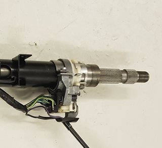

Post by Heronscourt » Thu May 13, 2021 8:02 pm
My current issue is that when I locate the indicator / horn push mechanism to the top of the steering tube I just purchased, attach the cancelling finger to the column and insert it in the tube the column does not protrude from the bottom of the tube sufficiently for me to locate the universal joint. The notched white plastic ring in which the cancelling finger locates extends about 2cm past the top of the tube. I’ve seen a thread showing a tube which appears to be about 2cm shorter than mine but is obviously from a much earlier car. I don’t think you have a tube with the top section 2cm shorter, most other tubes are listed NLA. The solution appears to be to shorten the top of the tube by 2cm approx, relocate the top elastomer bearing thus allowing the column to protrude sufficiently through the bottom of the tube. There will still be space for the indicator shroud and the plate which houses the ignition switch / key. No lock! This seems the only solution unless you have an alternative tube hiding somewhere. Hope you find this interesting.

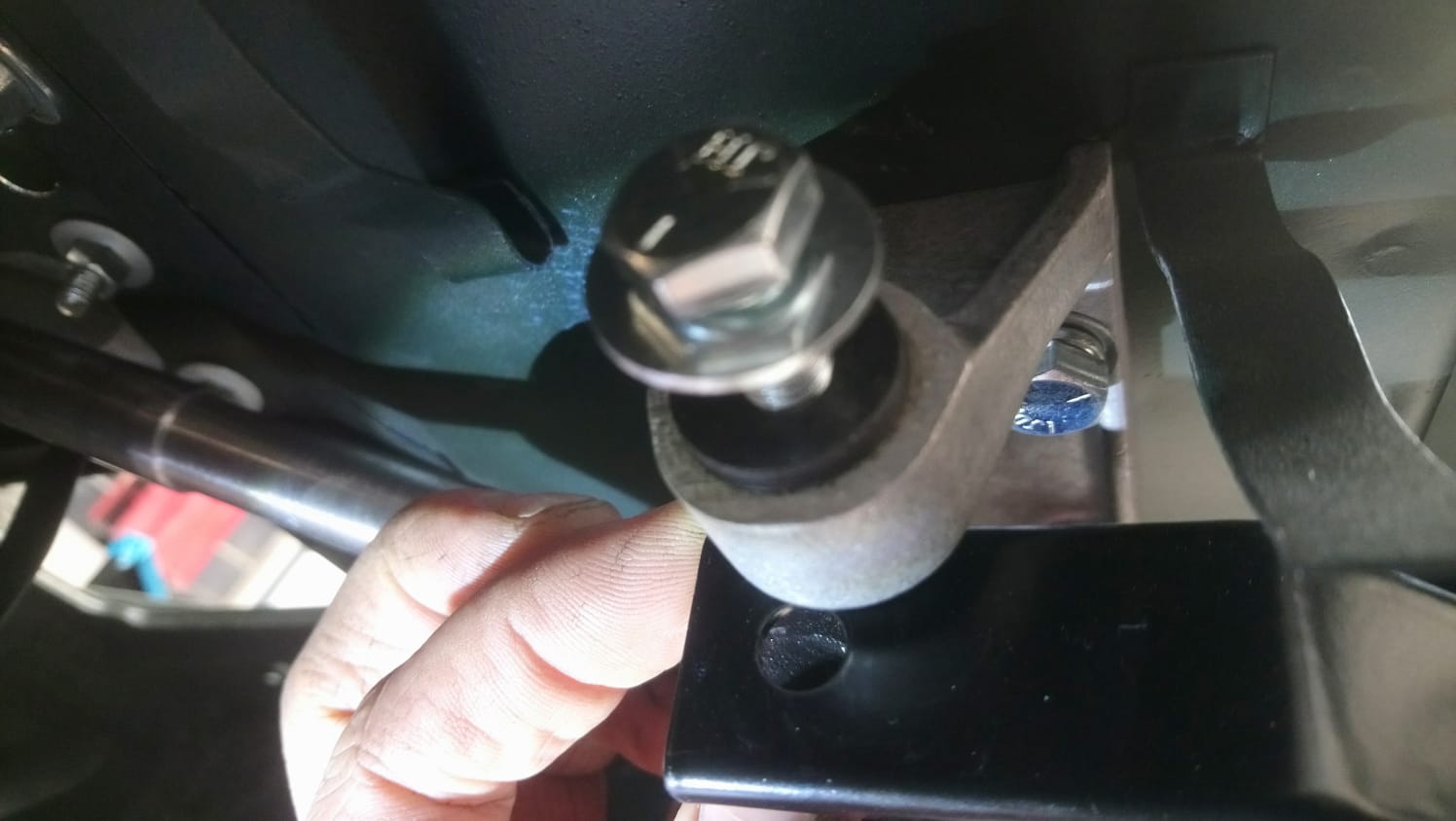

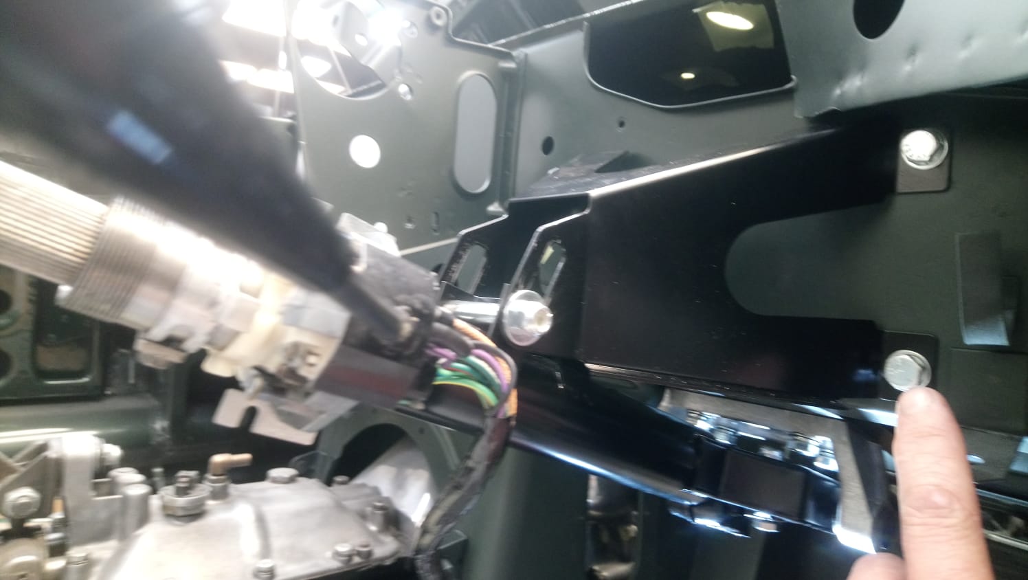

Post by Heronscourt » Fri May 28, 2021 12:58 pm
My latest issue is that the holes in the forked end of the steering tube do not line up with the holes in the lower alloy mounting bracket by around 5mm. Is the solution to put spacers between the upper bracket and dashboard to move the tube backwards to get the holes to line up. There seems to be enough adjustment at the upper and lower UJ pinch bolt slots in the column to allow this solution. Is it a safe solution.
Alan R
Etype series 1.5 roadster 1968
Heronscourt
Posts: 86
Joined: Thu Jul 09, 2020 4:19 pm
#146 Re: SNG Barratt User Group
Post by Heronscourt » Sun May 30, 2021 7:36 pm
A further thought on the issue of the steering tube and lower bracket bolt holes not lining up. It’s been suggested that the arms of the fork could be re cranked to move the fork holes back to line up with the bracket. This sounds a bit problematic but what about detaching the arms of the fork from the tube and re attaching them 5 mm further back up the tube? This would have the same effect without the risk of damaging the arms whilst adjusting the crank.
Alan R

#147 Re: SNG Barratt User Group
Post by 265bhp » Sun May 30, 2021 8:00 pm
Hi Alan
Are you sure you have wriggled the splined end of the steering column all the way into the UJ assembly...I say this as I had the same issue myself and found a little perseverance solved the issue..
HTH
Jonathan

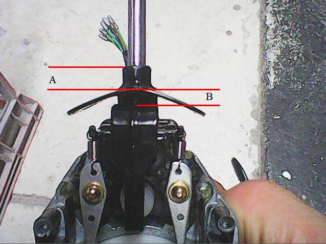

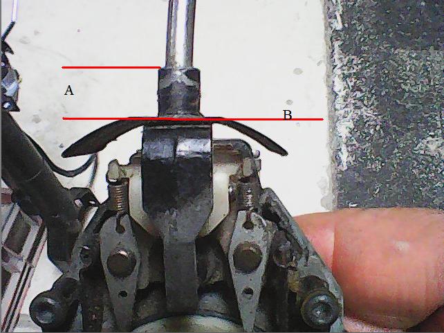

Hello All,
Is there anyone that has their 4.2 Series 1 2+2 dismantled to some degree, or anyone at all, willing to compare the Trafficator assembly with the following pictures and tell me which component pictured it matches? I believe that the Trafficator assembly of a 4.2 Series 1 FHC is the same also.
The first picture is an original part, the second, a new replacement part. You will note that the winged shield in the second picture is further away from the centre line of the Steering Column by dimension "B" than the original part. Dimension "B" for the new part is circa 6mm and Zero for the old, original part.
I have three other 4.2 Series 1 2+2 cars in work for comparison and all are as shown in the first picture. Despite this, I'm being told that the new parts are being made to correct, original drawings. I doubt that I have in my workshop, the only four cars in the world with non standard trafficator assemblies, not made to correct and original drawings. Accordingly, I'd like to know how the Trafficator assembly on other like cars in the world are configured.
The New Trafficator assembly, with the winged shield further out from the centre line of the Steering Column, has the shield foul with the Steering Column Shroud, preventing the attachment of the assembly. The only remedy, apart from dismantling the new part, altering and repainting it, is to make the obround hole in the Shroud larger so that the shield can pass through and sit on the outside of the Shroud. One, this is going to look rubbish and two, I refuse to mutilate an original part to accommodate an After Market part made incorrectly. Decent Restorers try, wherever possible, to preserve original parts, not destroy them.
The issue with altering the new part, is that this is a relatively expensive part and the time to make the alteration and repaint it, considerable. When you tell a client, “this is the price of the new part and by the way, I have to charge you that much again to make it fit”, they would have to think that you’re having a lend of them. Buying this part and then having to alter it to make it work, is tantamount to buying a dog and having to bark for it.

Hello All,
Just a follow up on my previous Post regarding the Trafficator Switch assembly for the 4.2 Series 1 2+2 E Type.
I've received PMs from members of the JL Forum and in all cases, original trafficator switch assemblies are as shown in the first picture below.
Notwithstanding that I'm told that the assemblies are being made pursuant to correct, original drawings. these assemblies being sold by SNG Barratt are wrong and impossible to fit without mutilating the Steering Column Shroud. Accordingly, if SNG Barratt is being told by the manufacturer that their parts are being made to correct specifications, they are being mislead.
