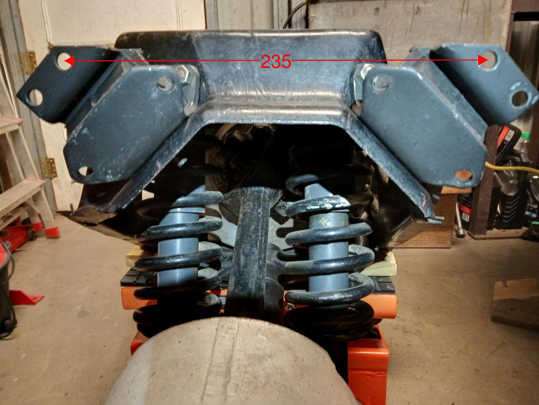

I’m down from 9 mm to 7 mm, at least in theory, this is how much the mounts need to be compressed. Here is photo of new IRS mounts (SNGB C17198U) fitted to my out-of-car IRS:
The distance between the top inner mounting bolt holes is 235 mm (+/-). The distance between the corresponding holes in the body of the car is 225 mm. By simple trig, to align the holes the new mounts will need to be compressed 7 mm. If the mounts were shorter (Bill’s originals) they wouldn't need to be compressed as much (duh).
Here is picture of my load test, of what is required to compress these mounts by 7 mm.
Procedure was: used hydraulic press to compress a mount (SNGB C17198U) by 7 mm; attached load cell and tightened (using Stillsons) until the load started to come off the press. 300 kg, 3kN, 660 lbf … and that’s just one mount. To do it as per the S3 manual, all 4 mounts at the same time, I’d need 1.2 tonnes in the boot to stop the car lifting …

Recently I've had to remove and reinstall the JT5 box on my 3.8 OTS. Because it has a sliding yoke integral to the back of the box you need to drop the IRS to get enough room to install it; a real bugger. Even though the mounts on that car are 12 years old it still wasn't easy.
Aligning the holes isn't just about direct axial compression of the rubber but also about pulling the mount sideways to get the holes to line up.
Most of the time though it does require you to tilt the IRS up or down with a second jack and use levers or screwdrivers, often with a lot of force, to get one bolt in after the other.
I have a couple of small podger bars that I use to get one hole close enough that I can hammer a large Phillips head screwdriver into the other hole, then hammer in the first long bolt. Once that's in you then lever the mount around to get the second long bolt in, after removing the screwdriver.
Getting the small bolts in on the rear mount is often quite tricky.
