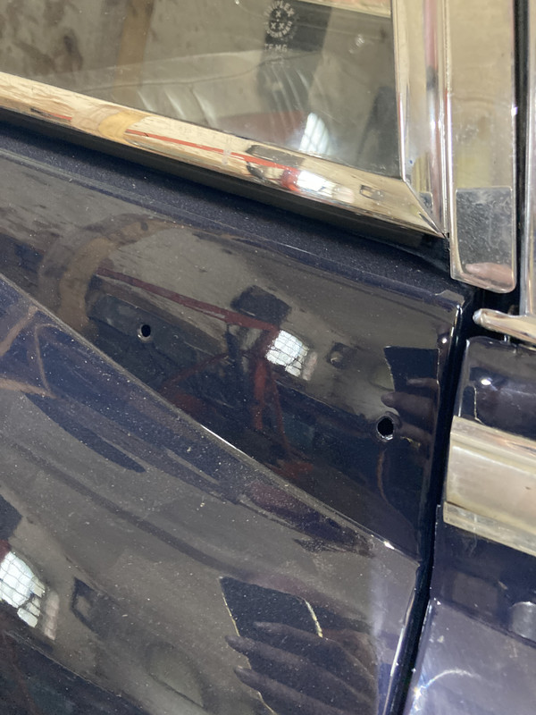

I still could not detect where those two are missing. Maybe I‘ll find that out later, at 180km/h…. :wow:

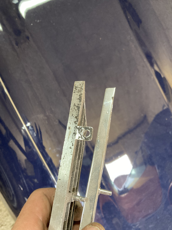

Then, I have 2 different rear bonnet small grilles - one with tabs to hold screws, which is slightly less shiny then the other one which does not have those tabs / which one to use ?

Certainly the one with the two holes. have a look on the bonnet to sea if you have two holes for the nuts.
Mich

Yes there are holes. I thought there should be self- tapping screws ? Not bolts plus nuts ?

Yes, that's what you need.
DId you see my message about the captive nuts ?
Mich
