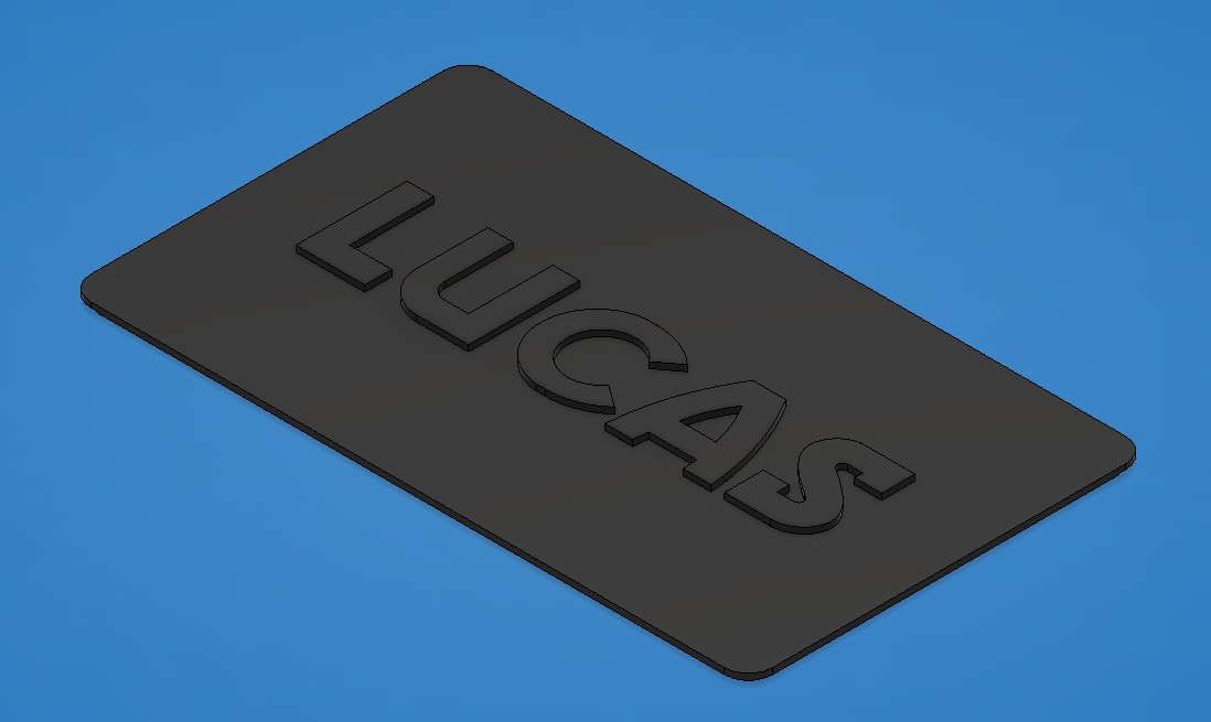

Not a problem to print the raised cover, but unfortunately I don't have one to copy. If I had a good photo and a couple of dimensions, that would be all I need...actually, I really just need the height of the lettering.

I can provide photos and dimensions but not until later next week..

Thanks David - I've actually created the plate with text, but I need a few sizes to correct the scaling of my 3D model. I copied the Lucas logo, so that's all fine.
I need to confirm:
Text font height
Rectangular backplate dimensions, including approximate thickness
Raised height of letters
Radius of rectangular plate corners - I know the other 3D printed version had square corners, but I've seen original battery images that seem to have a radius.
Then I can have a go making a plate to check quality, and see if anyone is interested...
