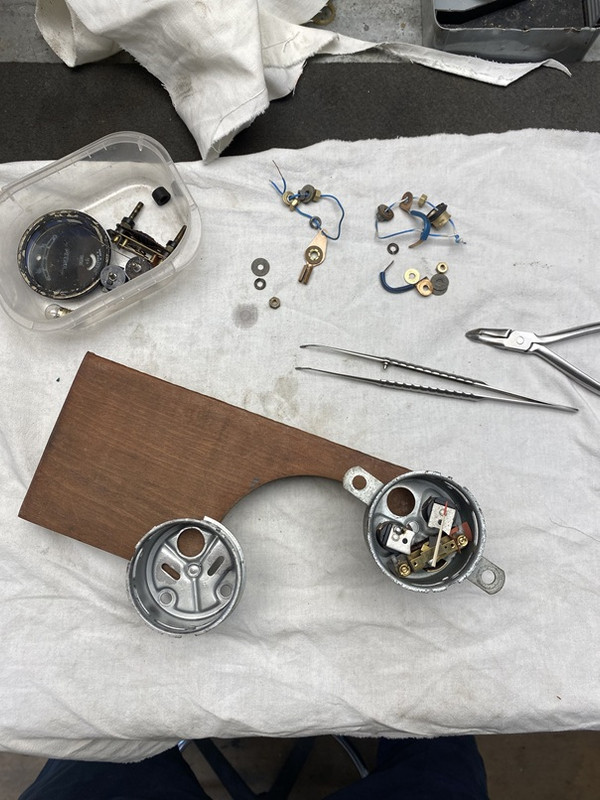

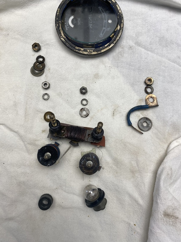

Hi all, it's not for my Etype but for my xk140 FHC which is in "process" .I am refurbishing the fuel gauge with a swap from a 150 one to fit in the casing of the 140 one which is different. I have checked all wires, soldered all the very thin wiring but i am blocked when i must calibrate....! even with many different resistors to mimic the fuel sender.
So where can i send that gauge for calibration ?

Yves, have you considered Speedograph Richfield? https://www.speedograph-richfield.com/

I have an answer today about RICHFIELD : they can refurbish and calibrate the fuel gauge as they do on speedo!
Even it's a very different magnetic adjustment skill :thumbsup:
