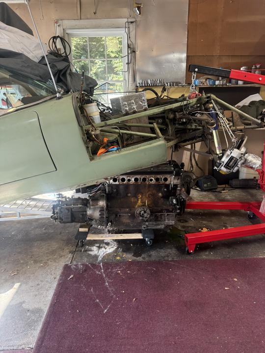

On my current E type, I removed the engine for a rebuild by lowering the front of the car to position the engine/gearbox onto a dolly then roll it out the front with the picture frame assembly removed (I was doing a suspension rebuild as well). To replace the engine (without the water pump, as I recall) with the picture frame assembly and suspension in place, I was able to manually lift the front of the car and wheel it (using the rear wheels) over the engine/gearbox, then lower it enough to allow the engine front mounts to bolt up. No lift involved. Just a hydraulic jack for the main lifting, and a scissors jack to lift the gearbox end to start those bolts.

You need to have the engine on a trolley and blocks so that the bottom of the sump is at least 12" above the ground.
You can use an engine hoist to lift the front of the car up and over the engine; I have done this a number of times. If you have the rear of the car on jack stands it is easier to get the required height.

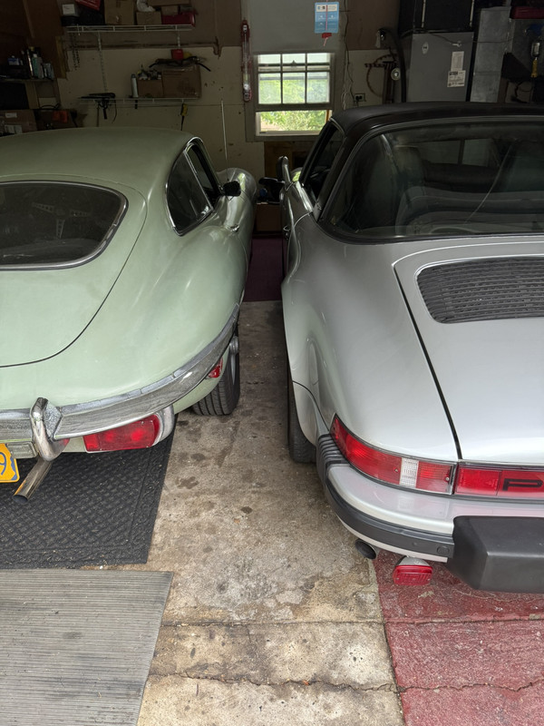

Thanks for the replies. I don't have room for a 4 post. My garage is barely wide enough for my 911 and Jag. Vertical clearance is just 8'6". I think a mid-rise lift of some type is my best option. I'll simply park over it as I do now with the quick jacks when it's not needed.

My garage simply doesn’t have enough width for any type of posts. Years ago, the previous owners added a bathroom off the kitchen, shrinking the garage from a comfortably sized two-car space to what I’d call a one-and-a-half-car setup. I typically park the E on the left, carefully squeezing out the driver’s side, while the 911 sits on the right. Exiting the 911 requires a bit of maneuvering—I shimmy over to the passenger side and slip out through that door. I’ve tried backing the 911 in to avoid this, but the garage is so narrow that I don’t want to risk clipping the E-Type.

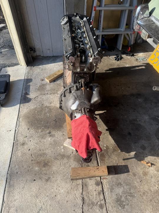

Just to follow up, the Quickjack as others pointed out, doesn't go high enough to slide the engine out. It's not even close. I put the rear wheels up on my ramps and simply lifted the front up like so many others have done.
