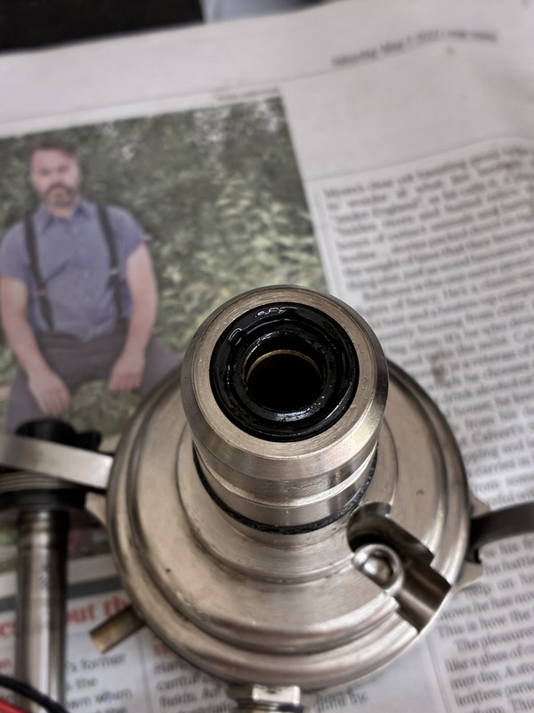

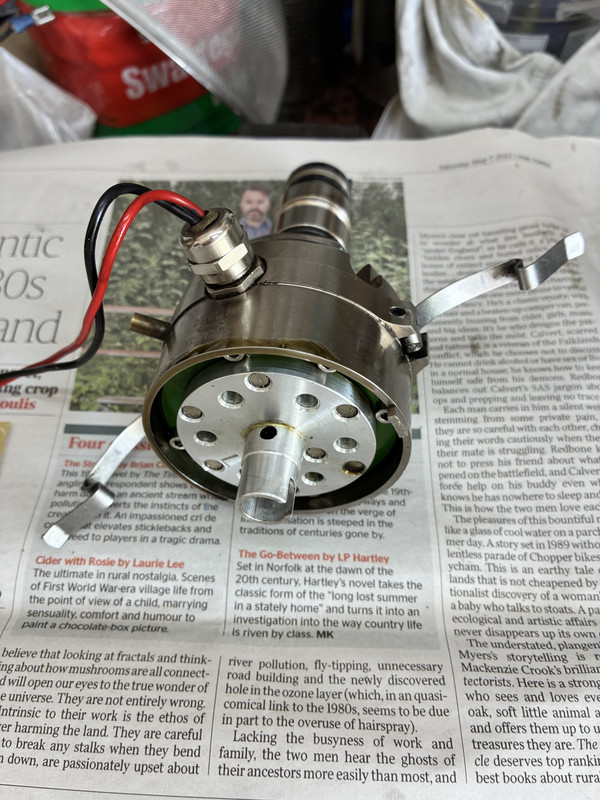

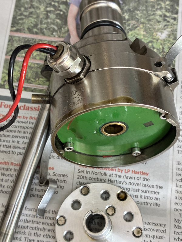

#5 Re: A curious thing is happening
The 123 dizzie…
….removed from the engine showing no signs of oil on the outside of the unit.
Inside, however, lots of oil once the central drive shaft had been removed.
There is an oil seal at the base of the unit, clearly it has failed. It is a standard metric size, single lip seal. I’ll replace it with a dual lip seal.
