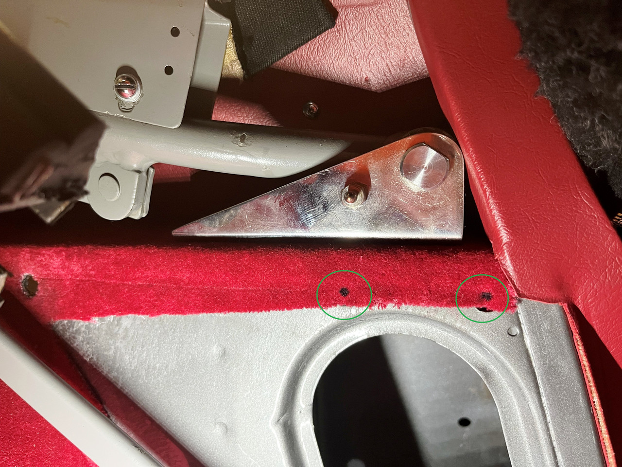

I may need to find a Hard-Top for an event that I am considering taking part in.
I have never looked at one of these close up and have no idea how they fit, or what you do with the hood etc - pretty basic questions I know.
Could somebody confirm that you just leave the hood in place, presumably under its bag, that they just fasten on brackets on the haunches next to the hood frame pivots, have the same clips / catches as my standard hood, and have the same capacity to have the cantrail rubbers adjusted to fit (a vague concept, that I do know) the window glasses ?
Please hold my hand.
My hood-pivot brackets are a stainless version that may not be like the originals, but my shell does have the threaded lugs to take the mounting bolts for the hard-top brackets.
Where does the Pull-To-Lift stud for the hood-bag sit once those hard-top brackets are in place ?

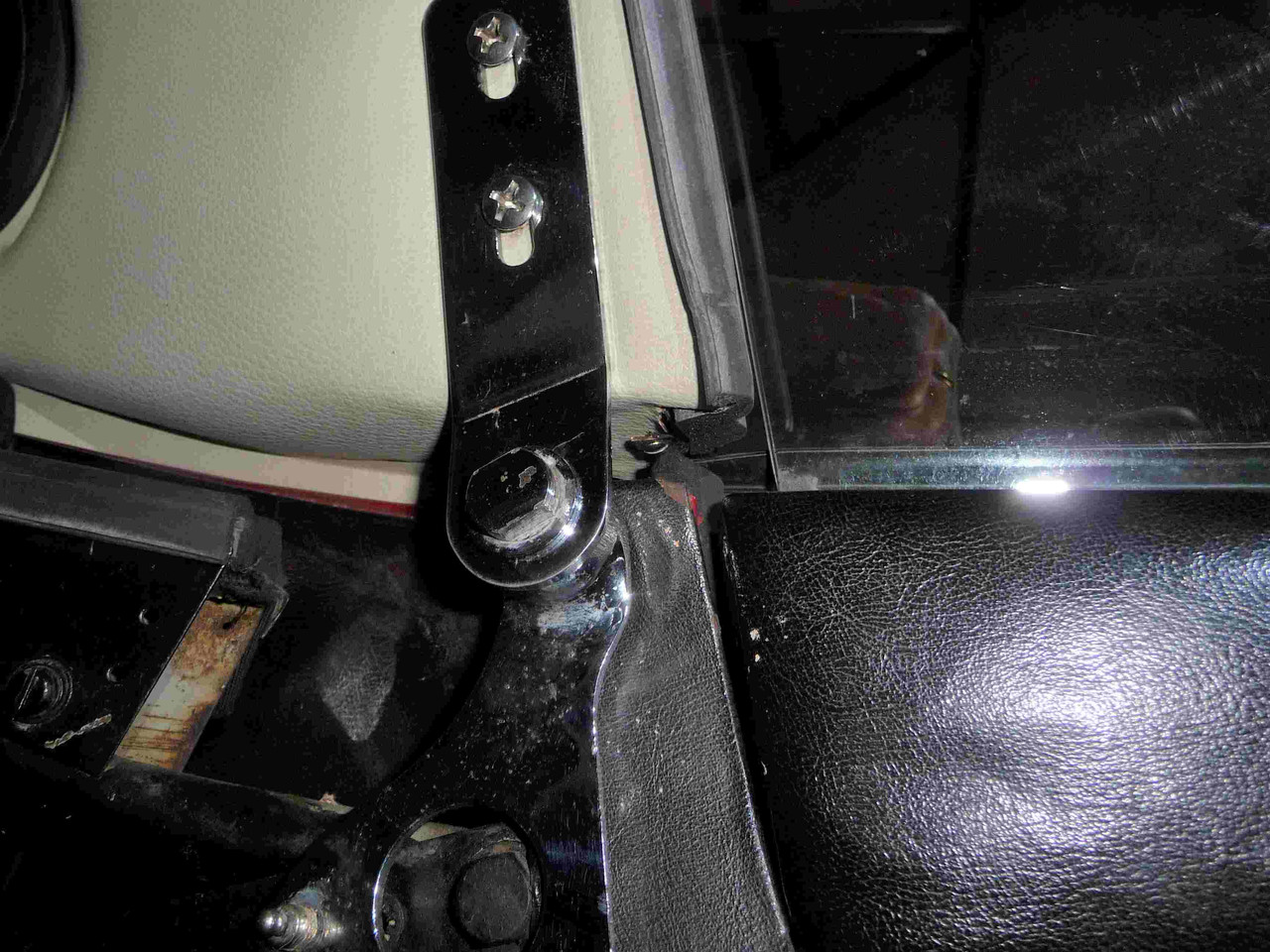

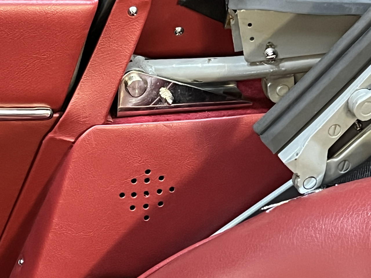

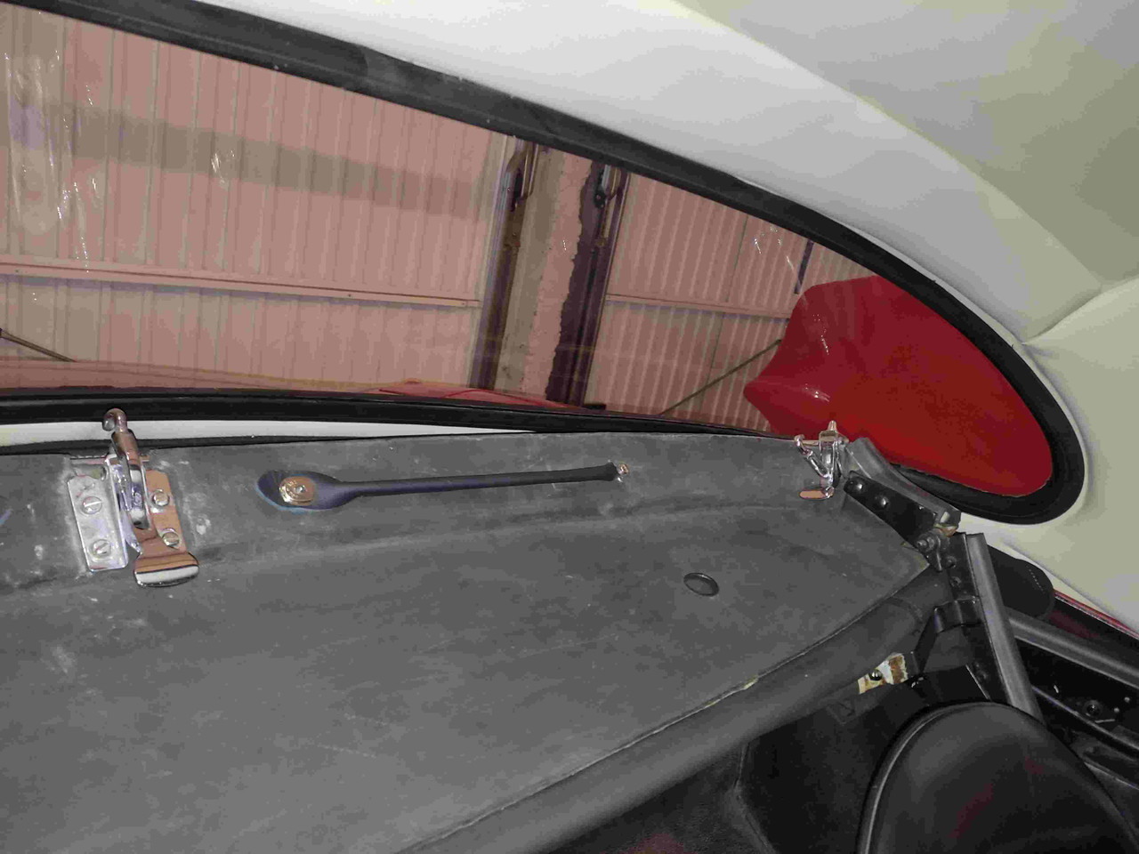

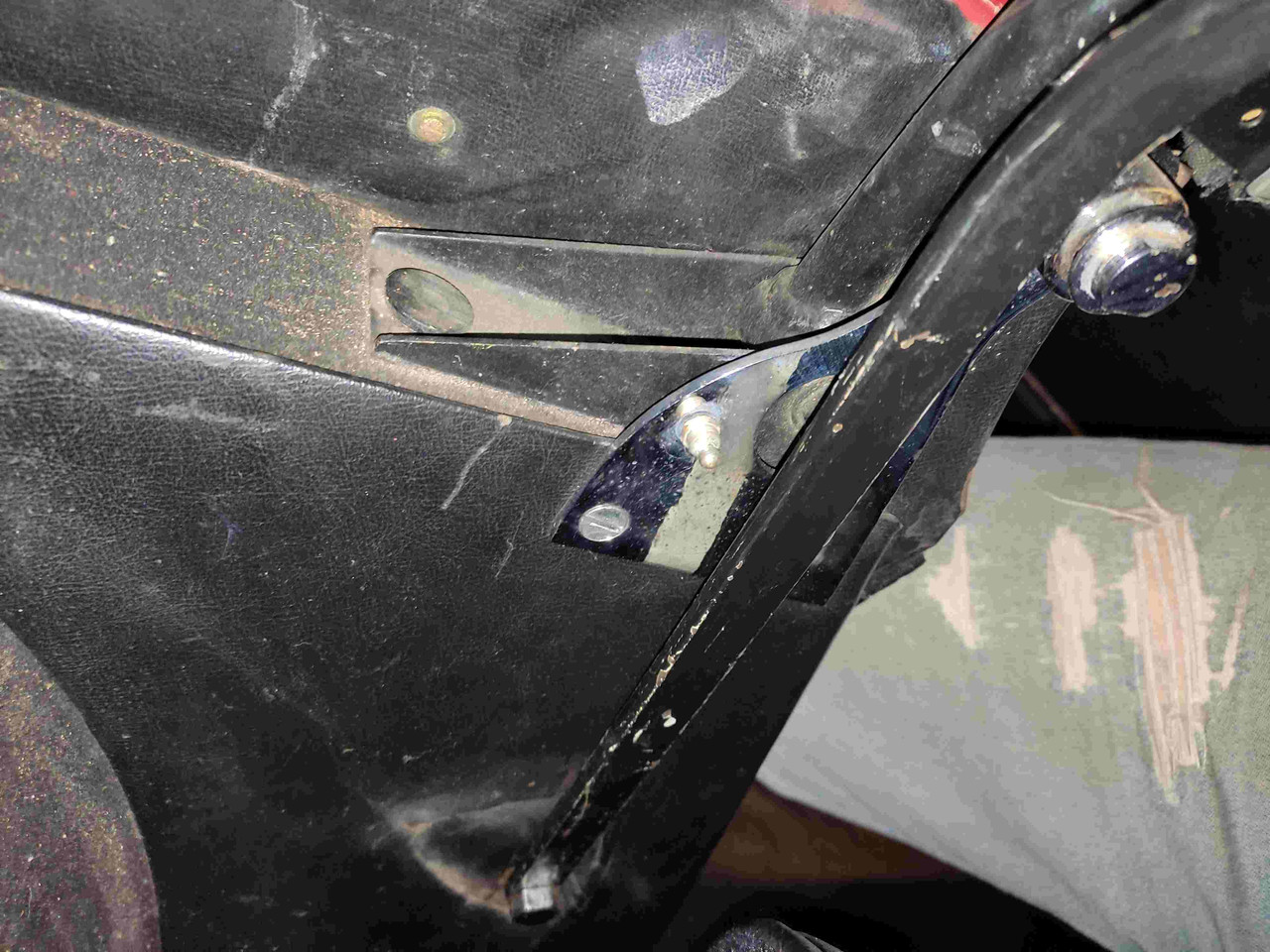

Hi Rory,
Here a few pics of my installation when I put the hardtop.
No need to remove the soft top but you must remove the soft top cover.
Here a detail of the bracket when the soft top is up:
And here a detail of the bracket for attaching the hardtop:
Hope it helps
Serge
