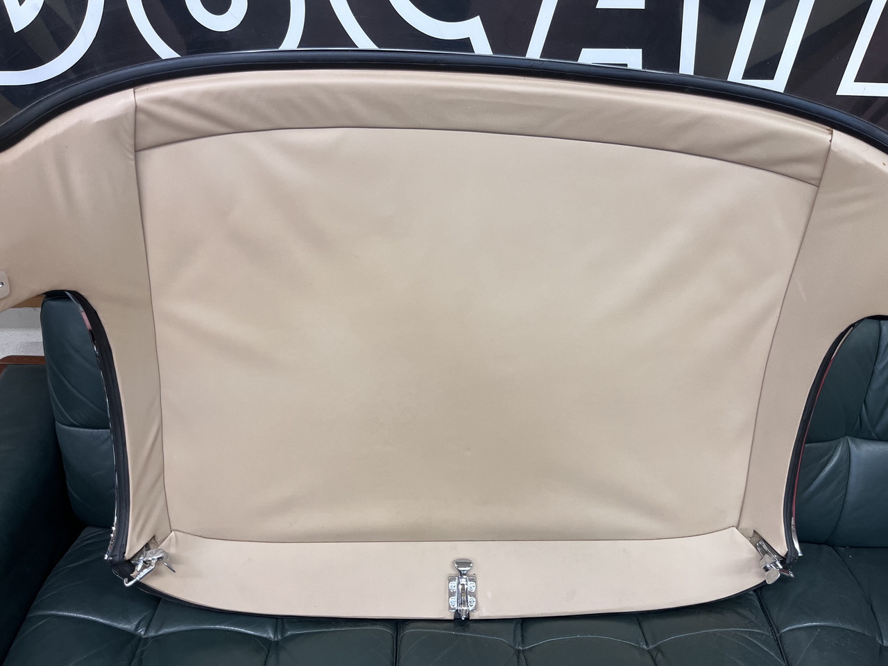

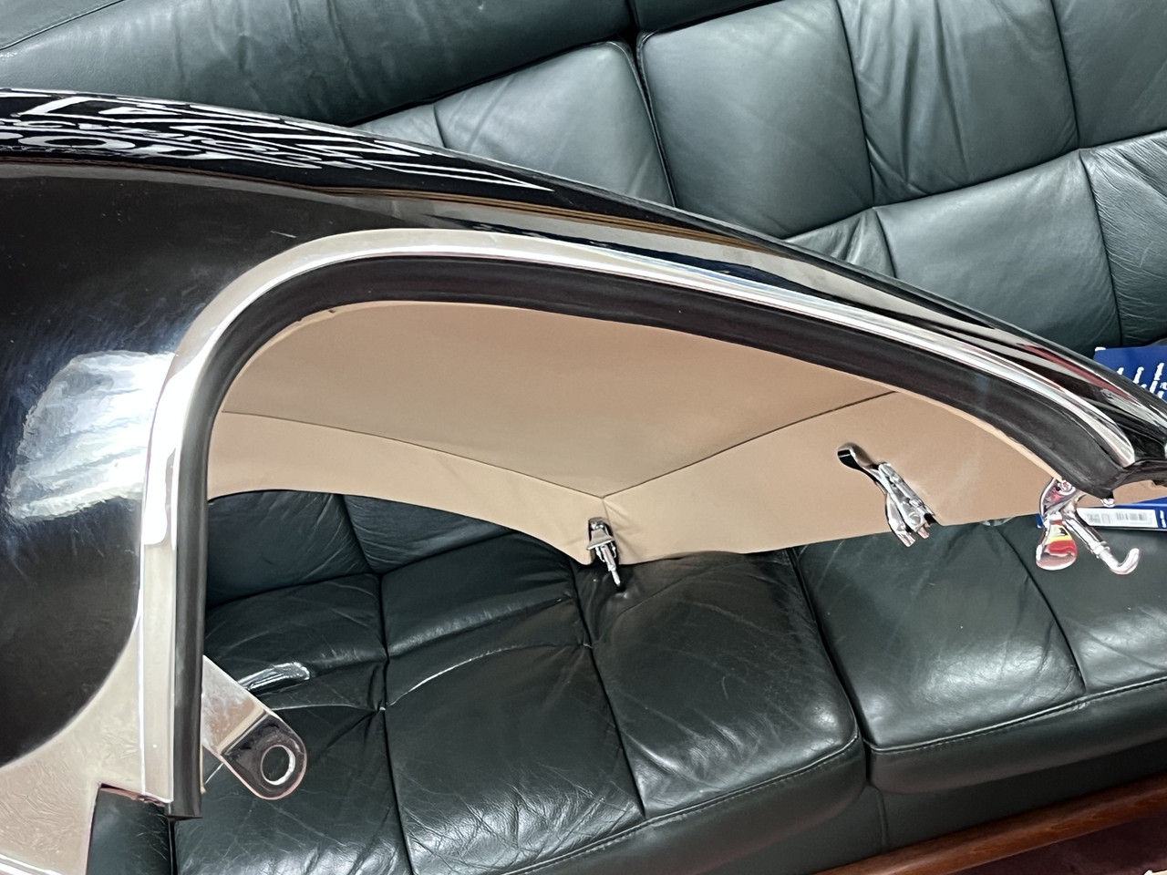

Post by rfs1957 » Mon Jul 20, 2026 3:55 pm
Update.

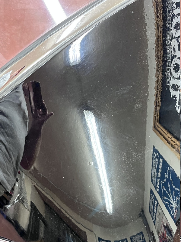

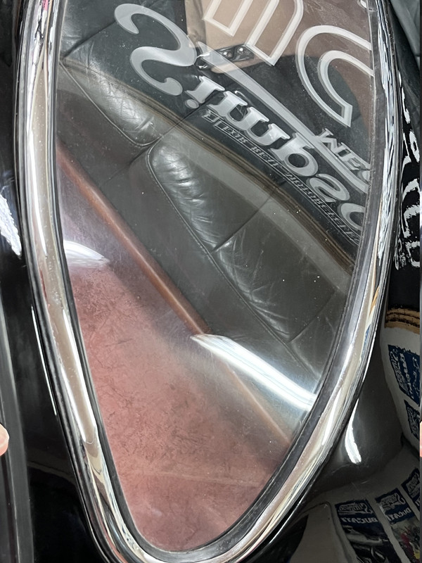

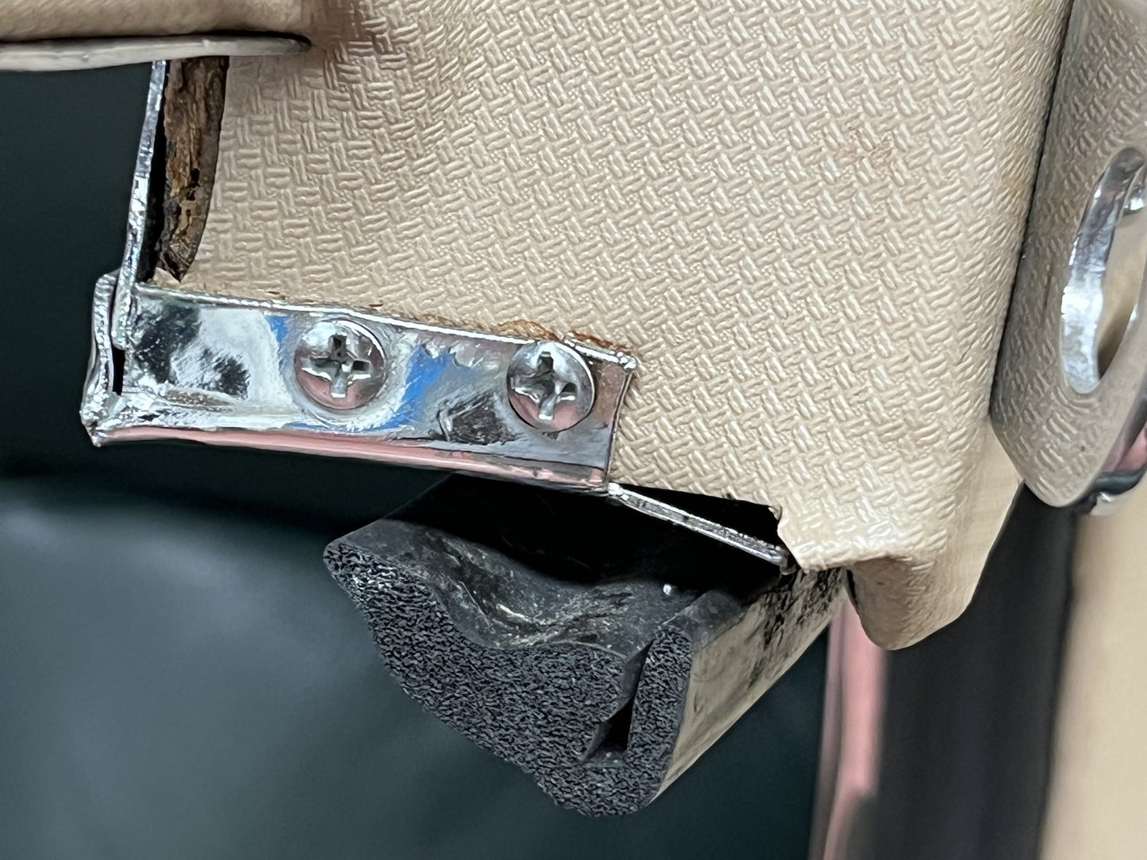

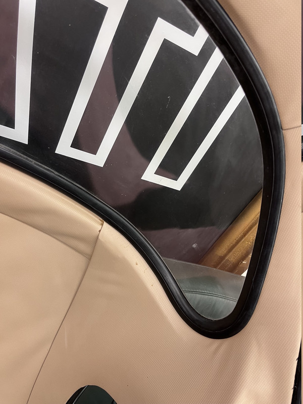

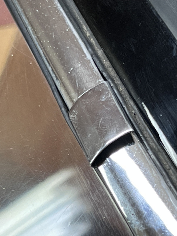

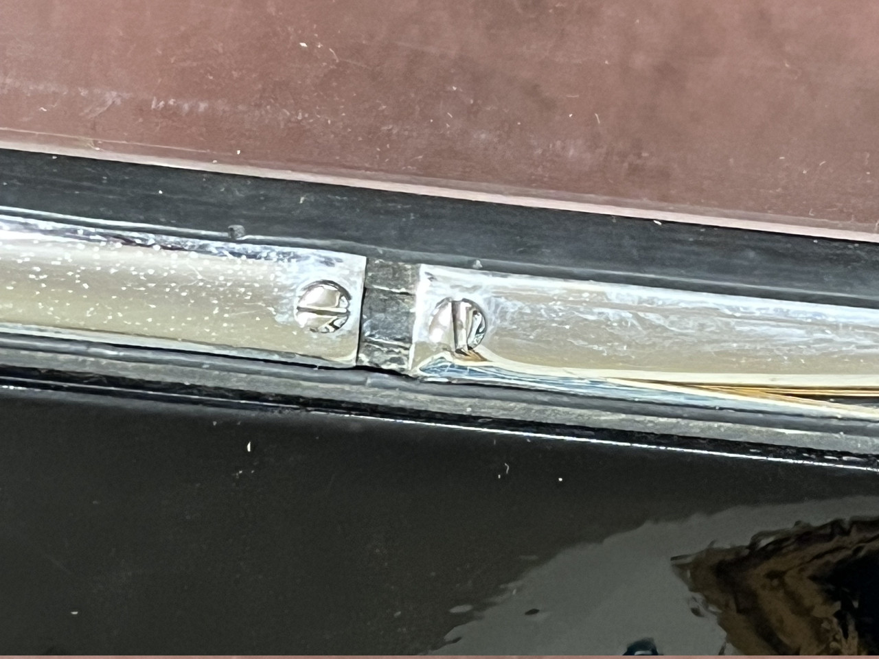

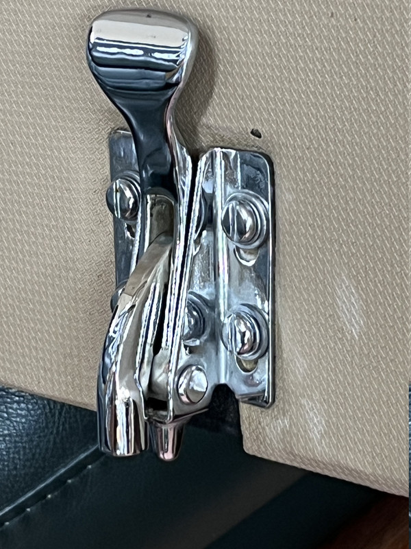

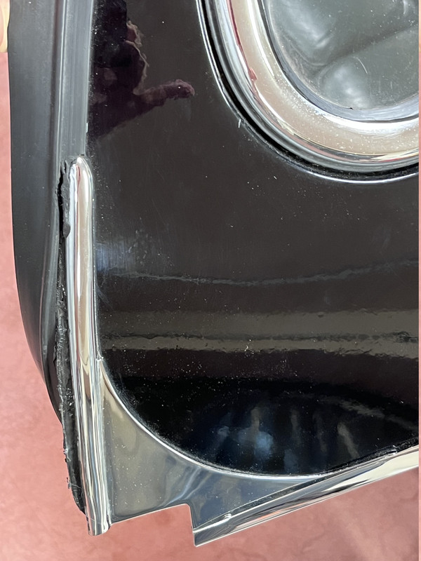

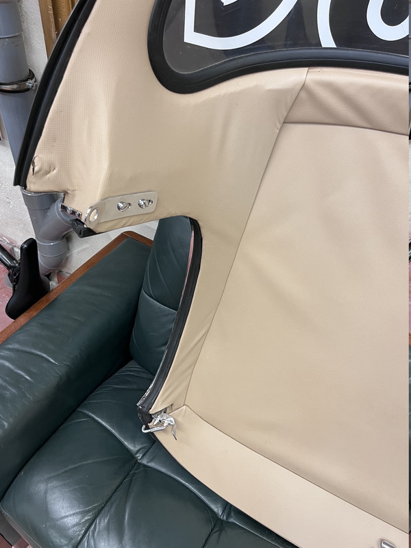

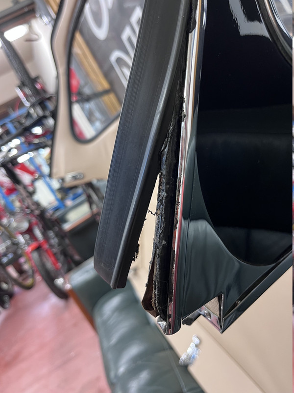

I bought a really nice original one, with excellent chromes, good perspex, and even the lining isn't bad.
The fibreglass looks a bit "hairy" through the paint in places, but nothing too bad.
Could anyone with more knowledge than myself tell me if all that is original ?
Is there an exploded parts diagram anywhere that shows what the trimming panels are underneath, how the cantrails are done, whether the cantrail rubbers are adjustable - once the trim is removed ?
Or am I going to have to become an authority on the subject ? :bigrin:
I can't see anything in the J30 parts book.
It's a winter project :hammerdrill: but I am going to re-do it completely, paint, head-lining the lot.

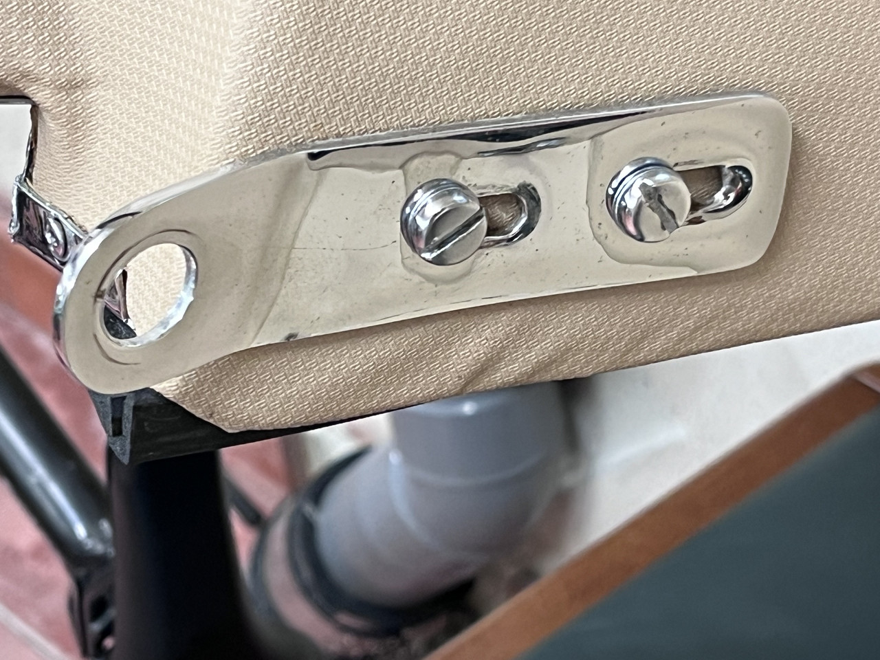

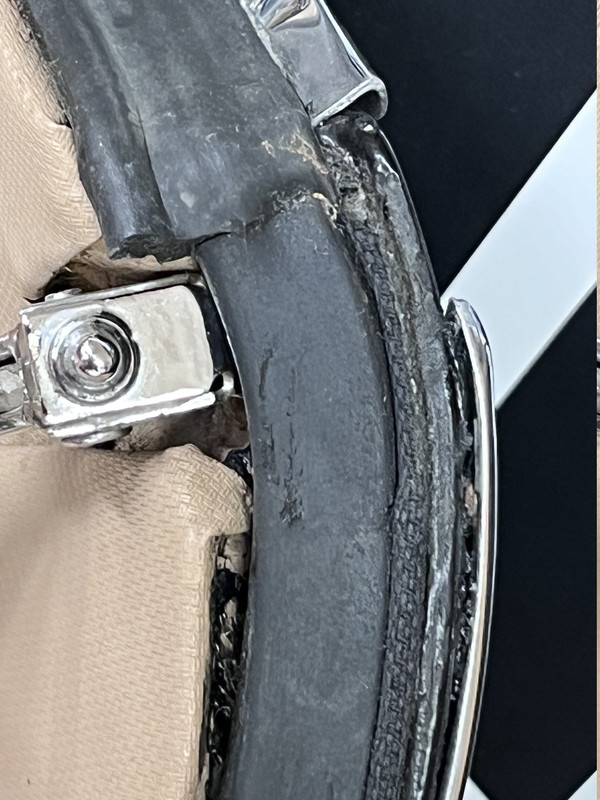

Does anyone know what the reference is of those cheese-head chromed screws, two per side, seen in the pictures, that hold the slotted-hole drop-links that bolt to the cheek plates ?
I did find (last page 322 in J30 ?) some sort of partial Hard-Top parts list, but the screws referred to as BD20092/2 are universally illustrated by suppliers as CSK, PLUS they are only shown as 2 per car, so they cannot be these.

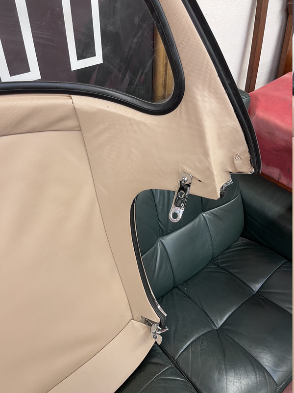

#16 Re: Looking for a Hard Top ……. And Advice.
Post by E703SU » Tue Jul 21, 2026 2:43 am
Update.

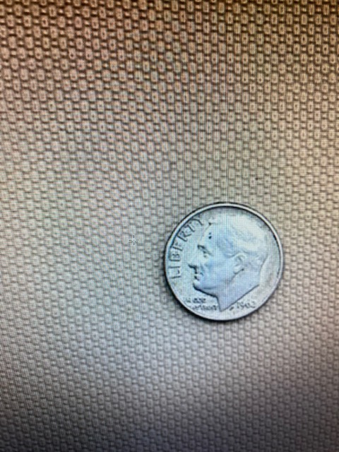

Re your question about the hardtop's originality, I can't say much based on these photos except that the closeup shots of the headliner patterning reveal that the headliner is not original. (Photo below shows an original headliner's patterning (though the photo quality is poor and the color is off).) But the headliner's color seems like a good approximation of an original, and the top as a whole looks nice.
