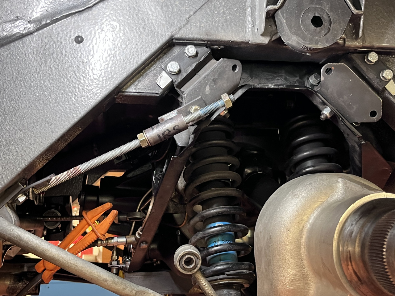

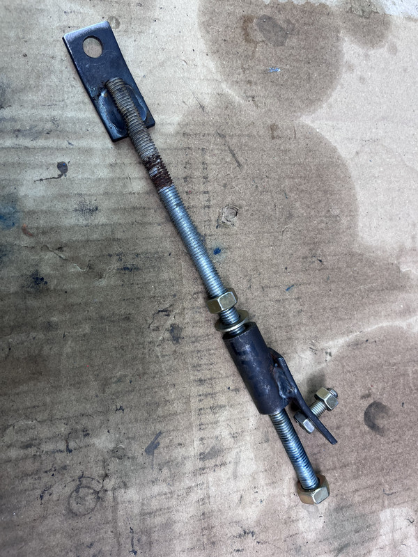

As I had the IRS out, and back in, over this last few days, I was prompted to stick a couple of pictures up of my most under-rated tool.
The first one was sent to a Forum contributor, who loved it, and it then went to Julian Barratt's desk, where it sank without trace.
So I made another one.
I hear it's no good for S3 but it is truly brilliant for S1 and S2, as a controlled means of approaching the pesky IRS mounting-rubbers so their mounting holes line up.
Ought to be self-explanatory, but if anyone wants help with dimensions then just shout out.
