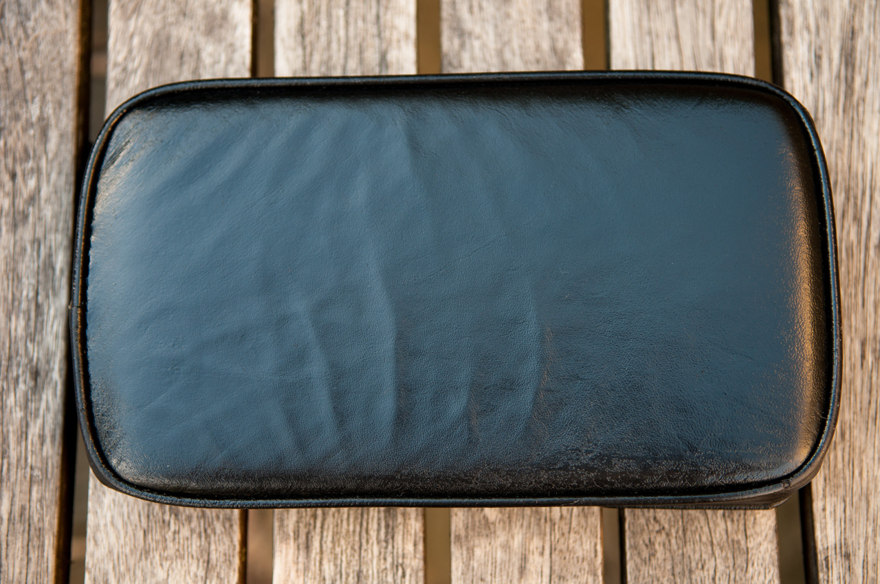

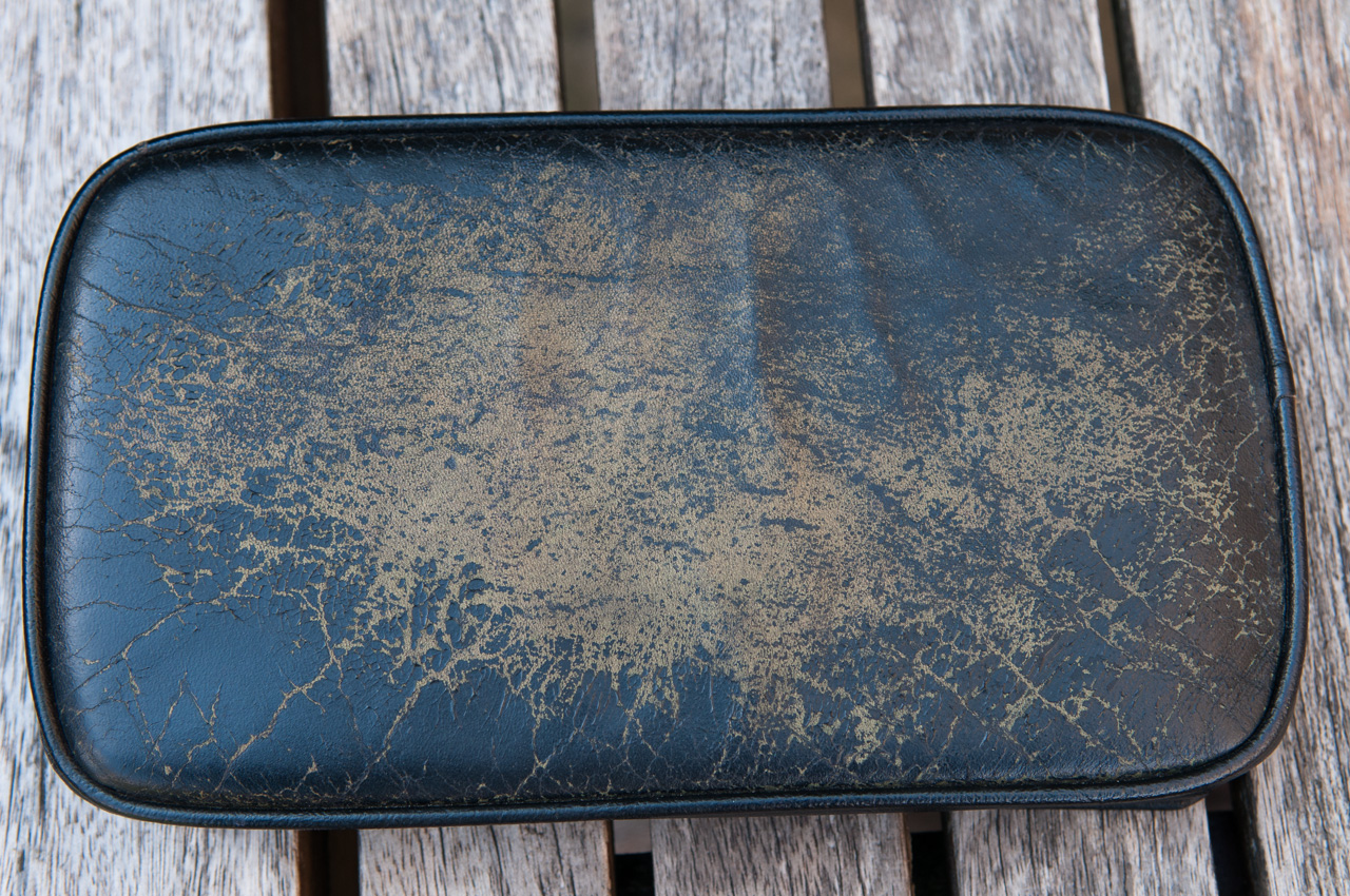

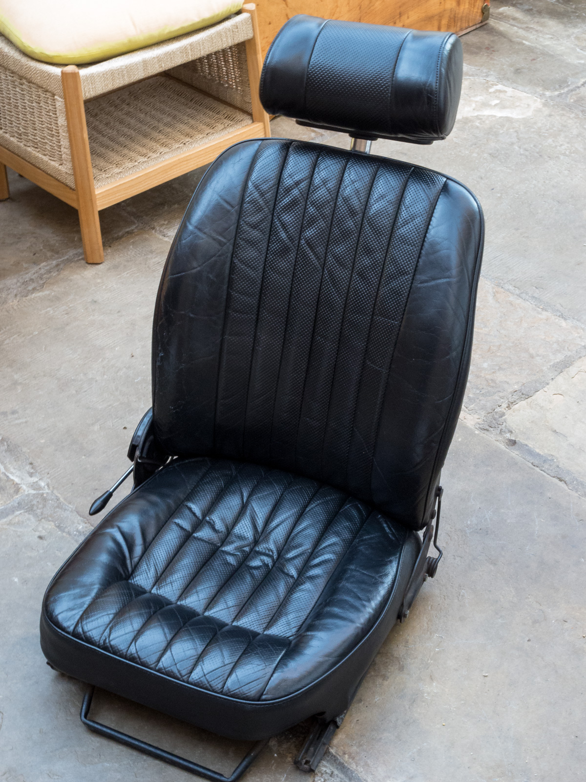

Post by Sjmmarsh » Sun Sep 27, 2015 1:50 pm
Here are the before and after results using the Furniture Clinic recolour set on the central armrest.
Before
After
I am pretty pleased with the result! The front seats are next.

Post by osgii » Sun Sep 27, 2015 6:01 pm
Impressive!

Post by David Oslo » Mon Sep 28, 2015 9:26 am
Wow ! They should use those pictures in the advertising / website !

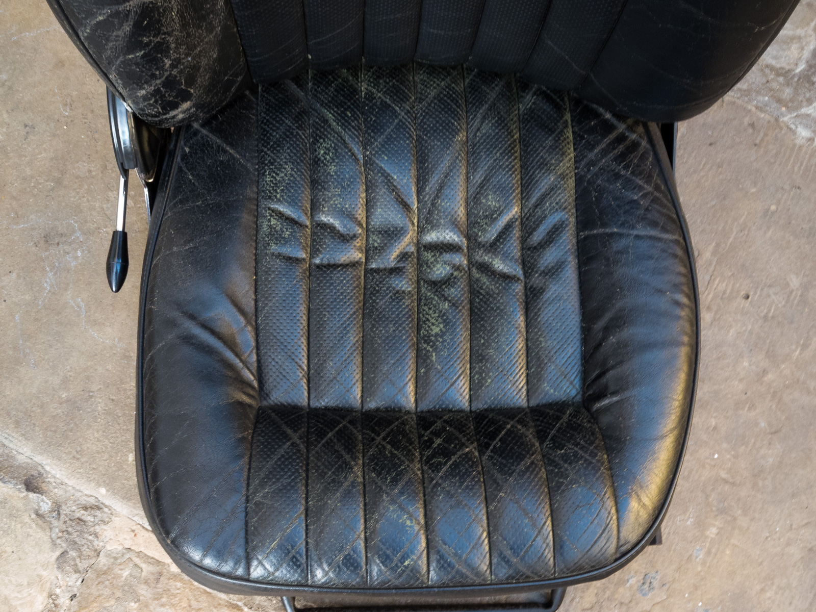

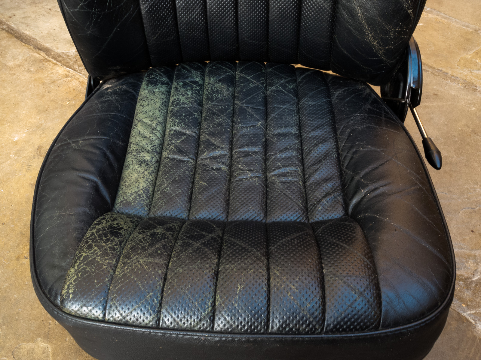

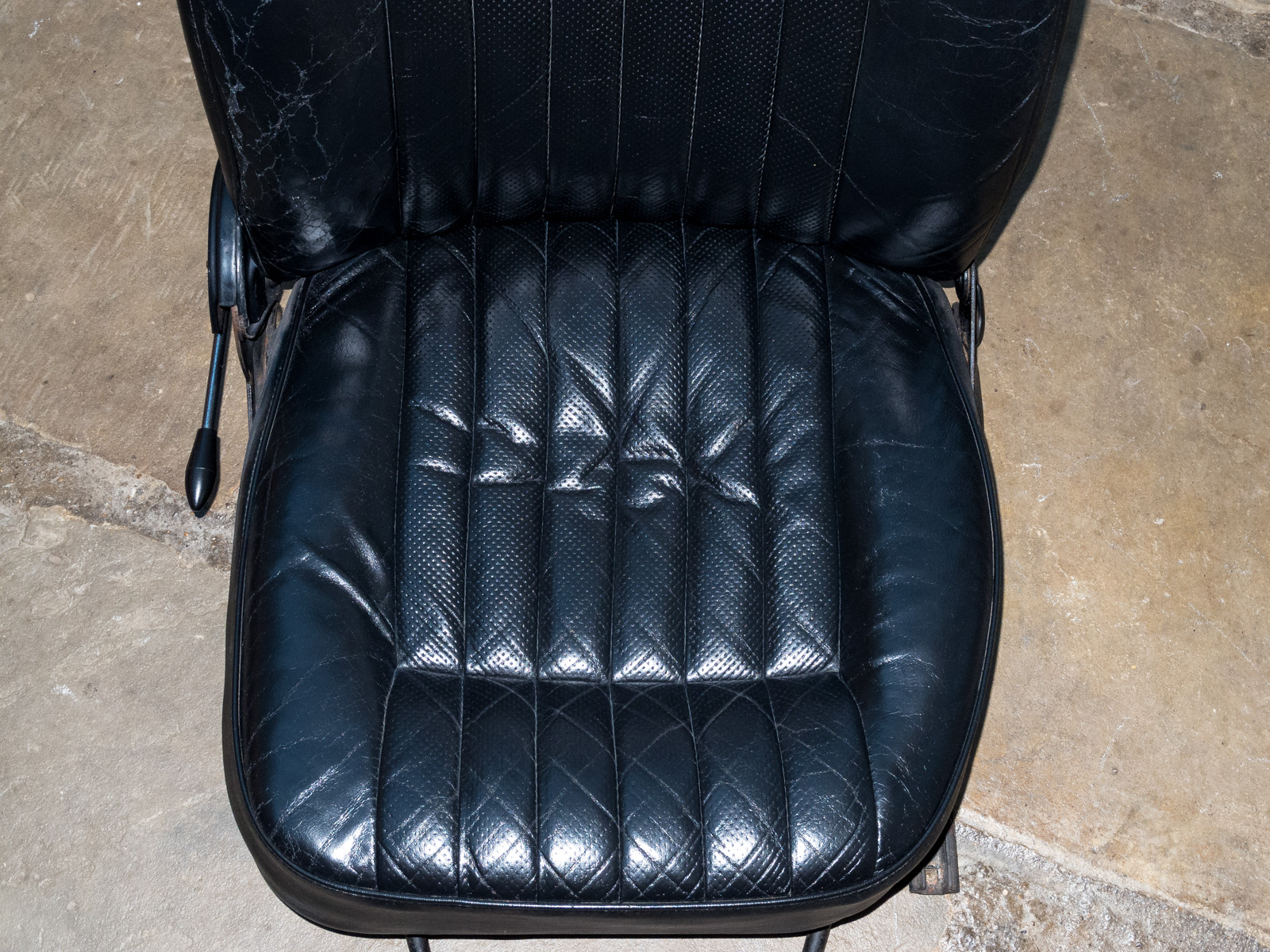

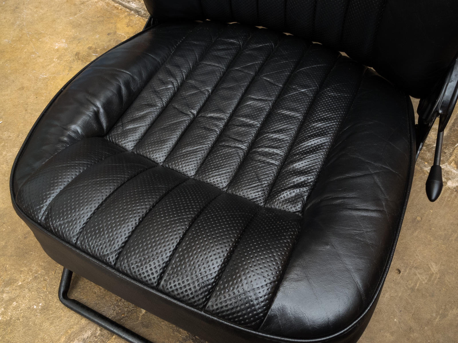

Post by Sjmmarsh » Sat Feb 20, 2016 5:18 pm
I've done the seats now - all looking much better than they did before!

Post by ALAN COCHRANE » Sat Feb 20, 2016 6:29 pm
Very impressive results indeed. What finish did you opt for- matt, satin......?

Post by nefematic » Sat Feb 20, 2016 6:38 pm
Great look. I like that a lot better than new leather.

Post by Sjmmarsh » Sat Feb 20, 2016 11:53 pm
Alan - I used semi gloss. Not quite as shiny as full gloss, and seemed to match the less worn areas quite well.
Nefematic- I agree. As the rest of the car is still original, having seats with someone patina seems to work well.
