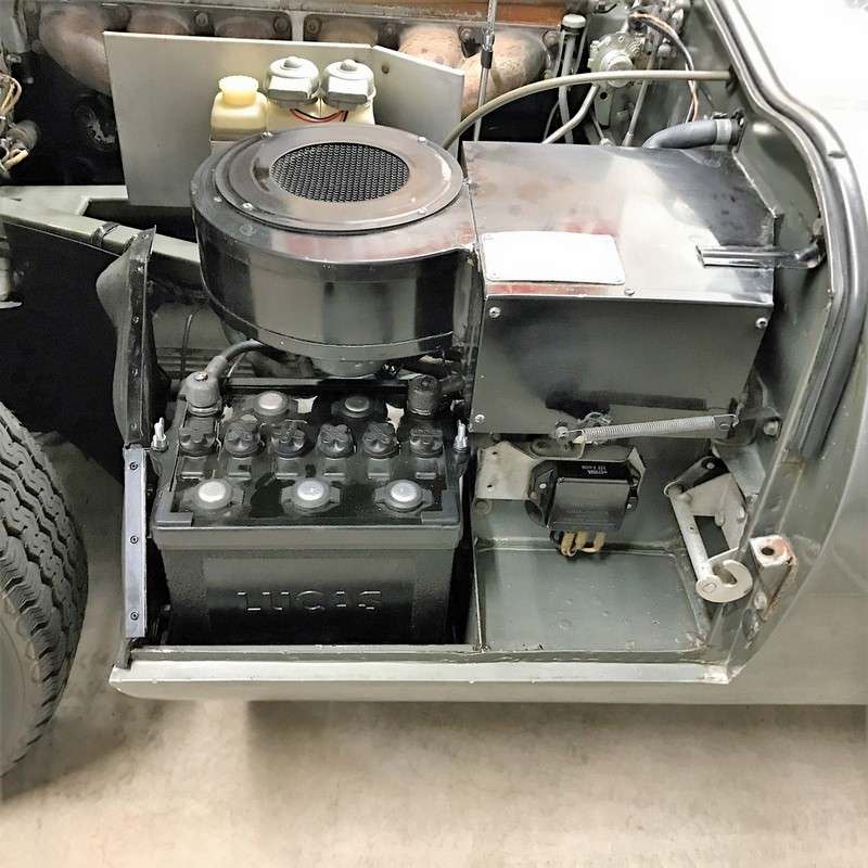

Posts: 9146
#26 Re: New battery recommendation
Post by mgcjag » Wed Jan 29, 2020 4:05 pm
Hi malc...you mentioned that the terminals were the wrong way around....do you want you terminals outside or inside like this S1.....NOTE the posts may look the same size but they are different...Steve
069 fitted

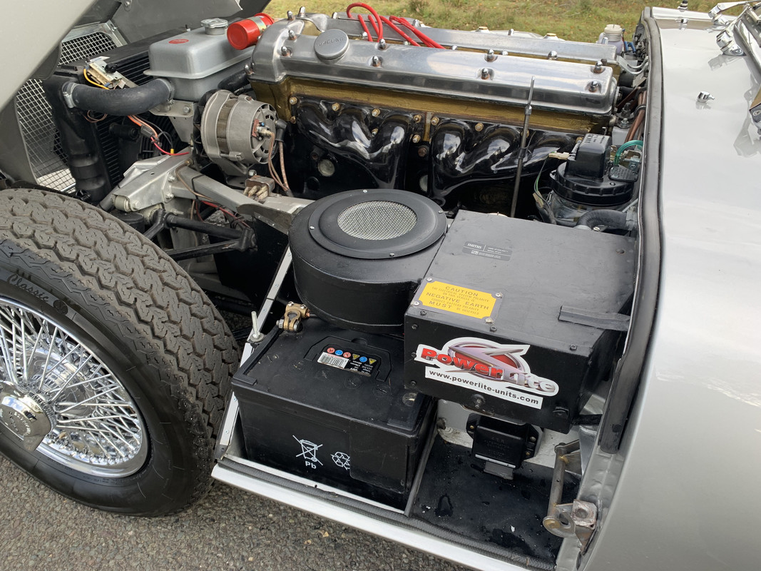

#27 Re: New battery recommendation
Post by Malc » Wed Jan 29, 2020 5:45 pm
Hi Steve - this is a picture of mine. As the positive lead is short, I was going to keep it that way round.

Posts: 9146
#28 Re: New battery recommendation
Post by mgcjag » Thu Jan 30, 2020 9:15 am
Hi Malc...you photo,s not showing unless i click on the link....so your current battery has posts to the outside...would have thought that even if you get a battery with the correct irientation inboard your connections would still reach....so you have more options....Steve

#29 Re: New battery recommendation
Post by Malc » Thu Jan 30, 2020 12:58 pm
Steve - sorry about the pic, but at least you could see it. Good point re the orientation! I hadn’t thought of that although I think I’ll stick to the terminals on the outside, for ease of installation and attaching a conditioner if nothing else (and less risk of shorting).. I’ve found a black Exide battery, 640CCA and 64AH from Tanya Batteries which should fit the bill. Great website BTW, put in your measurements and other technical requirements and they come up with a list of batteries that suit. And very reasonable prices with next day delivery. Thanks for your help.
