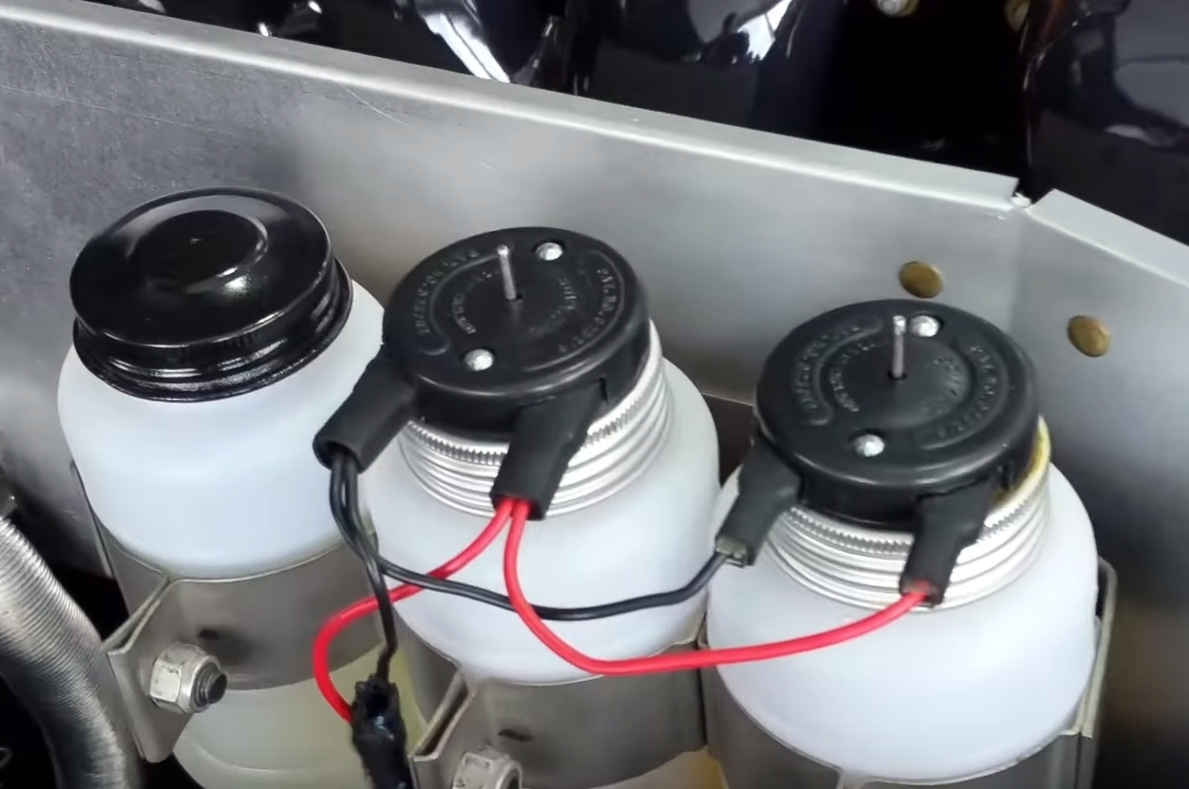

There is a video tour of this car at the auction house available here:
We were curious as to what brake bottle caps were fitted - I said they should have been NIVOCODE or early Sovy - but it turns out they are reproduction Sovy ones with the patent number imprint:

And the red wire should be red with a green trace I believe
#28 Re: OBL = $565k
Well spotted!

Spinners and mirror is an easy catch; I would not bother about it. You get this all the time. But original Solvy (Nivocode were exchanged already against Solvy black senders) is very difficult (original Nivocodes are easier to find) and what I would have hoped to see is at least a Flatfloor bonnet transferred to OBL. But the mouth on this one seems by far too big. Nevertheless again; if I had the money, I would have offered more....
