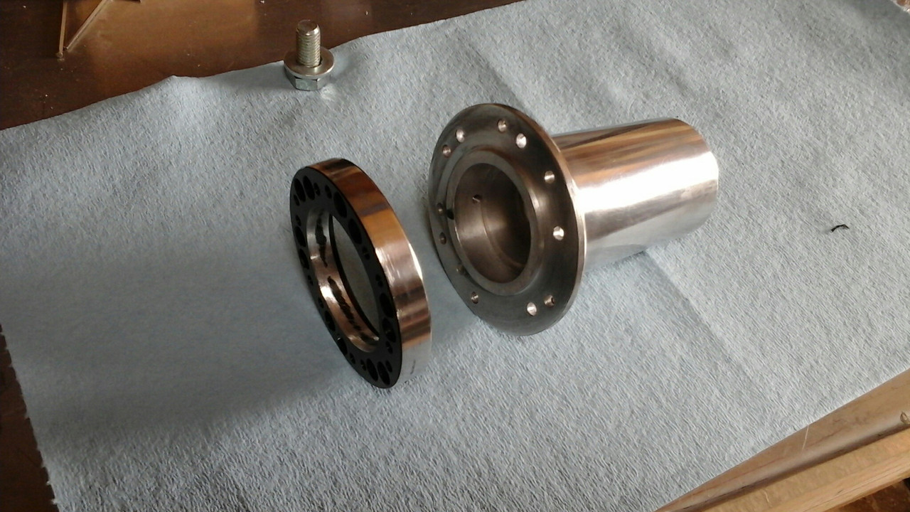

Steve, to fit the NRG adapter what adaptation did you actually have to do ? You mention filing etc - is the result "elegant" or not ?! Am I right in thinking that the original Jaguar mounting system between the steering column and the alloy "tube" I can see behind the steering wheel is left in place, and that the QR assembly and the adapter ring you mention are then "added" in-between the alloy tube and the actual steering wheel ? Much obliged. R

#28 Re: Removable steering wheel
Hi Rory.....yes the quick release and the adaptor ring fit between the steering wheel and the original hub (alloy tube).....the exact parts i used are listed a few posts back (NRG quick release and adaptor ring).....the ring is aluminium with a black coating, i sanded off the outside rim coating and polished it.....the inside i filled just a tiny bit off so the quick release fitted right in without catching (about 1mm off the inner edge).... also re drill the hub and steering wheel..also the lip on tne hub that fits into tbe center hole of the steering wheel has to be redeced in height by fileing off about 2mm....if you want any more photos pm your email and will send them

Hi Rory.....when i refer to the hub, im talking about the aliminium cylinder that on an E type is rivited to the steering wheel, this hub then fits on the splines of the steering shaft and bolted on......if a replacement steering wheel has ever been fitted then the rivets are normaly drilled out and replaced with nuts and bolts, however new rivets could have been used.....the quick release i used fits between this hub and steering wheel....i did not tap the holes....the whole job took about 1 hour so no major work....
This is the hub with the adaptor ring fitted....the outside has the black coating polished off and you can see the small amount of filing required on the inside(if you look close some of the black did not need filing of)...the adaptor has many holes which do not match up with the existing holes in the hub....so i drilled 6 new holes on the hub...the bolts fit into recessed holes in the ring and nuts fitted on the rear.....the quick release comes apart, one half bolts straight on the adaptor which has threaded holes......the other half fits to the wheel, but you need to drill the holes in the wheel to line up with it........hope this helps........if you look back at the other photos i posted all should become clear........however please post back if you have any more questions
