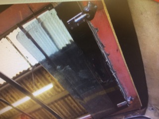

by nefematic
Would this be the Webasto roof with the wooden frame. Ran across an ad his morning claiming this to be for E-Type. The handle is engraved with Monte Carlo.
#14 Re: Sun Roof
Posted: Sun Jan 29, 2017 10:33 am
by malcolm
Handle looks the like the same mechanism as on my Webasto, although I don't have the words "Monte Carlo" on mine.
#15 Re: Sun Roof
Posted: Sun Jan 29, 2017 3:44 pm
by Simon P
Different from mine: my handle hangs down rather than being recessed like that.
#16 Re: Sun Roof
Posted: Sun Jan 29, 2017 6:36 pm
by JagWaugh
The "Monte Carlo" was a style of roof, they came in different sizes, but the fittings are for the most part the same. The new folding roof I have is a "Monte Carlo", the handle is stainless, and recessed, as in the pics above, but I don't think the handle is engraved (I'll have to have a look at that the next time I'm at my storage area.

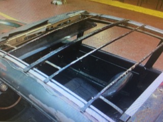

by nefematic
OK just one more here. Another post on the forum about an auction car, happens to have the the larger sun roof:
viewtopic.php?f=2&t=10113
Pictures here for archival purposes:
If you want/need better res pics go to the link and download there as long as they are still available there.
