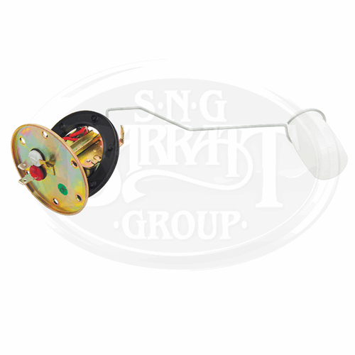

I bought the sender at the same time as the new fuel tank, from sng. It is this one:
As the gauge is the only ‘old’ item in the chain I thought I’d test it first. With the temp gauge you can put a specific voltage through it and see if the 3 test dot marks are in line with the needle. It may be the same for the fuel as I think it’s the same unit, with different face. I might try this if I can find the test voltages info.

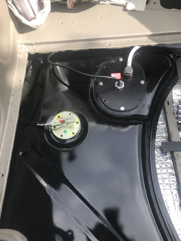

I’ve done a bit more testing, based on the fact that after filling up, the gauge read full but after 30 miles it was on half full.
1. Swapped out solid state vr for original and added extra earth connection to it and gauge just in case. Still read half full.
2. Added extra earth to sender. Still read half full.
3. Swapped sender connection from fuel to temp gauge (new) and still read half full.
So, it seems like the new sender is at fault. I was wondering if I had orientated it incorrectly in the tank. I used the sng parts diagram which suggests the float/arm should be pointing towards the rear of the car. Correct?
I know you can’t see the float in the pic, but their diag had the red & white connections at 12’clock as you look from the back of the car.
I tested the low fuel warning (earthed the wire) and that works ok.
So I guess I’ll get another and test it outside the tank first to see what happens.

#17 Re: Replacement fuel gauges - different case spec?
It was always going to be the sender, as the gauges are all quite similar bar the faceplate.
It sounds to me like the SNGB sender can be improved in two ways. Firstly, if the pivot of the sender float has less freeplay, then there is less scope for it to move in anything other than one plane (so the float can't easily move to an erroneous height as fuel level changes) and can be tightened to have its movement dampened - there is no need for it to move any faster than the bimetallic strip/needle in the gauge can move. Secondly, the arm of the sender needs to be reasonably rigid also, otherwise it'll wag the pivot loose.
If I were SNGB, I'd also check where it actually pivots to when in the tank and if that corresponds to 240-40 ohms (if that is the right spec) empty to full, since you've implied it had too high a resistance at half full. If it is the right electrical spec, then the default amount of bend in the float arm (versus the wiper) is set incorrectly
