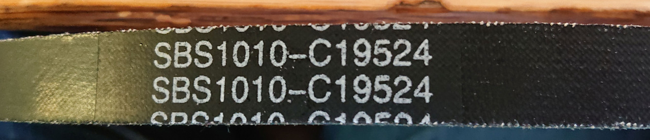

Post by ysmalkie » Sat Jun 06, 2020 4:34 pm
Julian,
I know this is not the proper way to measure the belt, but I think it comes out longest in this way:
So the belt is at most 989mm (it's probably about 6-7mm less, as it should be measured in the centre, I believe)
The label says 1010mm.
The 25-28mm is exactly what we are missing....
Tadek

Post by JulianBarratt » Tue Jun 09, 2020 7:50 am
Morning All,
Fanbelt update for the 3.8 cars.
We currently have 2 different suppliers on this and have used both based on availability in recent times.
One of these has provided some stock recently that is slightly too short - not as short as 990mm by our measurement but too tight to fit.
We have removed this supplier from this list and will be checking in with any potentially affected customers from recent supply to enusre they have one that fits. Unfortunately its going to be a week or so until all our stock is right so we have stopped sales for now.
Tadek - thanks for your help and we will be in touch shortly.

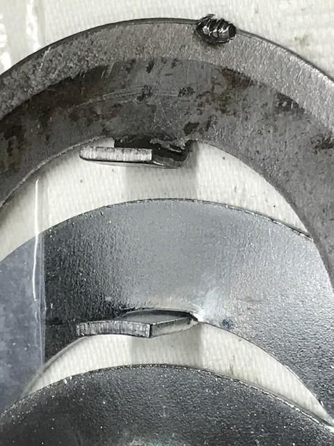

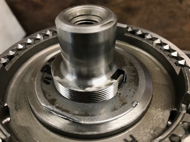

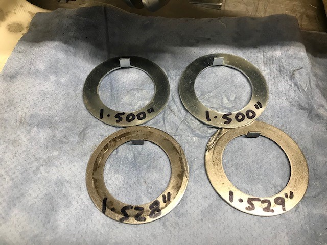

Post by 288gto » Thu Jun 11, 2020 2:00 pm
Morning All,
We currently have 2 different suppliers .......
One of these has provided some stock recently that is slightly too short.
Julian
I know from conversations with Julian and his team how frustrating the whole issue of simple dimensions can be for them and how hard it is to check every item that comes into stock. I daren't think how many items they carry in stock and supply worldwide with sales in excess of £20 million. :yellow:
At least in the case of a fan belt it is a non safety critical item.
When I received some suspension components that were the wrong size and material Julian made a point of personally looking into it. Likewise propshaft bolts that were the wrong tensile strength and specification.
Also a brake part that was machined at a slight angle and oversize. All were looked into, a prompt response received and a full refund given.
The headlamp dip bezel that was too thick and the lettering flaking off. An inexpensive item that they probably don’t sell many of but Julian asked me to send an original one to them to see if theirs could be improved.
I think there is currently another thread about the leaking reservoir bottles, again I know from personal experience that Julian and his team have gone to great lengths to look into this.
From a batch of quick release steering wheel bosses with loose fitting splines to a simple bulkhead gasket of the wrong spec all chased up with the manufacturer.
Keep up the great work Julian.
Did you ever find out why the rear fulcrum shaft spacers had ended up 10mm too short by the way?

Post by JulianBarratt » Thu Jun 11, 2020 2:16 pm
Thanks for both of these bits of feedback - we are planning some investigation work on the senders tomorrow so i will report in. As it happens, the temperature reading on my own road/race E-type didnt leave zero on my drive to work yesterday so its an opportune time!
With regards to the headlamp dip bezel - we did indeed start from scratch on this and we are pleased with the results:
https://www.sngbarratt.com/English/#/UK ... 0c20305%60
Simon, if we had your sample, please let me know if we didnt give you a freebie of the new one.
Yes, there are always challenges and its very often the low volume/high mix nature of what we do that adds to these but we will keep working on them and its associations with environments such as this forum that, while occasionally slightly bruising from our side, keeps us on our toes and in touch with the drivers of the cars we service so its always appreciated.

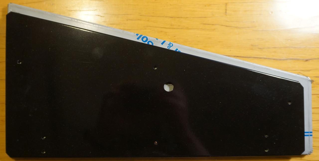

While assembling my e-type and attempting to use SNG parts I came across the following that SNG could perhaps fix....:
BD20436 front exhaust shield assembly, early, for rubber mounted gearbox
Despite the fact that in general making it bigger might be better it is definitely not the case here. It simply does not fit.
Please see the comparison of one I made according to original dimensions (mine is the black one) and the one you sell:
The heat shields were black, originally btw.
BD25237 front exhaust shield assembly, late, for spring mounted gearbox is exactly the same as the one you provide, just the mount is in a different place.
Again, it will not fit until you reposition the mount. They really are not exchangeable, like the SNG website suggests.

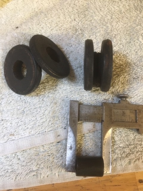

C8975 Rubber Mounting Pad, for Radiator block & expansion tank
Too think.
The pads were originally about 1/4", the ones you sell are 0.33"
All together when compressed on the C18283 distance collar the mount is firm as steel (not rubber , like it's supposed to be).
Yours:
Original (courtesy of Ian):
C19846 Rubber Pad, at Petrol Tank Mountings
You either sell the C8975 of shock absorber rubber.
None of them fit - one has the inner diameter different the other is too thin.
Originals look like this:

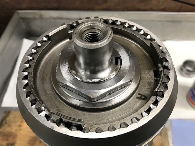

Julian,
The Gearbox mainshaft tab washer C21618 from SNG unfortunately is not correct and does not fit.
The bore of the sng washer is 1.500"-- the original being 1.529".
The tab is bent in the wrong position--it has to clear the root diameter of the thread when fitted to allow the nut to pass. Notice also the small radius at the bend of the tab ---to avoid stress cracks.
Annoying for such a simple part ---no charge for the R&d :smile:
