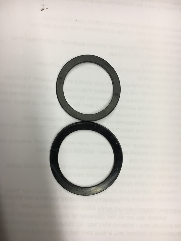

I went to start it up tonight, switched the ignition on and waited for fuel to get to the carbs before I turned it over, unusually it didn’t start. I switched off then back on, listening to the pump whirl I could hear heavy dripping. Fuel was being dumped on my garage floor.
The new rubber seal that came with the new fuel filter has been effected by petrol, it has got larger and gone out of shape. I fitted another one from the same supplier that I had but am no confident with it. The failed one has only been in just over 2 months.

The fuel filter glass bowl seals along with other parts turned up from Barratts today.
I replaced the seal that I only fitted on Thursday night, it has already grown in size in that short time.
Hopefully the barratt ones will be of better quality!!!!
