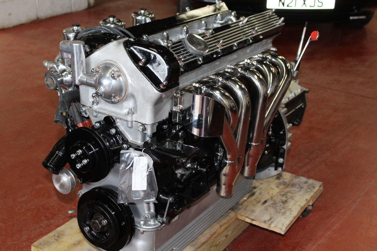

Picked this lump up at the weekend. Delighted.
Long Easter weekend to drop it back in. Happy days.

Looks stunning! There are few things prettier than a fresh XK motor.
Of course its a double high because youve still to hear her fire up!

It is a thing of beauty. Are we allowed to know who did the rebuild? :bigrin:

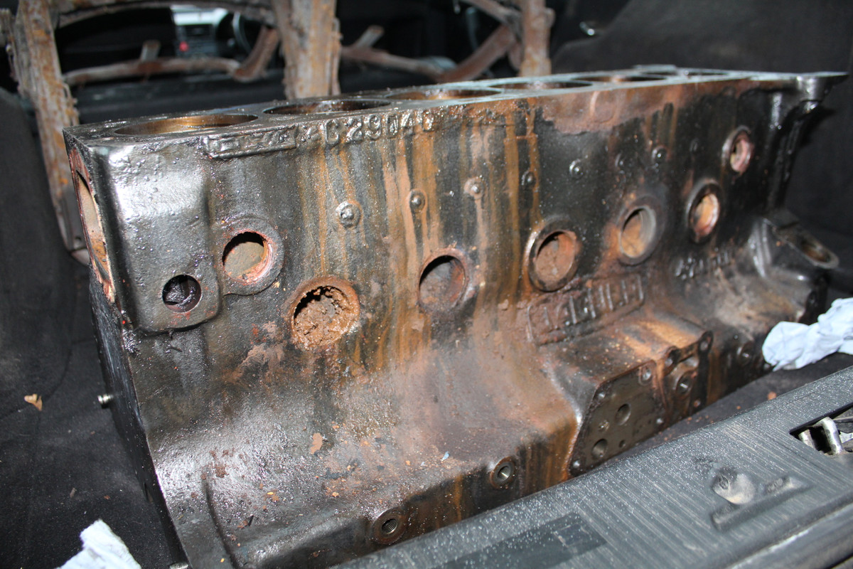

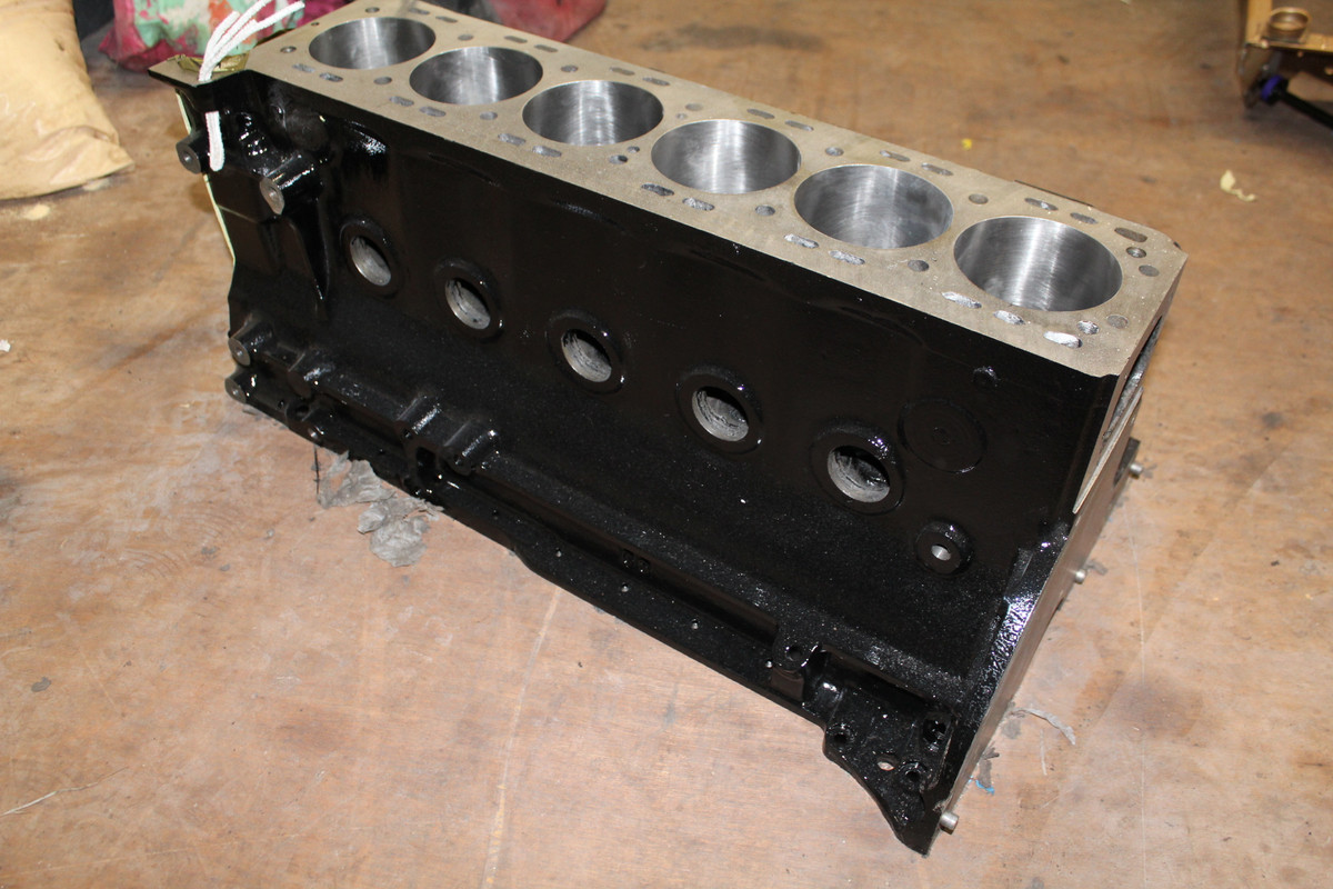

The engine was in a much bigger mess than I realised so it was a timely rebuild. It was originally booked in due to a major oil leak at the infamous crank seal but on investigation the water channels were completely clogged and there was a crack in the block that required stitch welding. Head gasket was failing to. So the engine was on its way towards a catastrophic failure I reckon.
Interesting though. We did 1,000 miles on the coastal tour and the car never missed a beat. Performant, temperature always steady and lovely to drive. They are very forgiving engines.
