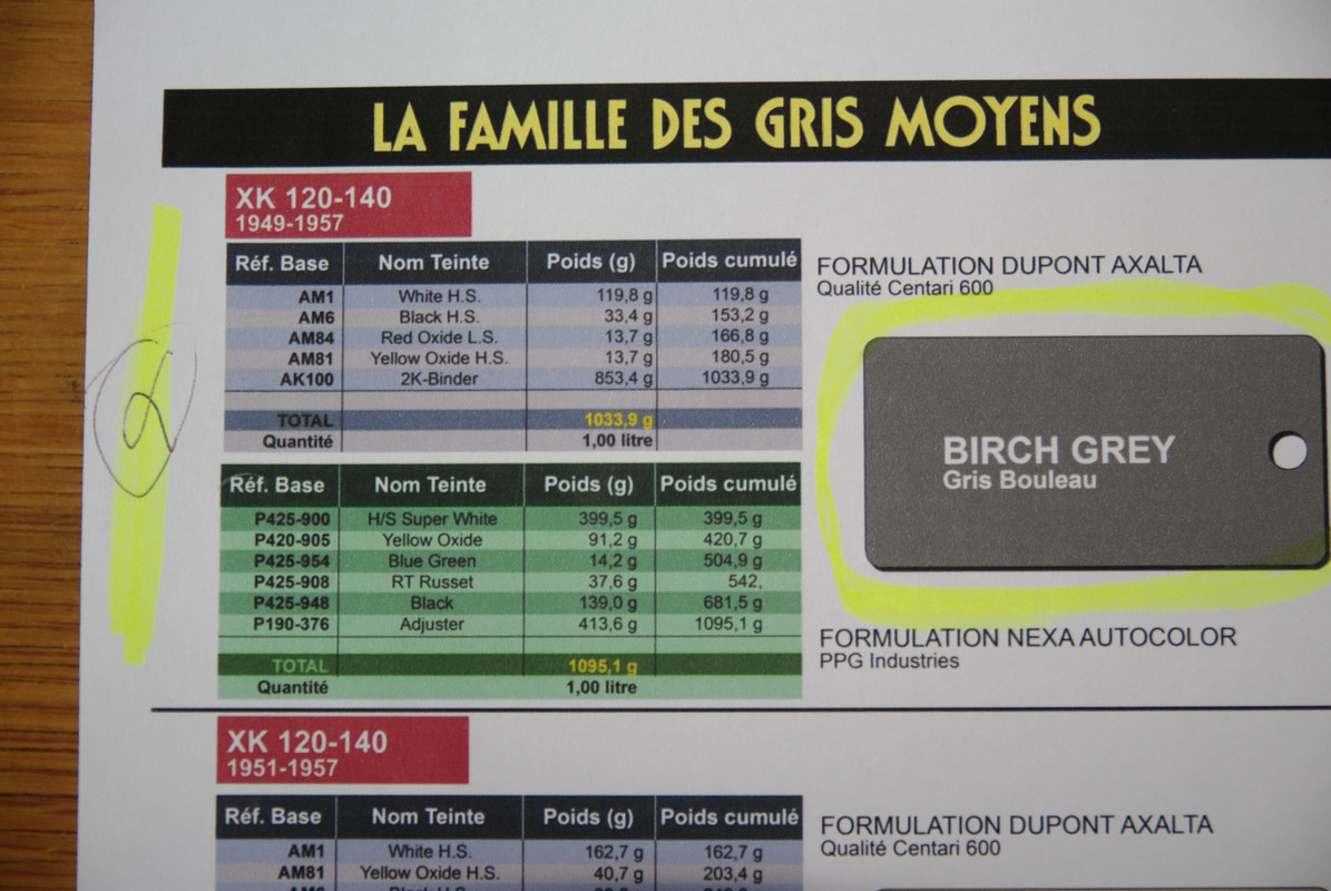

Next to the E i am working on a XK 140 (nuts and bolts restoration ....!) and my question is about the BIRCH GREY color that i want to keep as it was its birth color !
I have the original chemistry formulation By " DUPONT" AXALTA or PPG NEXA AUTOCOLOR but no one around here can indicate the present formulation !
May be someone here can ?

Yves : those are definitely not the original formulations, as the Dupont is clearly for a 2 pack paint, and I suspect the PPG is also with its "adjuster" added. For a 140 what you need is the original cellulose formulation as Jaguar had gone over ( about 1951 as I recall ) to cellulose from enamel well before the introduction of the 140

Thank's Tadek i have found the actual reference:
from AXALTA , CHROMAX Centori 6000 , birch grey or gris Birch
