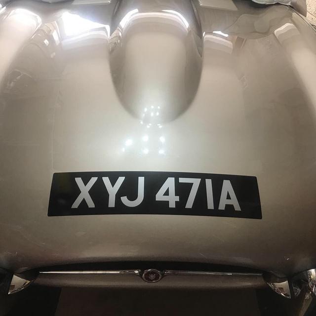

The question about the E-Type front number plate has been circulating for years. The JDC asked the DVLA for a definitive statement on the subject and they did get back with a definitive reply. Can't find the article but basically the DVLA think the E-Type was given dispensation in 1961 to display the number plate on the bonnet and "custom and practice" means it can continue to do so providing the colours and fonts comply with the appropriate legislation. They also say the only reason this has been queried in recent times was because of the increased use of ANPR and speed cameras by Police. The E-Type number plate is considered visible by these systems so no action will be taken.

Depending on the year of your car you need raised characters in period font on the rear (try Tippers, ACE Plates, Paul McNaughton or Framton's for ACE style) and for the front you need to ensure you get a period font rather than the computer generated modern font that some supply (yes, you Frampton's!). Tippers will hand cut the characters in the correct font to the correct size depending on car year. The photos above clearly illustrate the different styles of font. Front plate is period correct, rear plate has a modern font.
